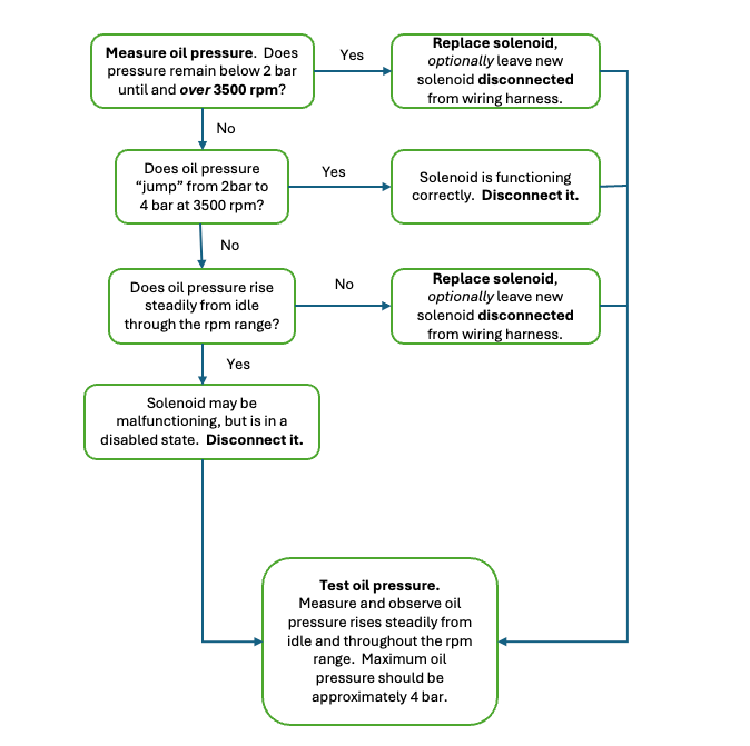

this awesome decision-tree should be pinned!

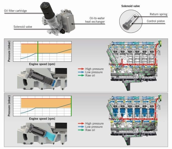

That "Internal" Valve looks accessible
I also found this from one of the PDFs

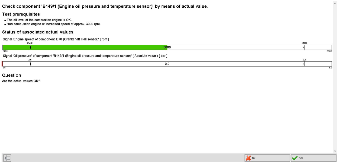

I did find these instructions for measuring oil pressure on the GLS450, but it is all through XENTRY and not physically. That tells me that the M256 has an oil pressure sensor.
File Type: pdf

What is crazy is that the MAXIMUM oil pressure for the M256 at 3000 rpm is 1.7 bar (or 25 psi), about half of what you want to see in the M276, etc. I definitely would not be disconnecting any controls without first understanding what is going on.

I tried finding the procedure using XENTRY Simulation and could not. I assume it would be a test procedure under the N3/10 ECU.

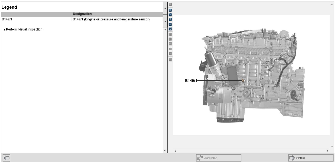

Apparently, the M256 has a combined oil pressure and temperature sensor (B149/1). I found the procedures for testing the oil pressure using XENTRY. In XENTRY, however, engine oil pressures can approach 4 bar. I will attach the initial procedures next.

What is interesting is that the images overlay both high/low pressure channels.
It might just be enough to tap a physical gauge into that spot and see what solenoid does near the filter (Before/After). Hopefully the car does not go into a strange limp situation with no pressure detected at the sensor. Did it show only XENTRY as the method for testing?
Note the blue arrows get larger and shows what looks like a blue piston cooling mist above the red arrows? I have a feeling that pressure sensor is just for the high pressure channel.
Good research!
Great discovery, this enables us to discover more about the changes MB made to the modern MB engines.

M256 simple workaround: VISCOSITY bump
Originally Posted by Sargy
Yep, I was just about to mention B149/1
Good research!
This looks like a single pressure valve gating all piston sprayers at once.
Use better viscosity to open it at lower Rpm.
So this setup has no dual-rate pump, right?
Only a squirter control, right?
++++ outcome...
circulating heat out of pistons is going to preserve much needed engine cyl. balance.
Meaning good oiling is going to make your engine run great once pistons rings + ECU maps adapt to it.
Stock setup is going to be laggy weak engine behaving old prematurely.
++++ SOLENOID valve is mechanical only!
the oil control is a basic pintle and spring.
It simply is pressure based without any electrical control by ECU.
It maintains general engine oiling at the expense of dry pistons with stuck leaky rings... amazin'
This ensures no starvation below ~30Psi. When pump volume is too low to supply piston sprayers, the valve shuts off supply.
> WIN-WIN:
To work this valve open, experiment with supplying enough pressure at driving Rpm to keep pistons rings clean without burnt carbon.
