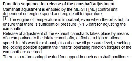

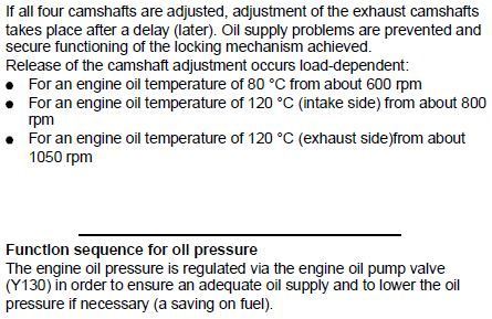

Last year we witnessed Master Surya's excellent data research (right up this thread) showing camshaft positioning messed up by stock setup.
Notice how cam position is supposed to remain staticly unchanged accross Rpm.
Now see what really happens to position...
cam gets bumped out by surges.... LAG!
cam gets bumped out by surges = HOT LEAN LAG
Go ahead and read that post to understand both oil pressure surges are caused by....
- solenoid deactivating
- squirters activating
Now think about ways to prevent that......
Let me ask...
-- Who recalls how the 3000psi HPFP pressure regulation works (prop valve + lobes) ?
-- Who enjoys wild high pressure regulation ??
-- What does poor mixture control do to gas mileage, combustion heat, mapped mixtures, lean lag ???
-- Can the ECU learn stable fuel fixtures when rail pressure is all over ?
Das oil pressure causing "heavy poky chassis" stock experience. Good neutral mixtures are the necessary base of pressure sensitive throttle.
The improved engine response of MOD-1 is from having smooth linear pressure straight up from idle. Only one pressure drop from squirters.
Notice how camshaft position is not supposed to move at all this whole time. The ECU regulates VVT PWM solenoid against varing oil pressure to keep position steady.
At no time oil MOD moves camshaft.
It's helping better than stock position. Nothing too crazy.

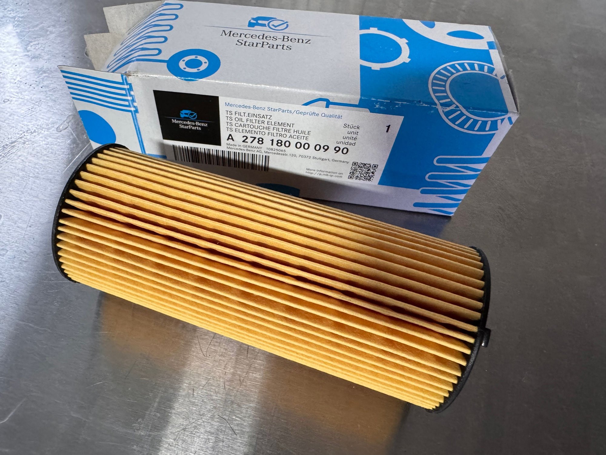

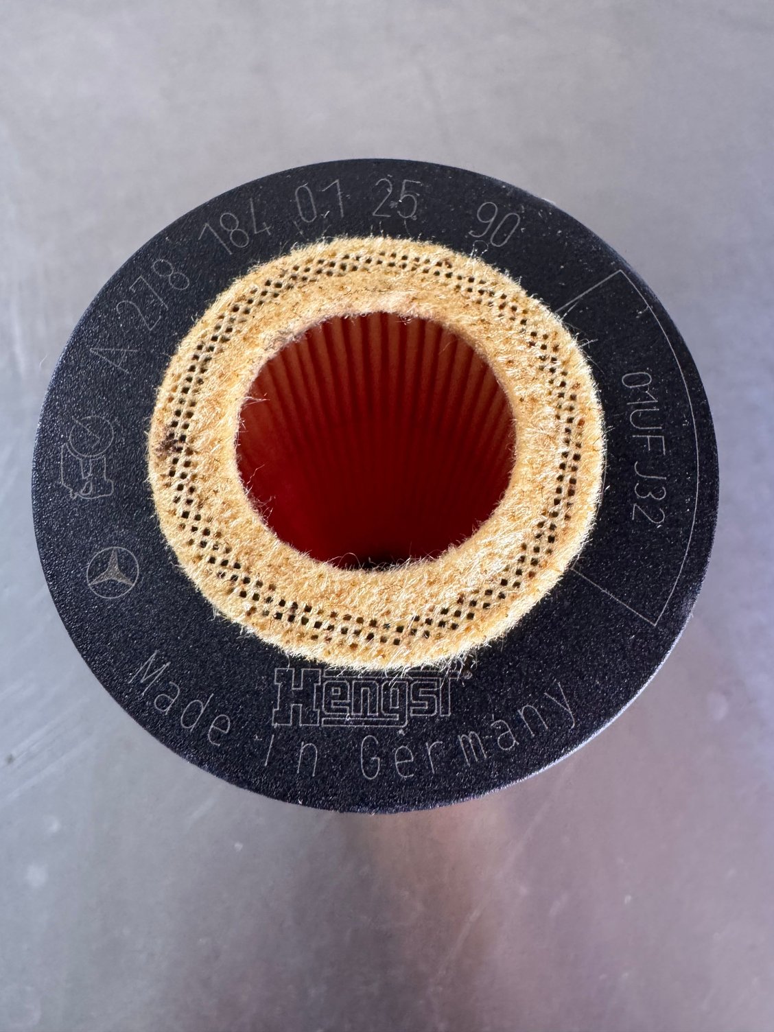

This is what the dealership sells for the 157 engine

As promised.
Some key sections.

Yeah I would pass on the Star parts and just get a Hengst.

yep, that's what it is.

Star Parts are same as Genuine right?

Well it's supplied by Mercedes but is made cheaper than the original OE.
