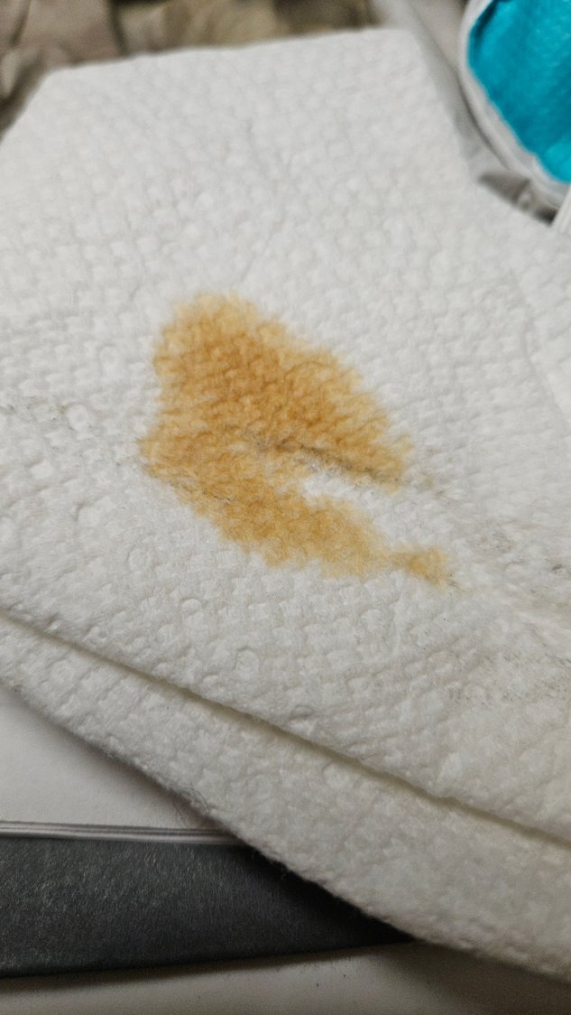

> MOD-4: 5W-50 Report :
Fair color of Motul 5w-50 SP M276-NA
4600. Mi
4,600.Mi
That's a working combination of oil and viscosity.
Practically cleaning and cooling... not burning given an average mix course of City/Hwy around 2,000.Rpm.
I have not heard the regular high pitch hissing after engine stop (Fan:Off) - I think GDI rail / pump are no longer getting heatsoaked.
I have no concern against excellent Motul 5w50... Next is Amsoil's 5w50 sig. experimentation

SUPER CLEAN OLD MOT.5w-50 SP ESTER
I can't believe how clean this oil stayed at 4600.Mi. despite what it's been through already. I've never had an oil like that.
It has lost a bit of viscosity but still has enough to operate squirters effectively without burning at normal 2k.Rpm.
The engine thermal mgt is gradually normalizing itself nicely. Coolant heat can still trigger the fan but uncontrolled heatsoaks are radically gone!
Engine runs cool after 15mn or 2hours: circulated heat is now regulated under control. Traffic jams don't overheat when you start with controlled heat level. Response stays solid, does not get lumpy!
Coolant minimal consumption has stopped
Oil consumption stopped (less half quart at 5k!)
Cool struts are not bouncy
It's a far cry from stock setup surged VVT and guaranteed to chew lock-pins...no rattling necessary.
