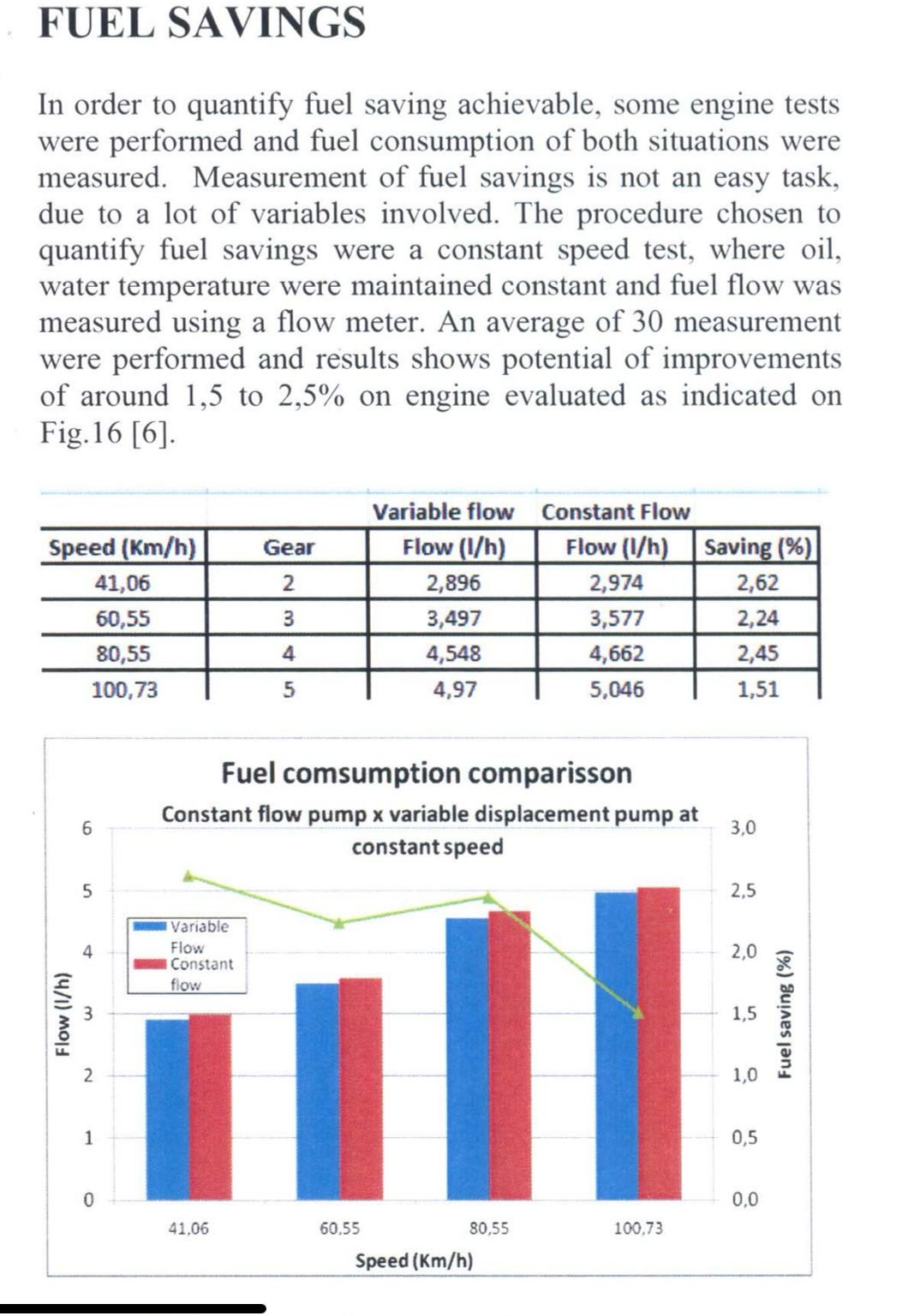

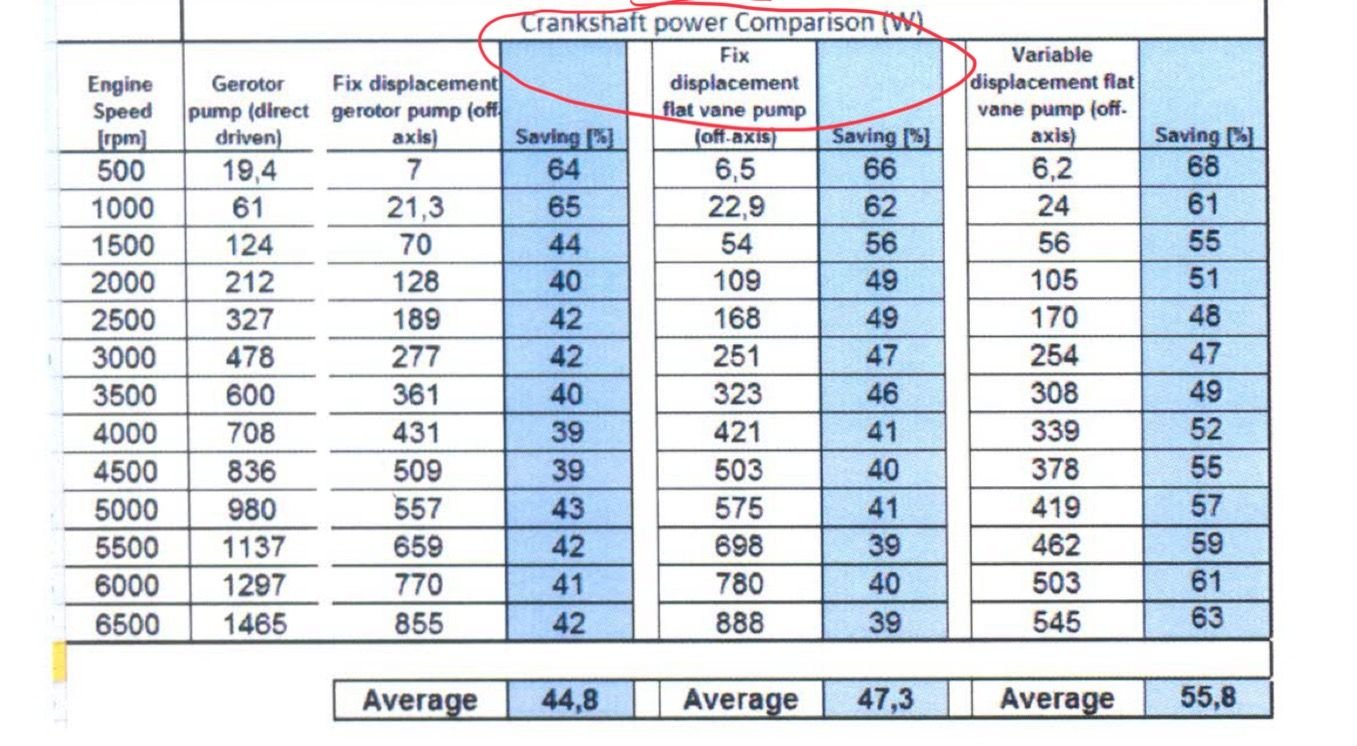

The focus of the paper is entirely on improving pump efficiency to save fuel. It does not speak to improving engine longevity or performance.
I know this mileage thing is always in the forefront of these discussions and seems to carry a stigma here.
Honestly, most of the articles touting mileage efficiency are marketing material….
It’s possible you may be interpreting efficiency as emissions, This paper is focused on efficiency as stated in the summary/conclusion below.
Though related, technically It’s not the same: you can see mileage is not the focus of that study but rather efficiency, mileage happens to be a byproduct.
Not a lot of fuel savings in their findings right? But rather power savings is the focus of this research second pic. 40-60% gains depending on pump configurations. Wow!
It’s important to keep in mind these are research papers that won’t always transfer to real world conditions.
These should be considered a guide NOT religion.

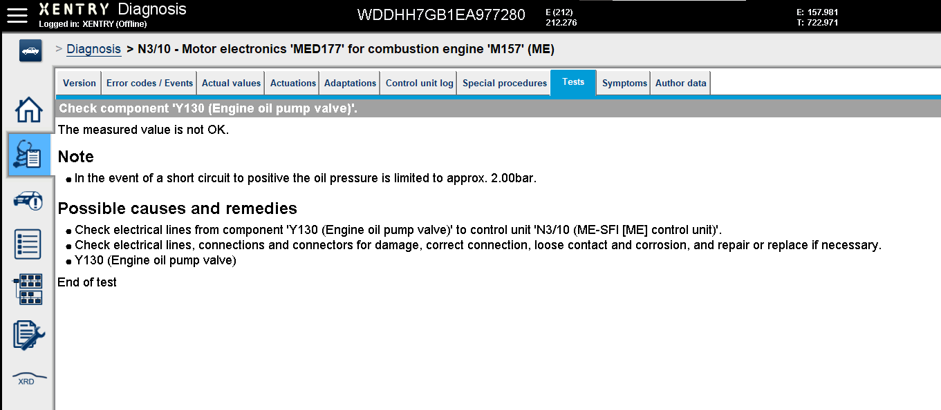

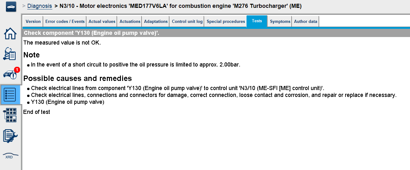

XENTRY Simulation does not show error P06DA00 in the list of faults for the M157 engine. So, I ran my VIN through. XENTRY on shows how to test for the fault -- nothing about repairing or ignoring the Y130 (solenoid).

Actually, the same thing shows up for the M157 using the MED177 ECU.

If you are referring to this table, it is comparing efficiencies between fixed and variable displacement, not flow. Or, are you correlating displacement to flow? And the comparison is between the Gerotor-type pump and the other types of pumps. I'm not sure we can conclude any savings like that because we are remaining constant in the type of oil pump we are using and just changing to amount of oil it's allow to pump. I certanly did not experience 40%-60% gain (or loss) in performance or fuel usage when I disconnected. The paper is an interesting read, but I don't think it applies to what we are doing.
