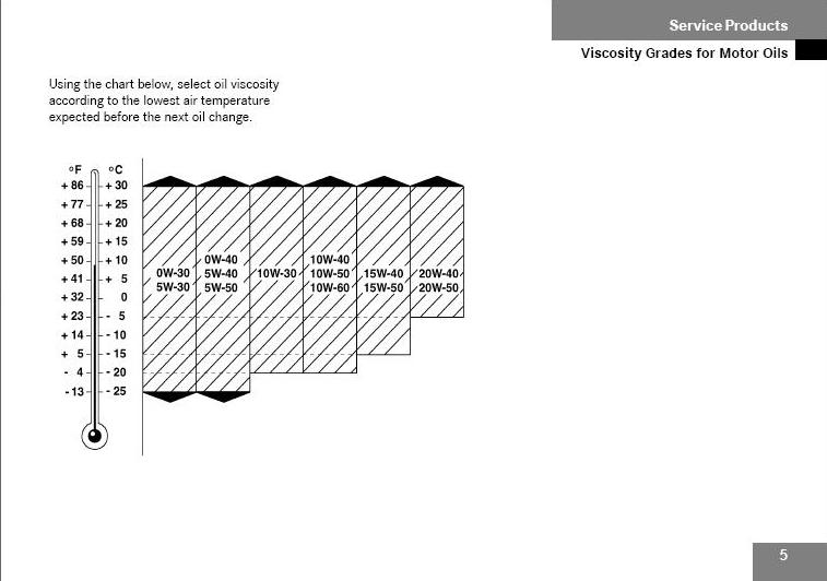

Unfortunately I need to pay attention to cold flow characteristics here in northern Wisconsin.
Yikes. You might want to get something like 0W-40, unless you have a block heater but I doubt that helps enough.

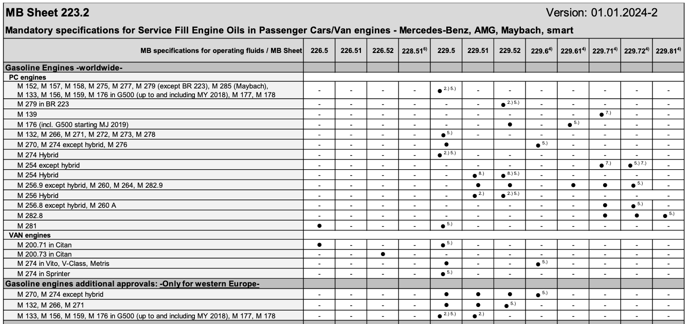

That is not 5W-50 though also one is mb approval 229.51 and the other is 229.5
The two approvals are NOT just a newer version of one or the other. If your engine specifies 229.5, do not use 229.51. 229.51 is not a substitute for 229.5 for your engine.
https://operatingfluids.mercedes-ben...ory/engine-oil
https://operatingfluids.mercedes-benz.com/sheet/223.2

At those temperatures you really want 0W https://mbworld.org/forums/attachmen...sity_chart.jpg
Source of image: https://mbworld.org/forums/mercedes-...osity-oil.html
Thanks for the reminder. Yes I know that : ) I appreciate the chart though. I specifically called it out because I noticed the difference which should had helped with their decision.
in terms of 229.5 and 229.51 (not specified for M157)
thus 229.5 spec being compatible
So the amsoil before would be the one, yes?
not the red bottle signature.
I would say yes to the gray label. As in nature, red usually means danger — no touchy touch.
