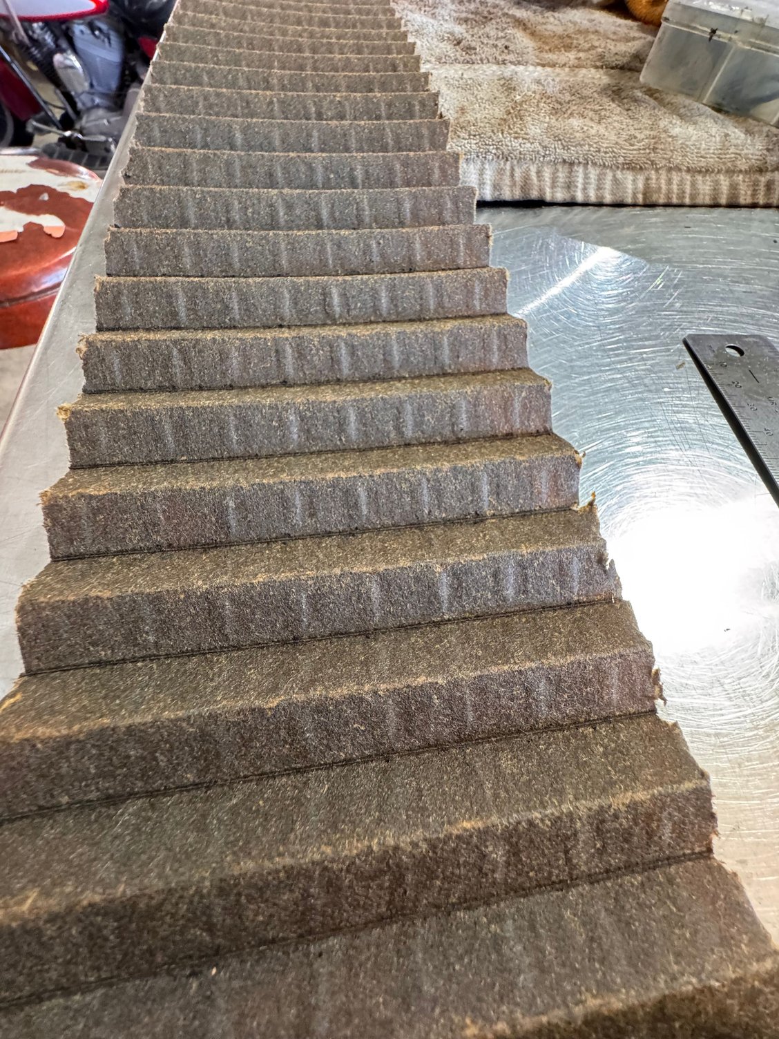

Runs very smooth and quiet with slightly reduced idle RPM. I also experienced the no crank starting.
Nothing shiny in my old filter, just a little bit of carbon in the pleats.

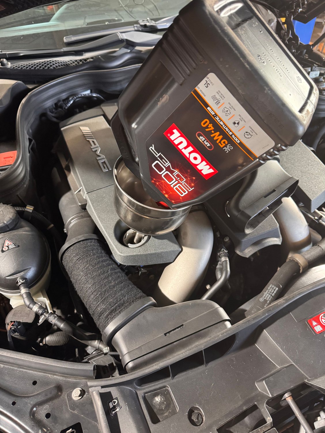

Ok I have 400 mi. on the 5w-50 Motul as well . I noticed slightly reduced idle but just figured I was making it up in My head. I also went back to removing the noise reduction foam under airboxes. I didn't notice any extra noise with hood closed and air intake temps were 15 degrees higher than OAT at all times except slow moving traffic. My car never took more than a second to start before so not sure about crank time.

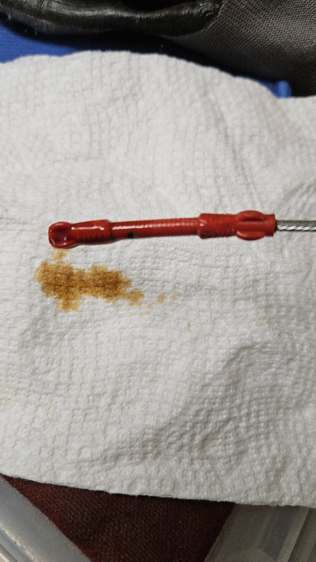

over extended a bit 5800Mi
over extended a bit 5,800.Mi
good looks
good looks, not carbonized : PAO
still clinging well on the stick after 6kMi.

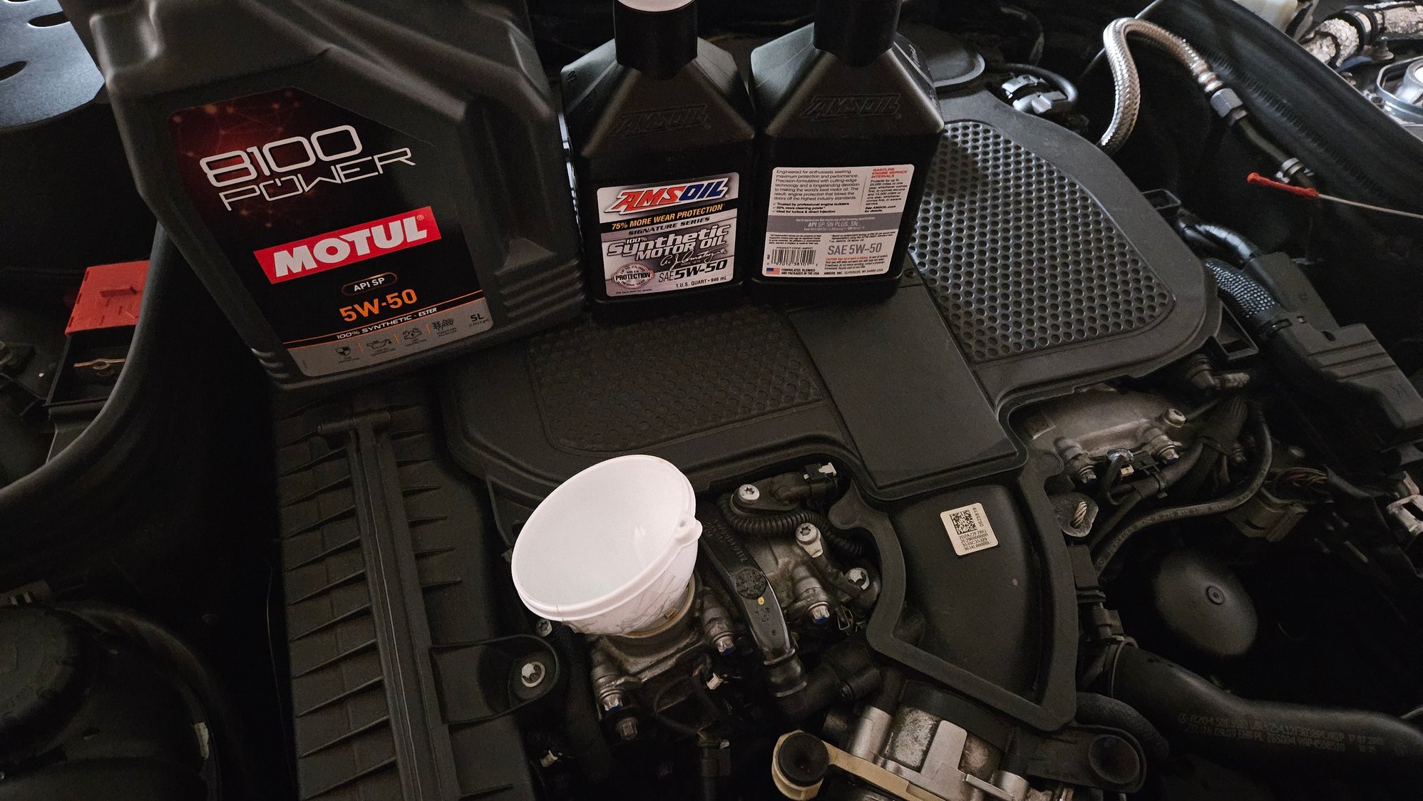

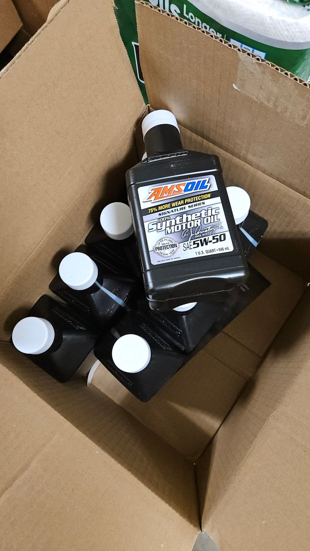

transitioning 5w50 PAO to PAO
transitioning 5w50 : MOTUL PAO to AMSOIL PAO
I ran Motul 5w50-SP for 5,8.kMi straight:
Absolute most stable oil performance. I will happily reuse exact same one next round.
Available viscosity did not age out of spec to mess up VVT mapped positioning.
(No need to blend in experimental booster shots)
> I only have 30Mi on Amsoil 5w50... so far similar to Motul 5w50: stable viscosity enables early stable VVT Mgt without surges.

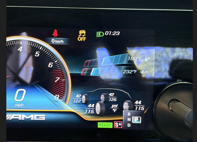

on coming back, I realized there are some threads about the oil temps reaching 230 and 232 even at lower viscosities - but 53-line owners are reporting this at lower viscosities and even in comfort mode in around-town driving. I wonder if something else completely unrelated is just causing the temps (it is like, 85f in southern california right now), or if i shouldn't be expecting this kind of behavior from freeway driving.
need to compare with other M256 engine vehicles to be sure.
it sounded like those situations had to do with comfort mode - the idle there is only 500rpm
