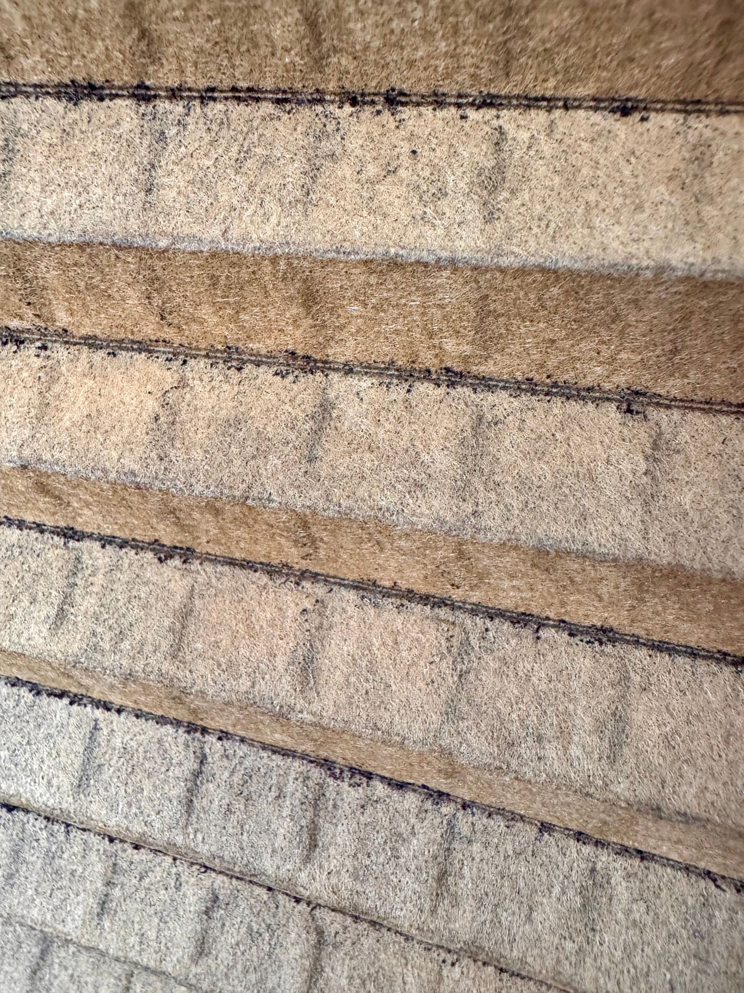

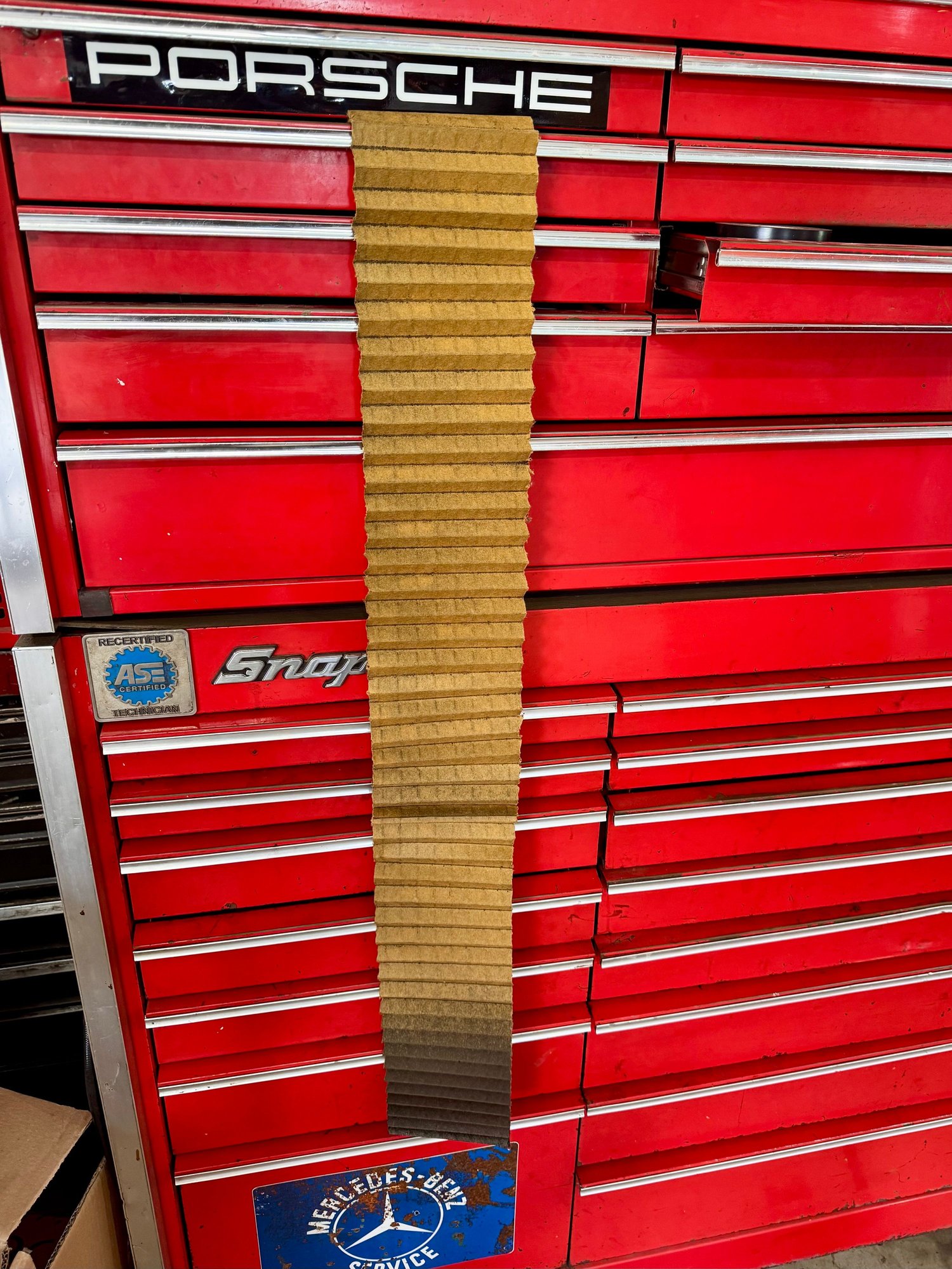

@51north Have you changed out another filter yet? Look the same or has it cleaned up?
Guide material would show up in the filters, so this is a good/easy thing for folks to pay attention to.
Yeah, At least there was no metal…
Originally Posted by 51north
Not sure what this is or if its normal, but at least theres no sparkly stuff in it.
Not sure what this is or if it's normal, but at least there's no sparkly stuff in it.
If you guys cut your oil filters for inspection, try letting one hang over a pan for about a month. It almost completely dries out and you can really get a better idea of how much crap it's collecting.
