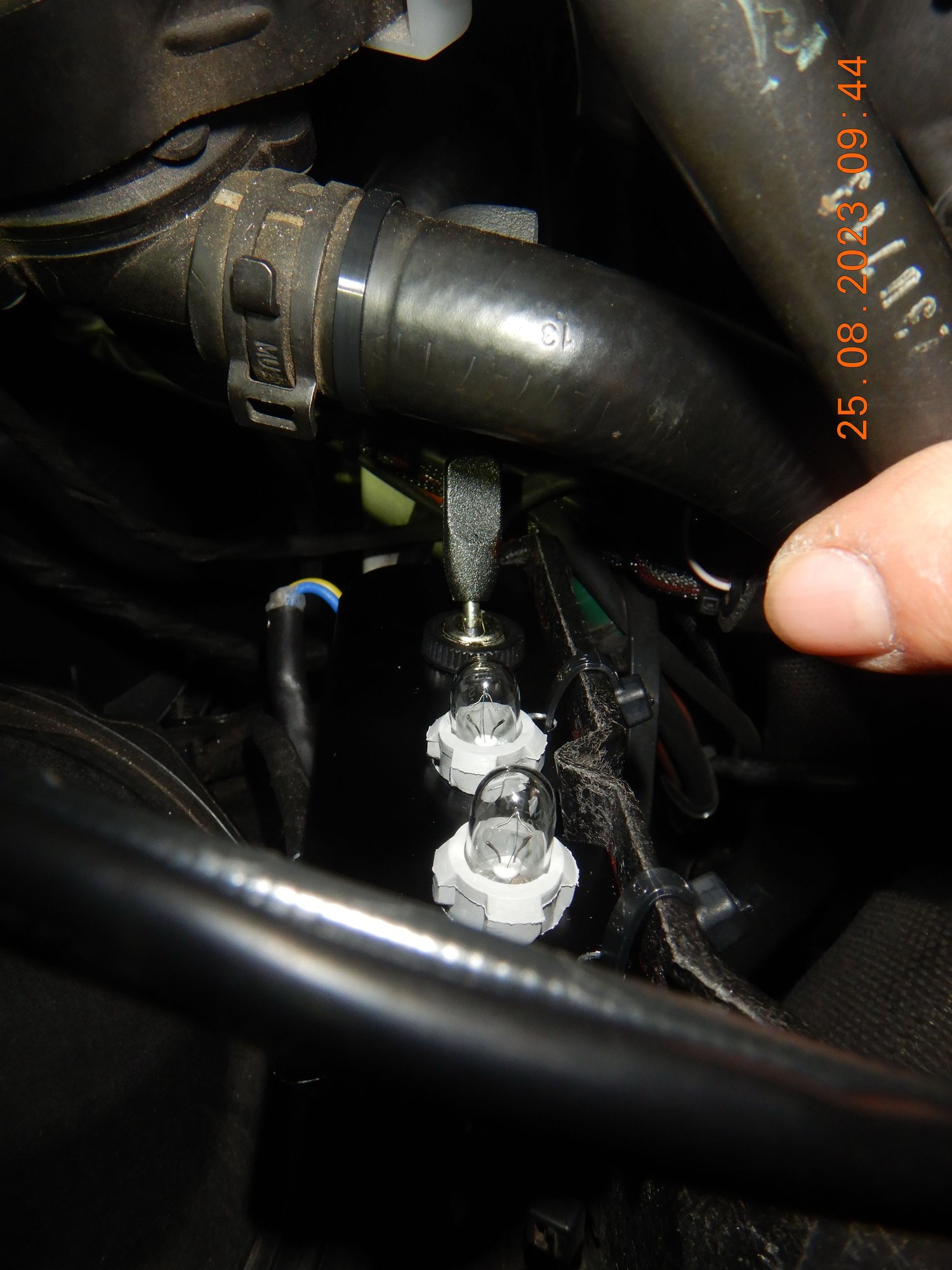

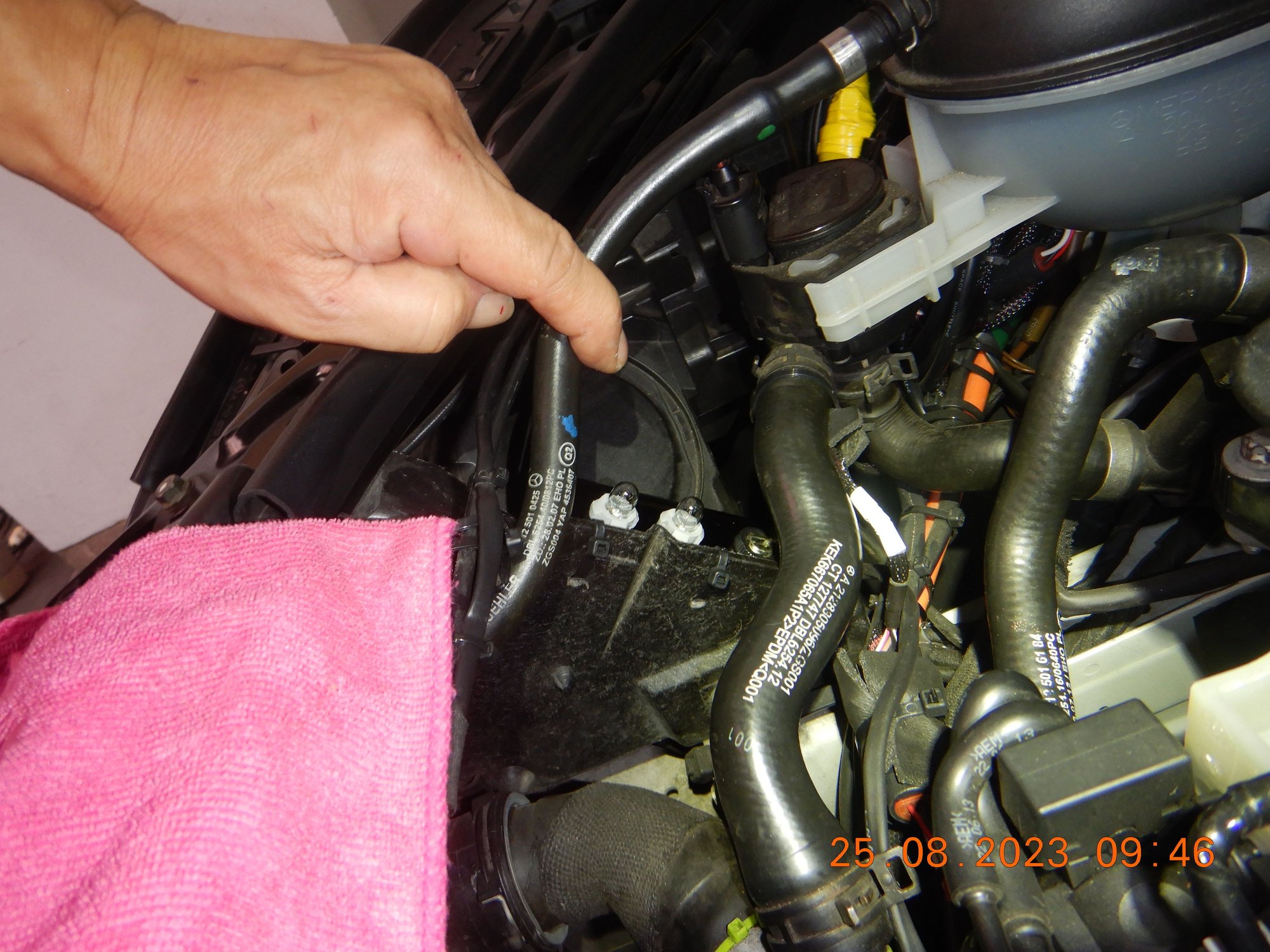

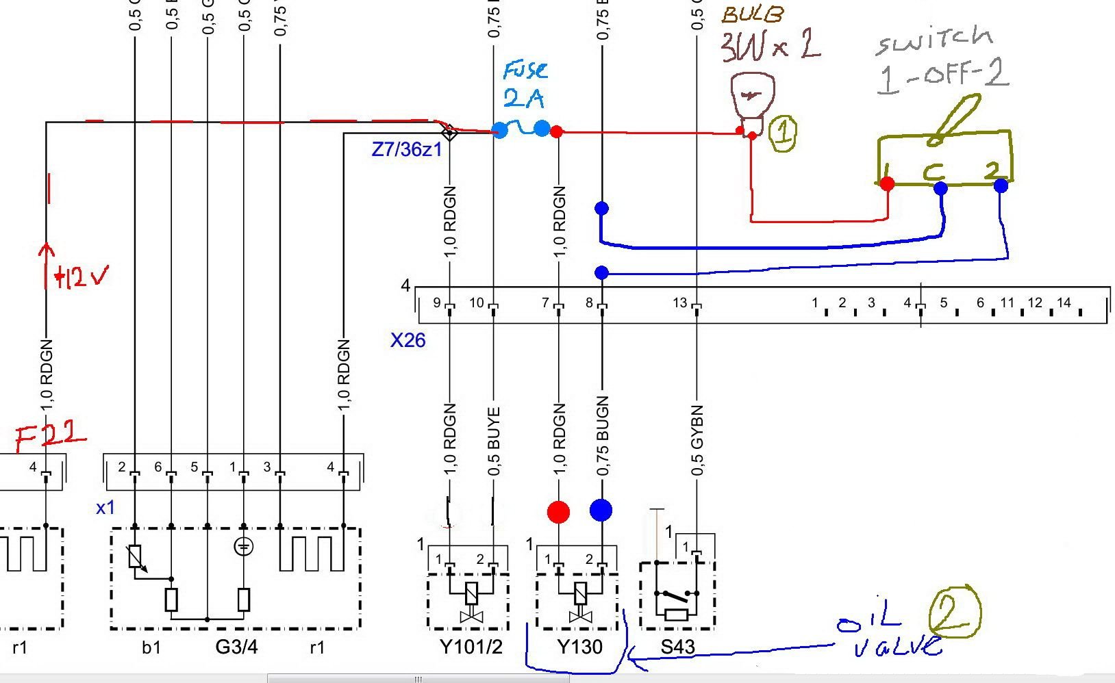

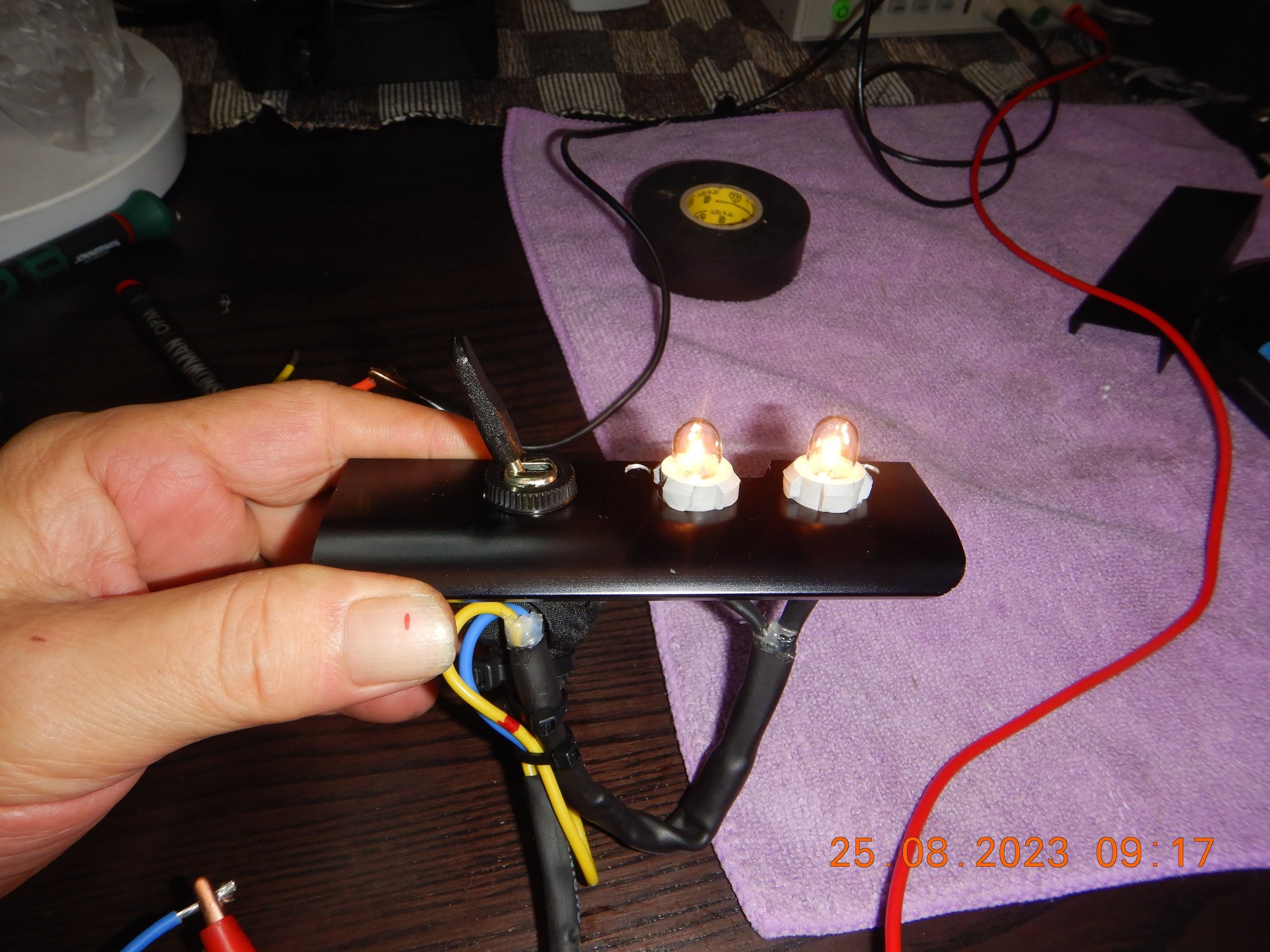

I can change oil solenoid defeated or not in 1 second. I have a switch and dummy load for it. As long as when I choose it the engine is OFF, there will be no DTC.
The bulb intensity tell me what the ECM is doing to the oil solenoid, because the 2 bulbs are the dummy load and ECM does not know.
The amperage is good enough for ECM to be fooled that it is an Oil Solenoid.
The bulb is special Honda motorbike instrument cluster use, 3 watts very cool operation incand bulb. No more than 80C operational temperature.
The 5 watts T10 incan bulb our W212 uses, by Toshiba, that thing is 144C easy, very hot operation.

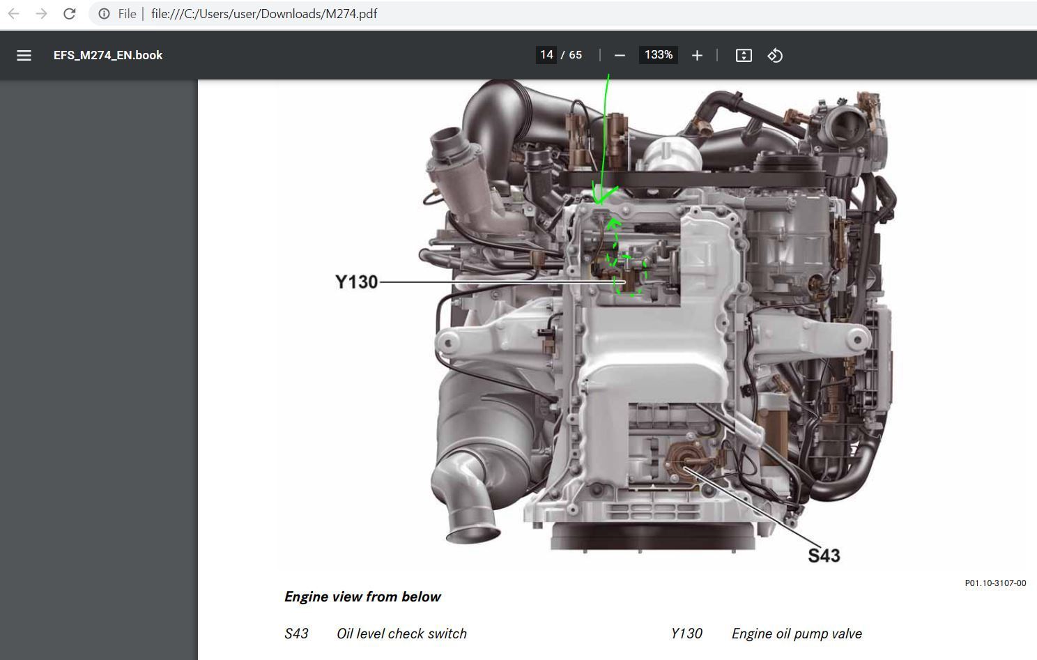

This is how the dummy load works
Dont worry about oil solenoid getting stuck yada yada, when you have oil pressure sensor like mine to verify, you can switch the oil solenoid defeated/normal every damn day it is OK.
Also in normal operation a standard non-defeated oil solenoid, it will turn ON-OFF so many times by ECM command everytime you drive....anyway.
If you keep your oil clean, I guess the oil solenoid if it dies it wont get stuck mid way.

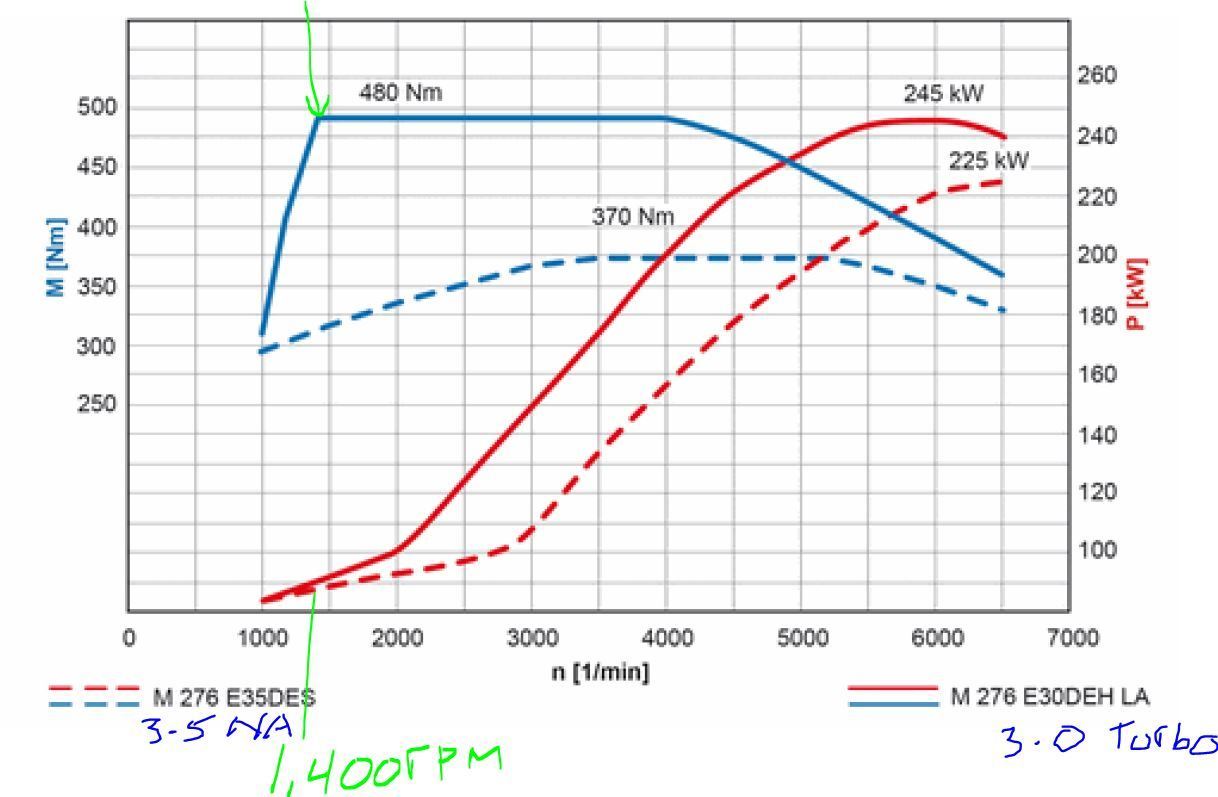

As to why M276.8 3.0 turbo won't feel much ( or any ) power benefit compared to M276.9 NA 3.5L is because E400 turbocharger is a city comfort turbo which has peak torque 480Nm as low as 1,400 RPM.
No amount of VVT magic can beat turbocharger for the oomphhh of extra 160Nm at 1,400 RPM, where M276.9 at the same 1,400 RPM only has 320 Nm.

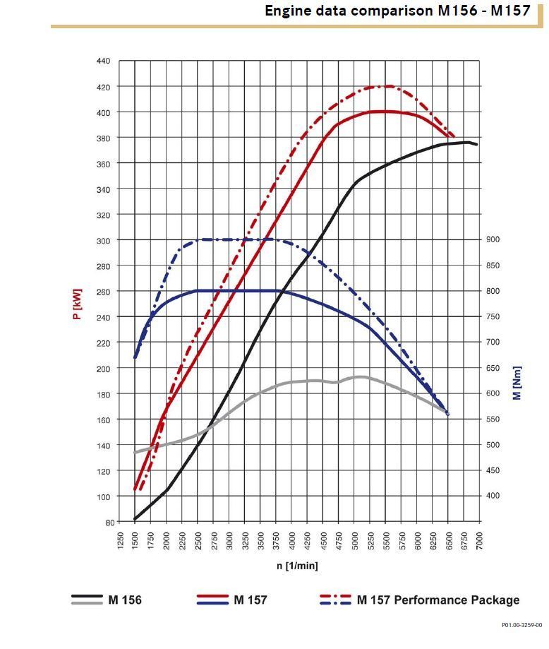

M157 is a sport engine. But the peak torque is at 2,500 RPM, and a beast of a torque at 800 or 900 depending on performance package.
Perhaps those M157 owners who feel the benefit of un-plugging is having the joy at 1,500 - 2,000 RPM where the torque is on a steep rise.
M278 is not too sporty engine, but powerful nevetheless as a semi-comfort-sporty engine.

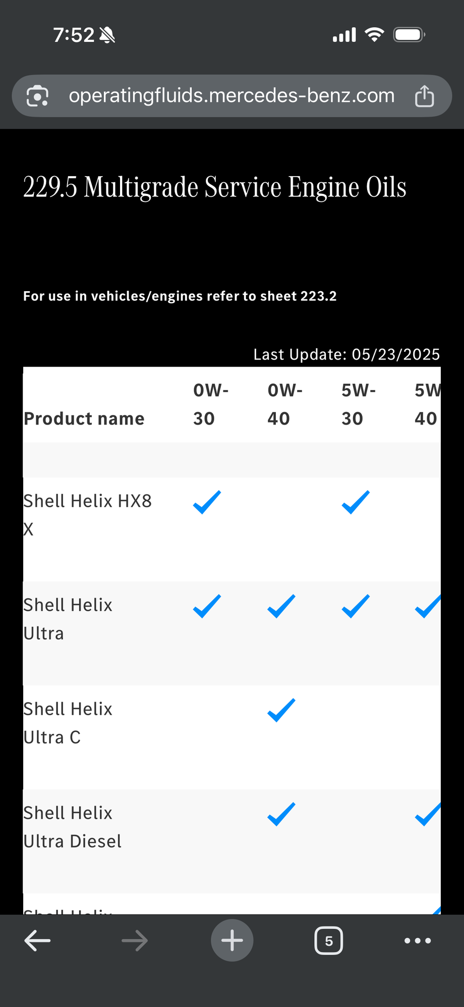

I’m not certain that the manual says not to use 5W30 She’ll Ultra.
Our manual says to use MB229.5. When you check the 229.5 rated oils, you see that Shell Ultra is rated at 0W30, 0W40, 5W30, 5W40 weights:

Give your mechanic friend this link : https://www.pvv.ntnu.no/~syljua/merc/M274.pdf
Good luck.........
