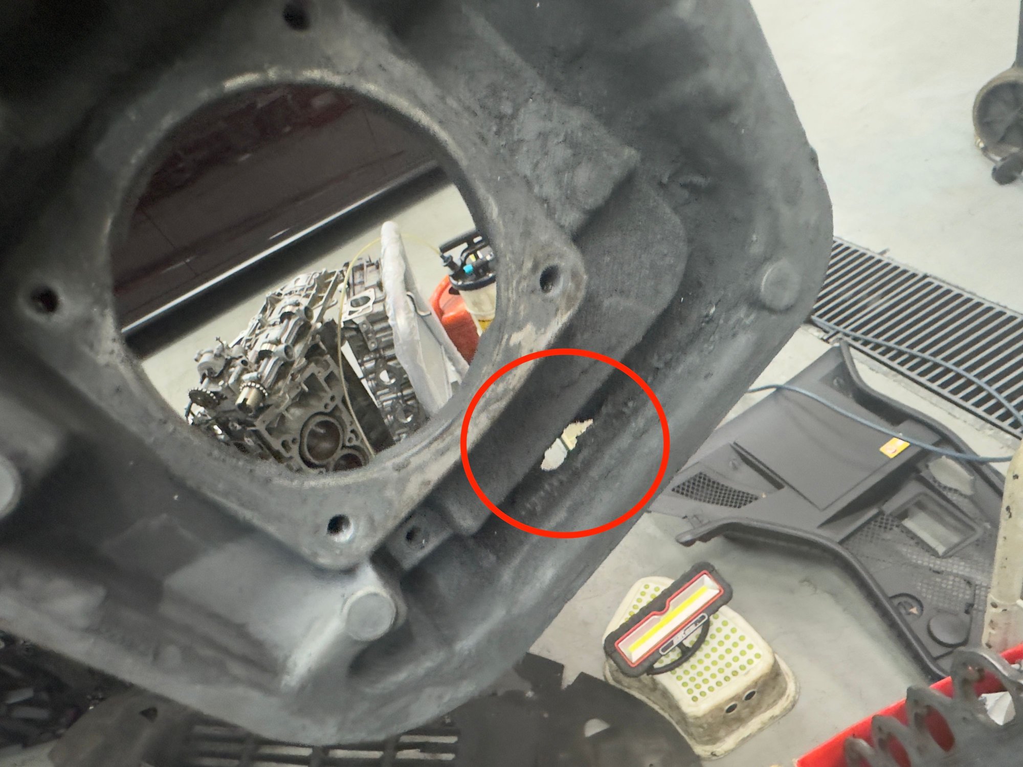

Had increased FC for my car, workshop found a leak in the intake manifold.Originally Posted by jasegarn

What kind of leak? Fuel? Air? Shoulda been a DTC.

There aren’t any DTC’s and I don’t think I’ve got a leak but, who knows?Originally Posted by JettaRed

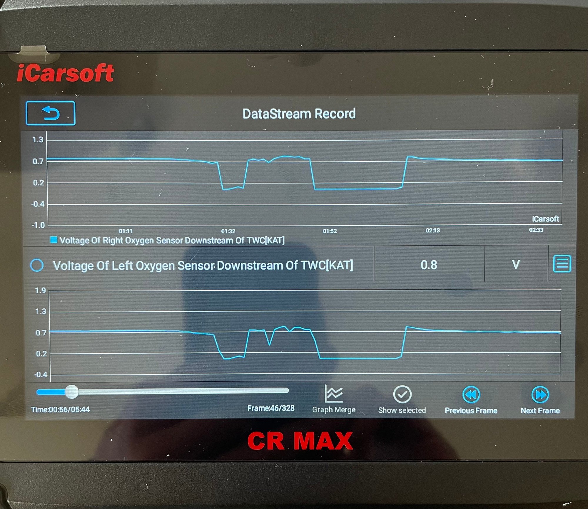

Read both your engine lambda and cat oxygen sensors.
Do that couple times to compare results for a lazy participant.
Combustion sensors are super heated ceramics and don't like thermal shocks.

No DTC. M156 engine, only found out when I needed to calibrate the new clutch but the RPM kept hovering slightly above the required speed.Originally Posted by JettaRed
I’ve just been out for a run in the car. The voltage of both R/H and L/H oxygen sensors drops, what looks like randomly but both at the same time, to 0 volts. In my iCarsoft they are identified as Oxygen Sensor Downstream of TWC[KAT]. This can be for anywhere between 2 seconds and 12 seconds.Originally Posted by CaliBenzDriver
now that you mention the standing water... we now have a possible signature for poor mixture.Read both your engine lambda and cat oxygen sensors.
