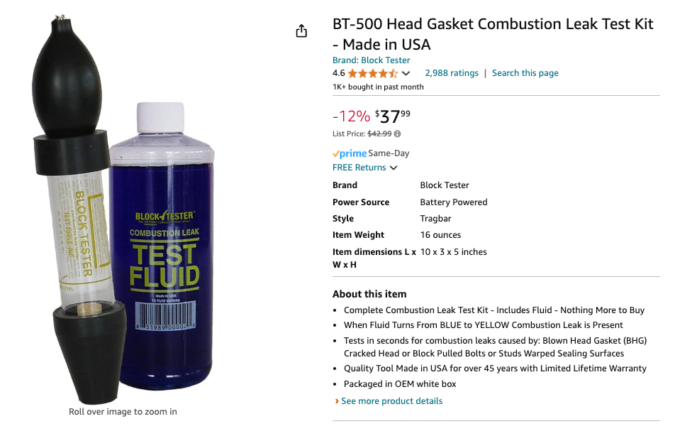

If you think you have a cracked head or leaking head gasket, you can do a simple test for exhaust gases in the coolant reservoir.
