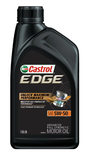

Originally Posted by Baltistyle
Yes. I have been using the Castrol 5/50 and loving it. You can see my oil story under my name if you have not. Its mentioned when discussing my cylinder walls. The goal for me was to not have to use additives, but the best oil for the application.
I’ve tried searching your posting about oil, but couldn’t find anything.
if you could forward it to me, I’d appreciate it.
lastly, any reason why you’re hesitant on additives?

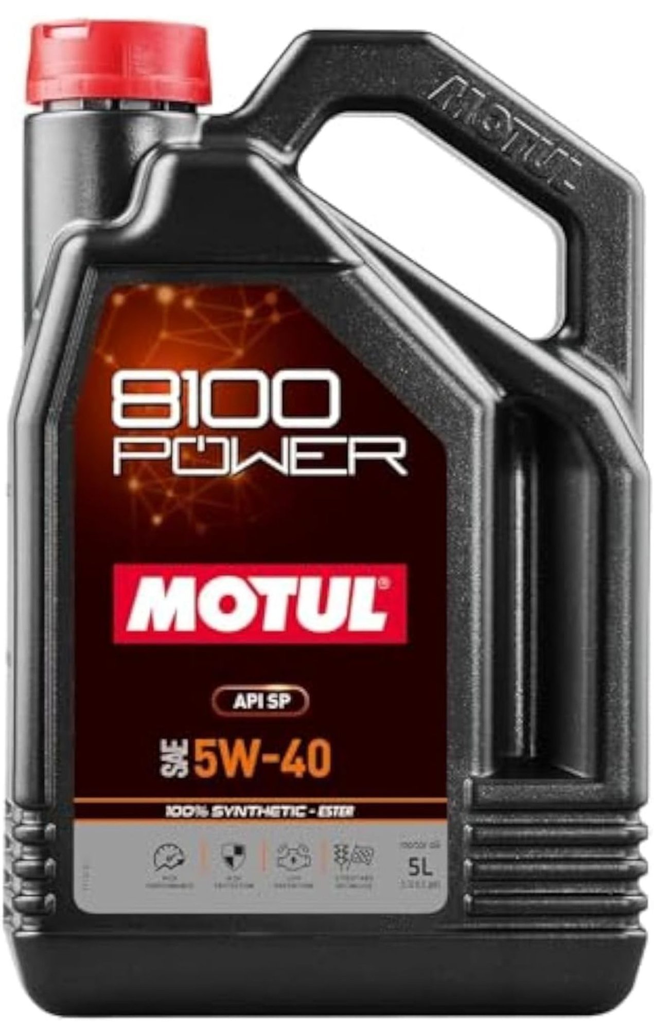

Motul 8100 Power does not state “MB Approved 229.5”
Motul 8100 X-cess gen2 does state MB Approved right in front of its bottle.
Concerning factor surely, any feedback in regards to this?
MB Approval scope is quite narrow:
from 0w40 all the way to 5w40:
essentially the same thin oil that rapidly shear.
If you want to remain closer stock... MOTUL 5W40 API-SP ester oil does a real good job with uncontrolled heat and honey unburned color.
CASTROL Edge perhaps does too ??
Look for "API-SP" rating.
VVT Gears positioning is MAPPED... not dynamically calculated.
This best requires stable oil viscosity ie. temperature!

Motul API-SP oil in 5W40 weight.
MOTUL API-SP oil in 5W40 weight.
Within the limits of your pre-selection....
I'd use the above for its proven flash point.
You won't get a lot of missing oil vaporized onto your intake valves.

Here you go. It also explains why I’m not looking to use additives. Too much of any of these additives becomes a negative factor in chemistry, to include ph stability. I likely had stuck rings due to too much ceratec, since my oci is super short. My only mistake in that thread might be thinking that my old motul was sp. I’ll be sending an email to find out.
Im at 1k miles with the 50 and it truly is performing better, for me.
For anyone really wanting to learn about oil and form their own conclusions, I really recommend “the oil geek” on YouTube. He is unmatched in his modern conveyance of this knowledge, imo.
https://mbworld.org/forums/w212-amg/...72k-miles.html

selection given 5w-40 Approval
-- You want to use an 5W40 SN oil...
It's a compatible MB Approved oil
(besides SN: LSPI)
-- Your engine may be well served with
MOTUL 5W40 ester based API-SP... really clean!

Great feedback, I will proceed with the following
previously I’ve used 5-40 MB Euro FS
it’s API-CF rated. It states of MB approved 229.5 unlike motul power. I wonder why
https://www.mobil.com/en/lubricants/...bil-1-fs-5w-40
Should I add Mos2 with it? As I’ve always done during Oil change. Or no
MOTUL Gen-2 SN has MB Approval, perhaps newer SP doesn't.
Feel free to spot if any API-SP are MB-Approved.
Newer API-SP formulation is a departure in friction modifiers to mitigate LSPI issues with low tension rings.
LiqMoly is big on pushing additives where all other oil companies provide complete lubricant package and recommend against tainting their blend.
"Mobil1 supercar" oil features heavy friction-modifiers... all-inclusive package.
I only wish it had some kind of “mb approved” stamp 🤣

Based on your application of spirited high RPM stock setup then I understand why you boost anti-friction package of premium oils :
-1- Motul ester base
-2- "Mobil1 Supercar"
-3- Castrol Edge
-4- Amsoil Signature
