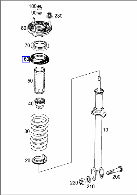

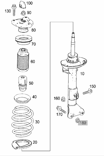

I assume this is a diagram error but the way the strut attaches to the knuckle is not drawn correctly. They show a style that may be for RWD vehicles.
Here's how the front strut looks on both my RWD cars. My C350 Sport is RWD and looks like your picture in the pdf.

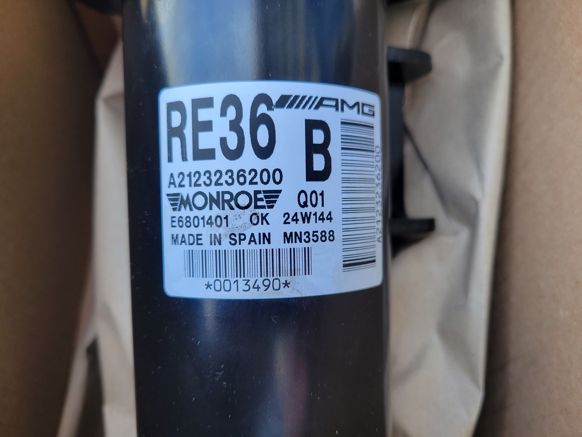

Picked up the right one from the dealer. It is JUST a bare strut. I will have to order a bunch of stuff to get the maximum benefit from replacing these. Which will add hundreds to the cost of this. I'm in it now.
Also, 2024 production. Monroe, made in Spain just like OEM.
cheers! Good stuff man.
to quote your statement, what do you mean by “just like oem” I thought it was (Monroe) OEM that you’ve ordered from the beginning.

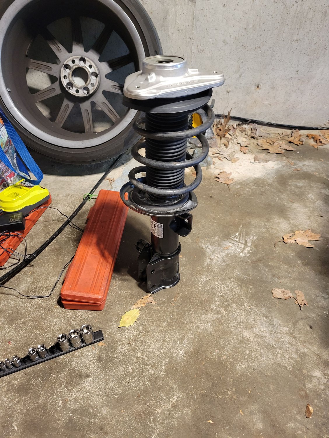

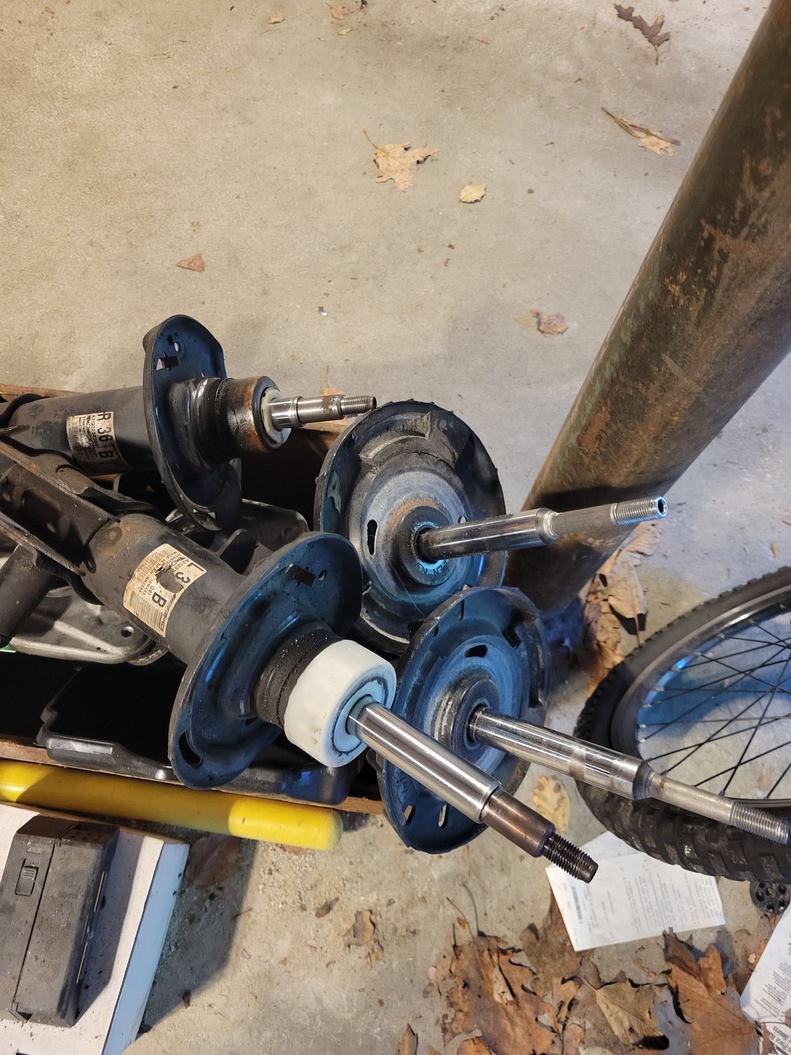

Did the front struts 3 weeks ago, with OEM parts (not Bilstein). It's a pretty easy job. The only "tricks" to the job are your method to compress the spring to get the mount off the shock rod, and having the right tools to remove/tighten that top nut. I already linked the Vevor spring compressor. We used it the same way that WIS recommends: top jaw goes on top of the strut mount and bottom jaw goes onto the lowest coil possible. For the other tools, I bought this kit and it was great, including for the stabilizer links:
Amazon Amazon
Great master kit to remove fasteners where you cannot get a conventional socket or wrench around the nut and have to hold the center stud from turning. Even included a weird slotted socket to tighten a ring nut on my friend's CLK550.
We had them out pretty fast.
We did try just using two coils initially and it did not compress enough. Upper jaw has to go on the strut mount (WIS agrees).
The spring compressor warns about not using an impact.  It did eventually break the lower cotter pin and we had to reassemble the spring compressor.  So use the impact carefully and make sure not to top or bottom out the tool with the impact.

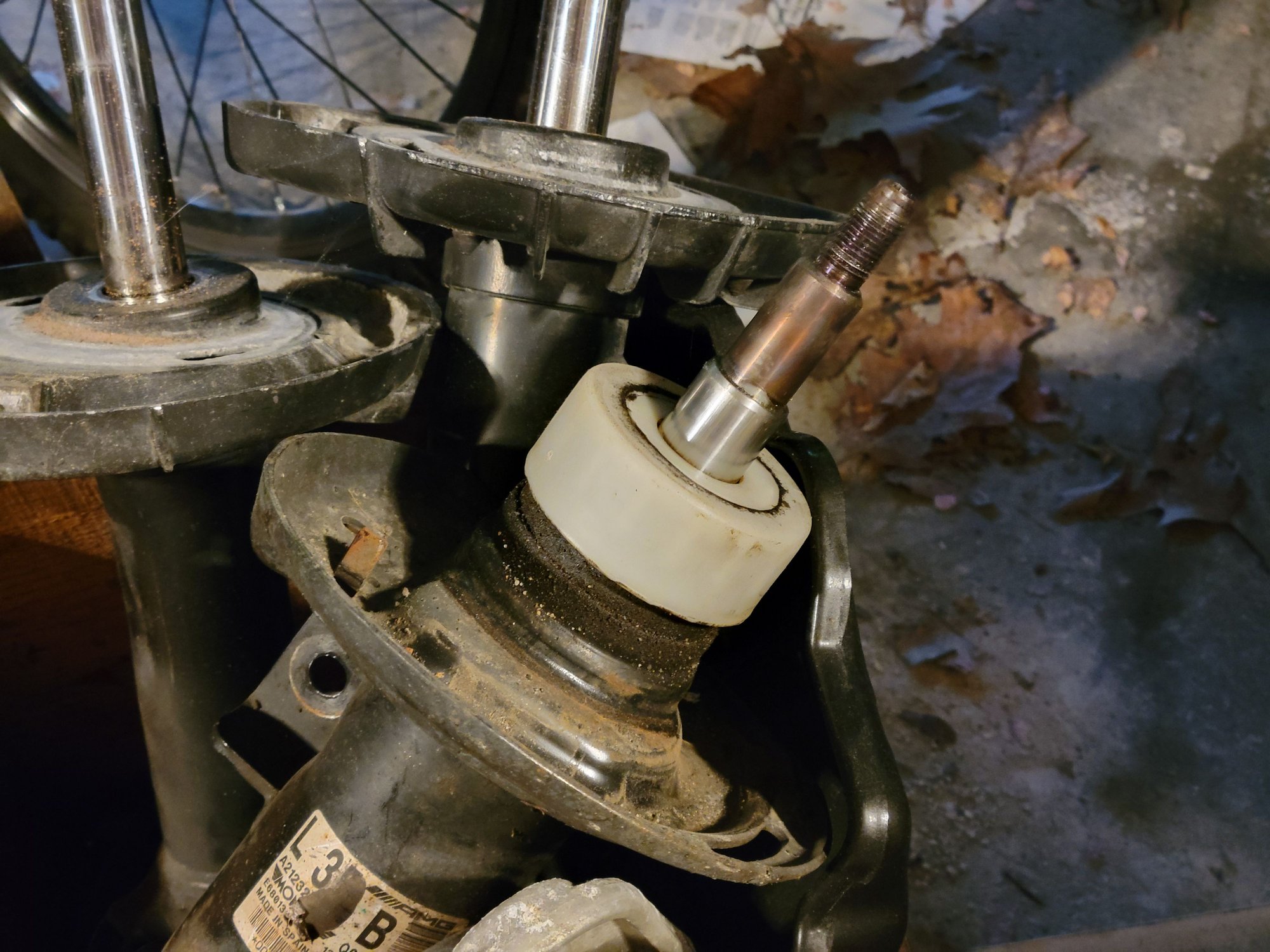

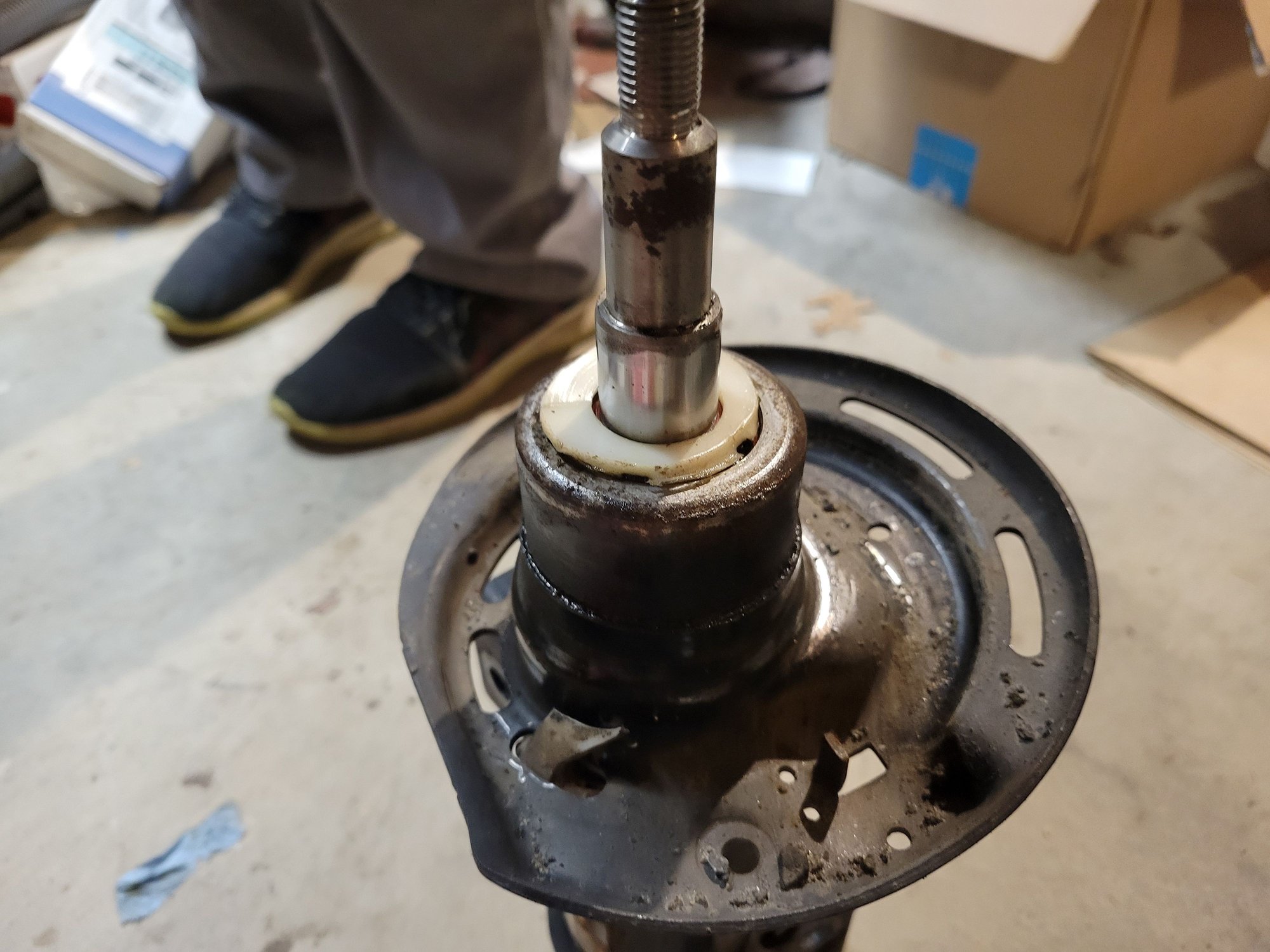

The right strut was even worse than the left.  That white piece is broken and probably happened from bottoming out.  Not much gas left.  And it was leaking.
