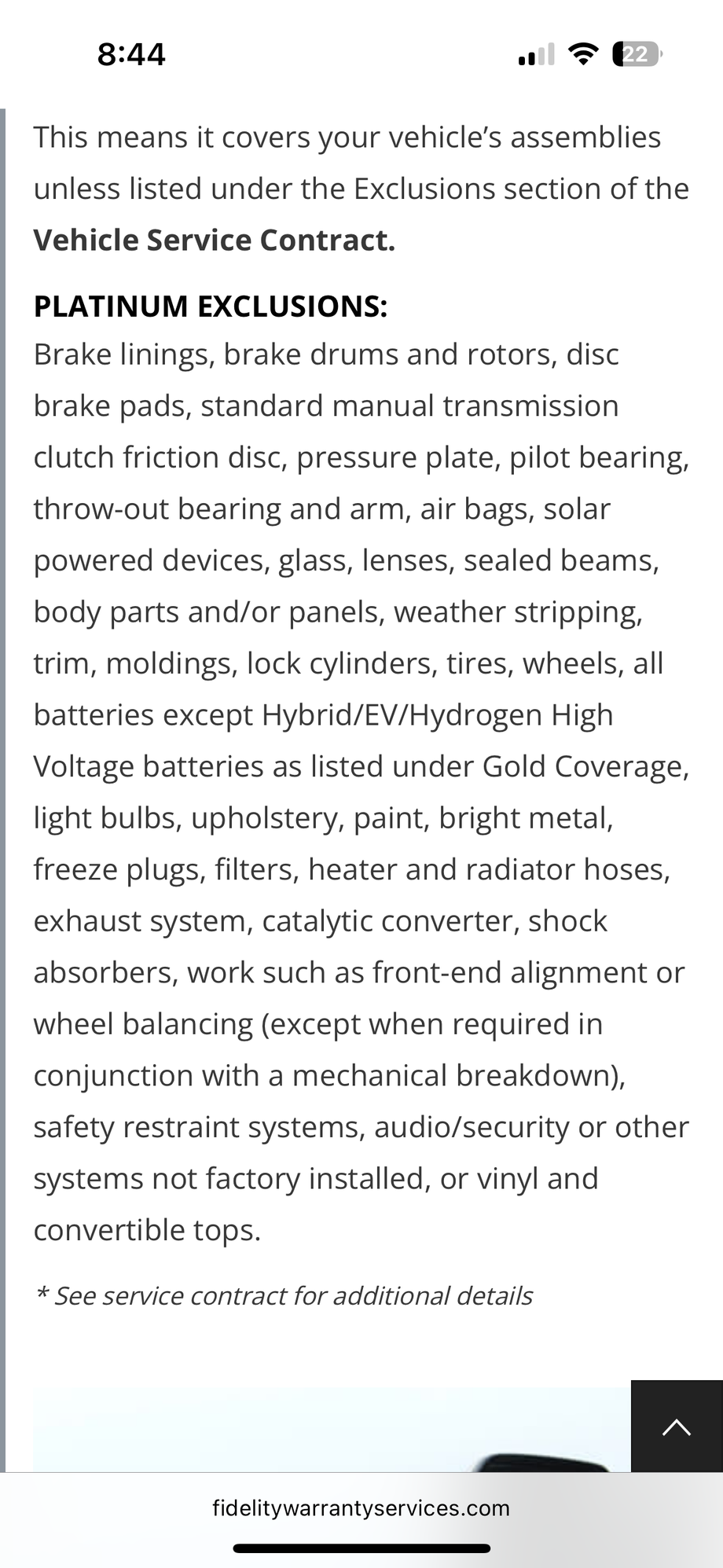

Every contract can be a little bit different, but this is the summary of the exclusionary policy from Fidelity’s website. For those that are unaware, what an exclusionary policy means, it means everything is included in less specifically listed as not included in the contract.

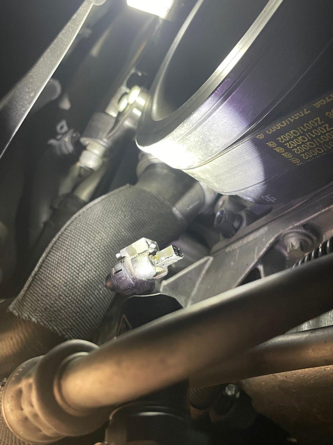

Yeah I have had 9 pigtails - four pucks, four cps, and one oil solenoid
then I just disconnected the damn solenoid
yeah - don't know why the 2 pin is not OEM pigtails - glad eBay and Amazon had them
here is my oil saturated connector for the oil solenoid before I added the pigtail

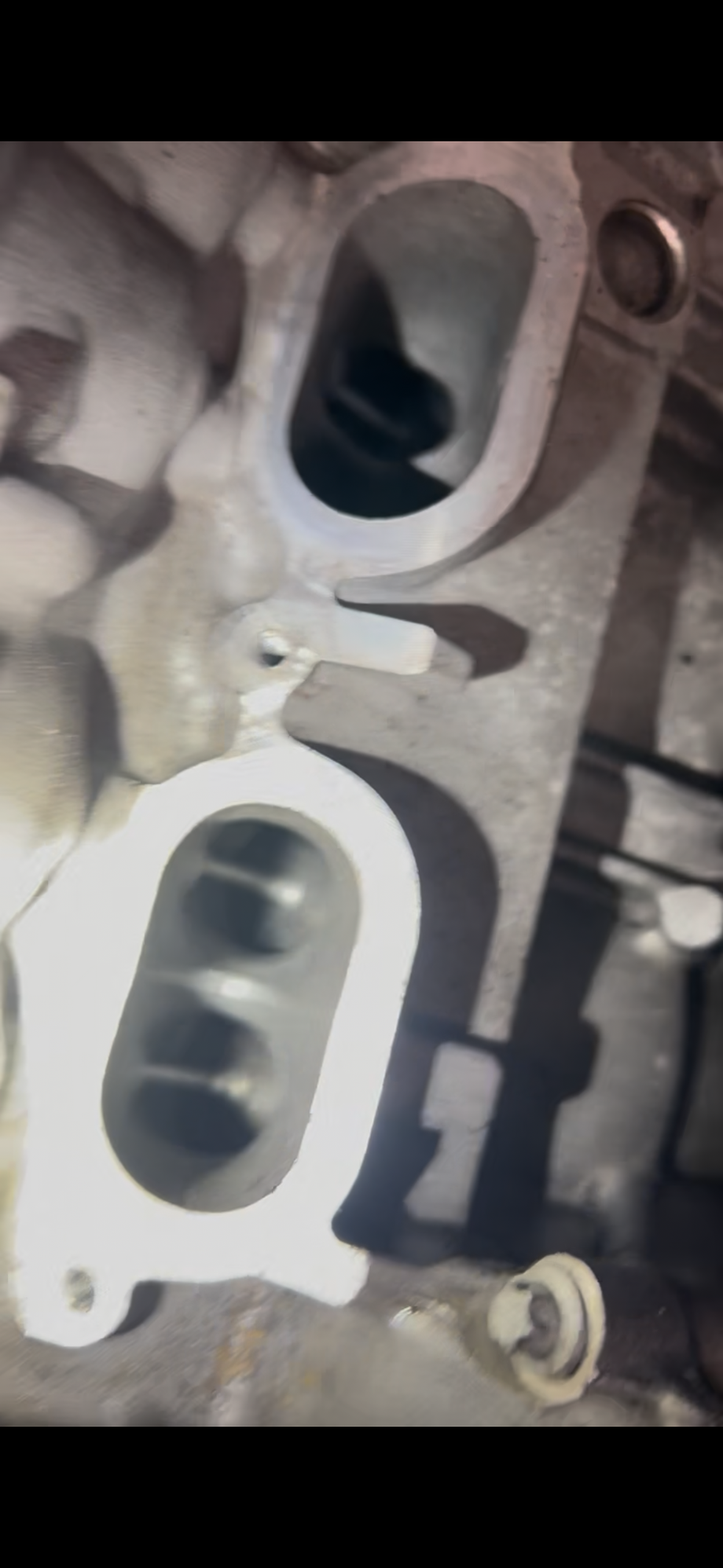

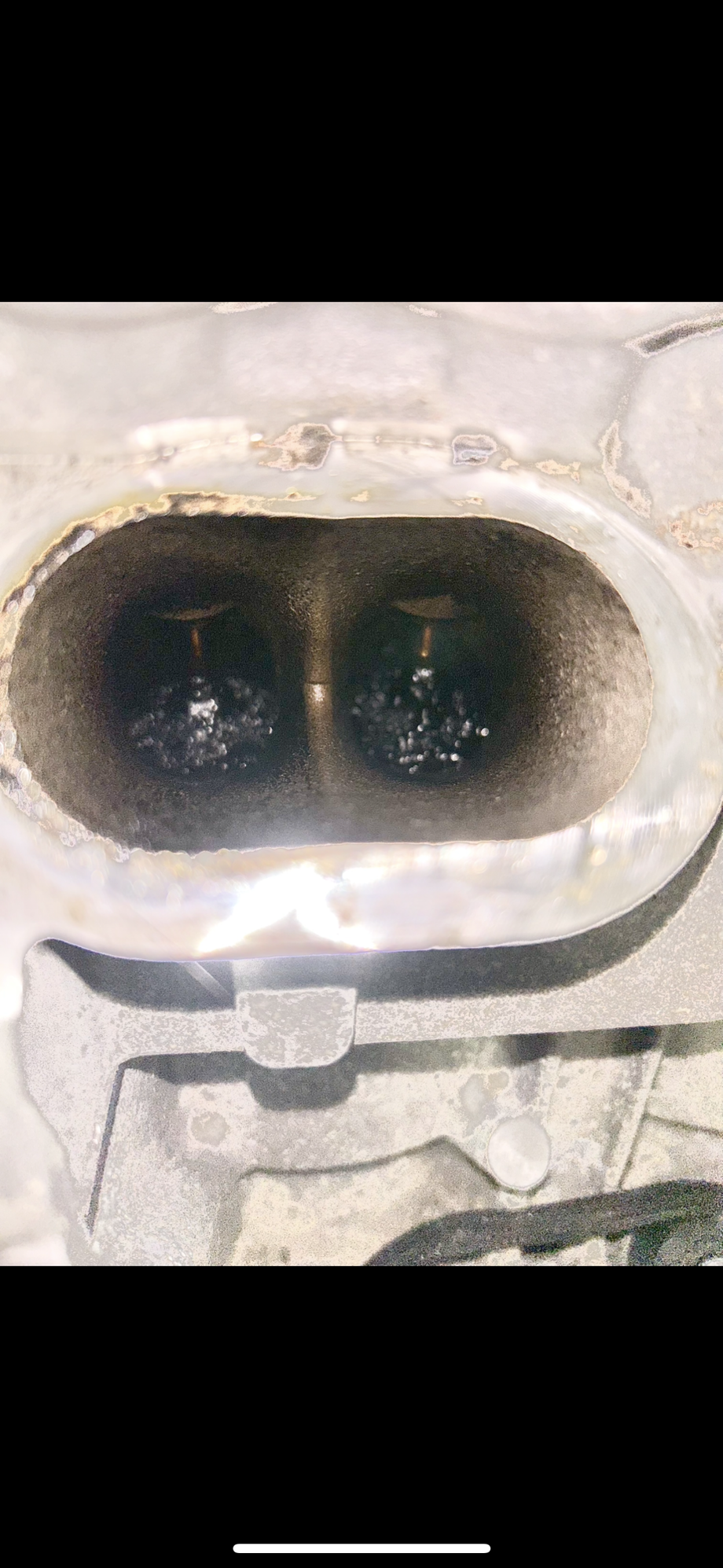

Still working through it as some parts had to be ordered and a space needed to clear up on the rack. I should have it back tomorrow.
since they were removing my intake during this repair, I asked if they would walnut blast my valves, but this Mercedes dealership does not do that. The other day I got to thinking I should ask if they will just do a little bit of cleaning of the valves if indeed they were very dirty and basically said whatever they will do is better than nothing..They used some solvent but I don’t think they were going to make them “spotless”. It’s hard for me to show the after pic from the video they sent but here is a picture of the before cleaning. The after pic I could see them 90-95 percent cleaner and don’t know when in the process they took the video so I’ll have to ask them how in depth they actually went. They had issues sending pics through the internal system so I don’t want to be a pain. 73k mile below.
You might have to adjust the brightness or contrast on your phone to really see how nasty they were. The picture was taken in live mode, and I wasn’t sure how to capture when it was bright if you are familiar with Apple phones..
Afterwords
Afterwords

They look indeed 95% cleaner - well played, you're definitely in it for the long haul and doing it right

Thanks. Its been weighing on me as to whether to diy. I knew they were dirty from a boroscope inspection and if you remember my thread about cylinder walls, I had two drafty cylinders and have been working on getting the rings clean. When monitoring my cam adaptations, the left bank, which was dirtier, has a few degrees of adjustment while the right side has virtually none. Ive seen this reported by other users but not really delved into much since very few if any have gotten the check engine light due to a reluctor ring, on our engines. Cleaning was a first step to monitoring whether this is reluctor ring related, or adjuster related, dirty intake related. I figured if I could get it cleaned/cleaner, and offer to pay (which im not sure they will even charge me for) it would be less expensive than any alternative in the future and/or would save me from probably two days of work. I do wonder if there is actually a useful catch-can but I think thats still debatable as to its efficacy in our engines. I also think that with the change in oil chemistry for gdi engines, and other ways we have figured out how to oil them better will create results better than the first 70k.

as you know, cleaning the valves and walnut blasting is so rarely discussed on this forum, I have about two threads linked in the sticky on that, but no real feedback on people who have had it done or cleaned the valves and then reported back performance gains or return to baseline performance.
I'll be real interested to see if you see improvements when you log your car now that these valves have been cleaned. Wishing you good vibes.

Thanks for the vibes. The only oddness Ive noticed when scanning is the adaptation of the cams, as well as one slightly "off" but in range o2 sensor. Ill be correcting that o2 once I get the car back. For the valves, Ive always found it odd that its not discussed more and while the engines may be more tolerant than other brands, the valves were definitely very dirty. I can only assume that cleaning the valves will offer a considerable flow improvement for combustion. Considering how tightly tuned the cars are from the factory and that there are now new designs for dual injection or procedures for chemical cleanings from new, I think its been realized dirty valves are bad. Thinking, back in the day and sometimes these days you have people still porting their engines for all the flow they can get and you can be sure their intake valves are not blocked by carbon. Then lastly, some will have the argument for the reason of the dirty valves but the reality is that many many engines like this have drafty rings so they also have dirty valves. Ive done everything to chase my oil use and it just uses oil the way I drive, and that oil winds up leaving in a round about way through the intake.
Peter, on the Facebook group today, others shared some pics of similarly dirty valves. I literally just joined and that was the topic.
