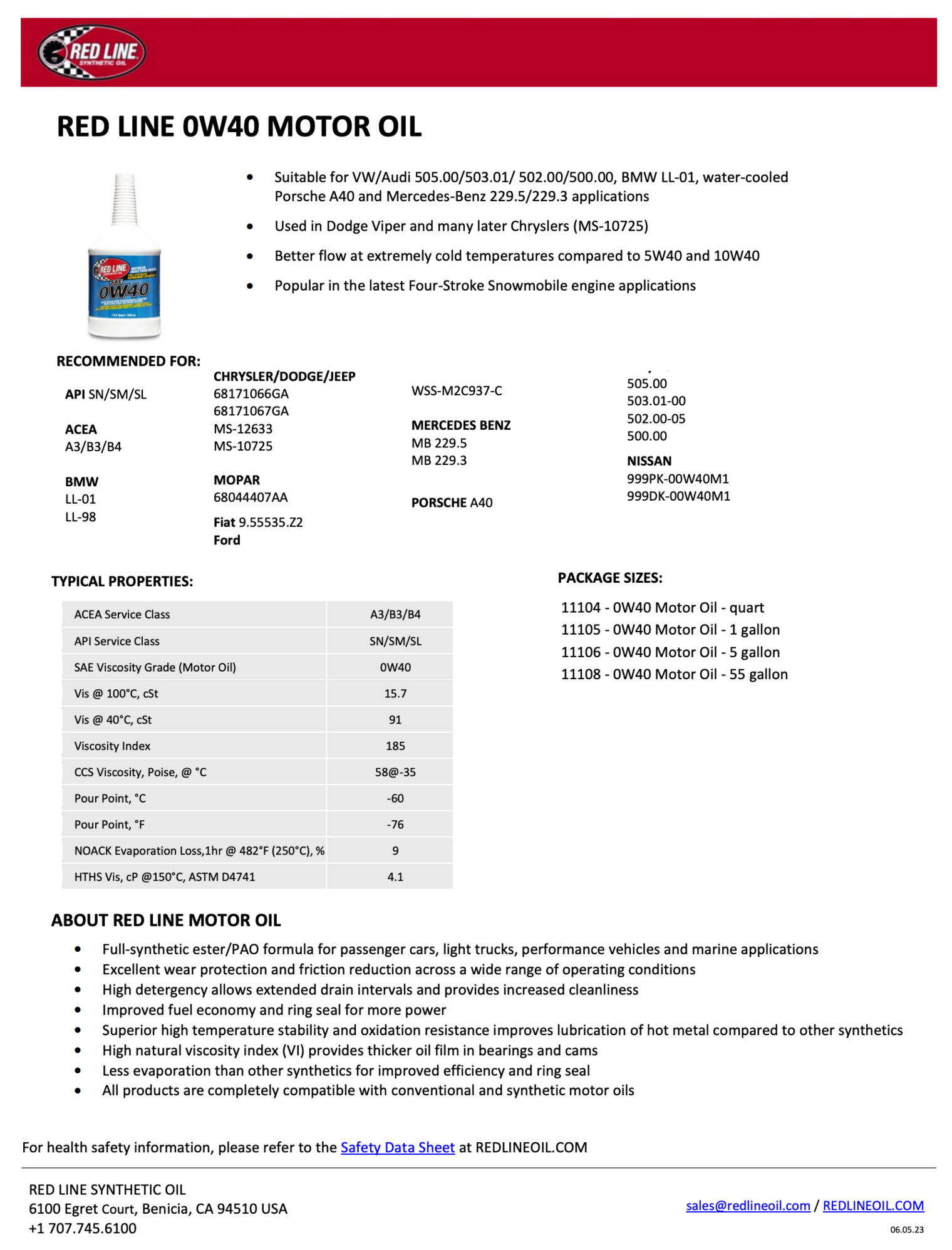

Anyone had experience with RL 0W-40?
I'm currently using liqui moly leichtlauf 5w40. Recently found out it's nothing but a glorified Group III oil. In fact it's not even full synthetic. The Red Line oil is a mix of Group IV PAO and Group V Ester. It should have far better stability and cold start protection.
Wondering if anyone has tried this oil before.

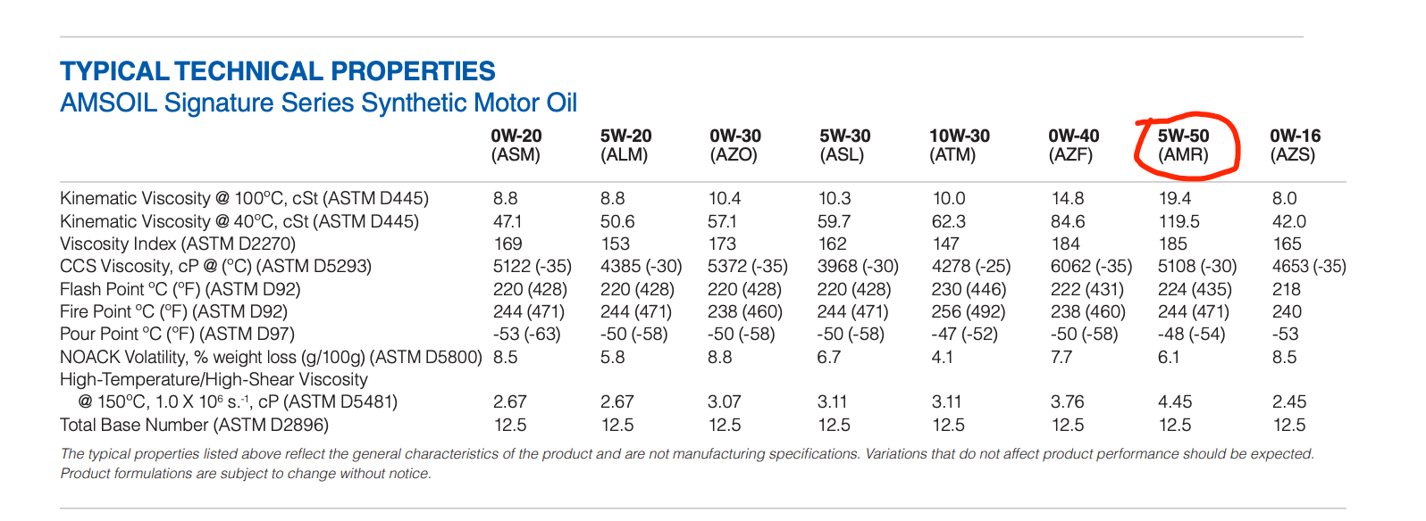

Jun 9, 2025 | 12:59 PM
Did you feel loss of hp at high rpm? RL 5w50 is really thick. 20 for vis@100.

Quote: Did you feel loss of hp at high rpm? RL 5w50 is really thick. 20 for vis@100.
though in no way scientific and i've only used for less 1k miles, not only did i feel no loss in hp wtih 5w50, i feel like the vehicles are more responsive and seem to run smoother. i feel more confident driving hard and, i do occasionally hit the governor. it feels like engine is working less at high rpm. smooth and snappy comes to mind. maybe thicker oil creates feeling of smoothness. what ever the reason, i like it and i feel confident with red line oil.

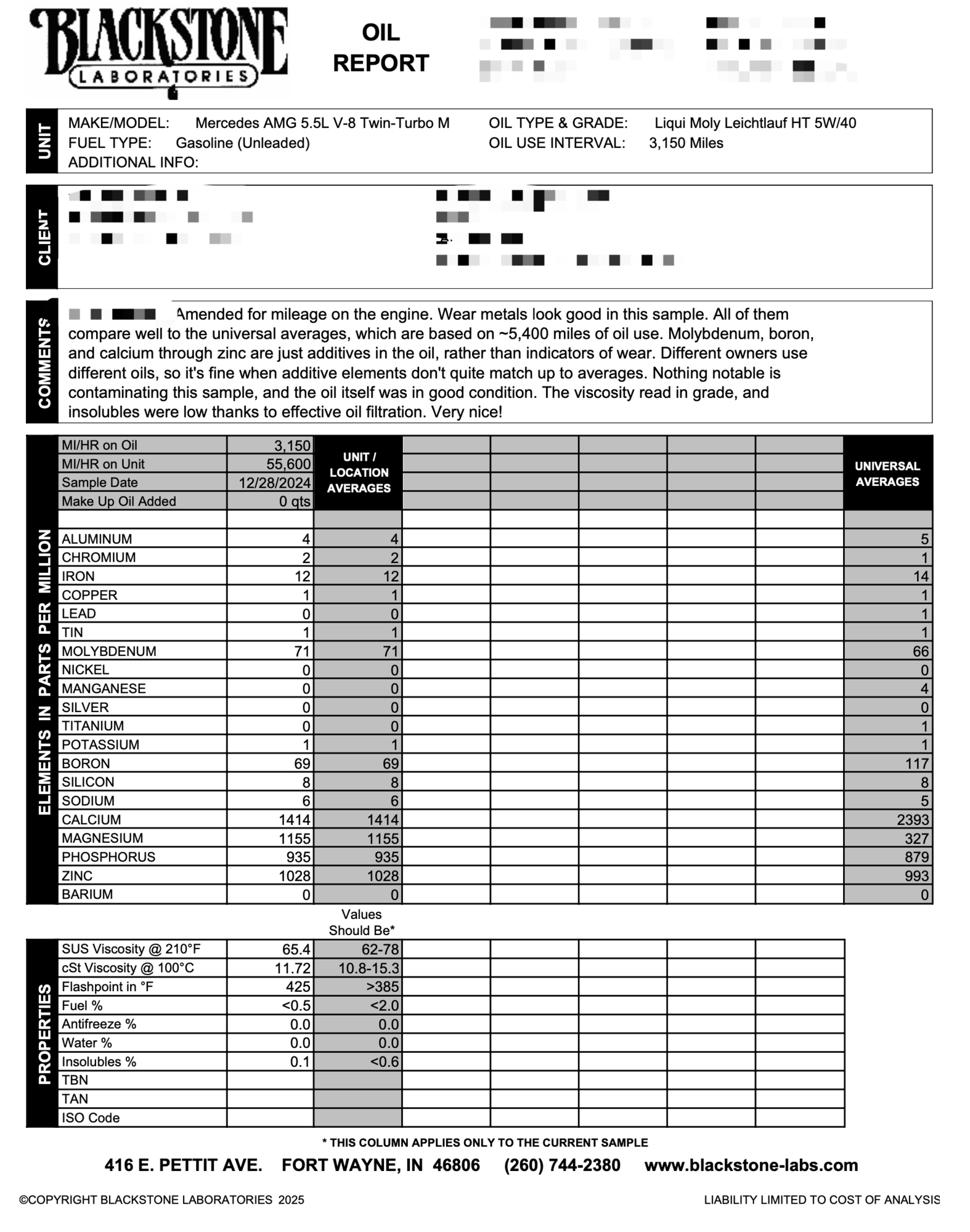

In comparison, this was my oil analysis for Liqui Moly LF high tech 5w-40 with only 3k miles.
Visc dropped to 11.72.

Jun 9, 2025 | 05:02 PM
Quote: In comparison, this was my oil analysis for Liqui Moly LF high tech 5w-40 with only 3k miles.
That's what they call "Euro oil"... it quickly saves more gas.
