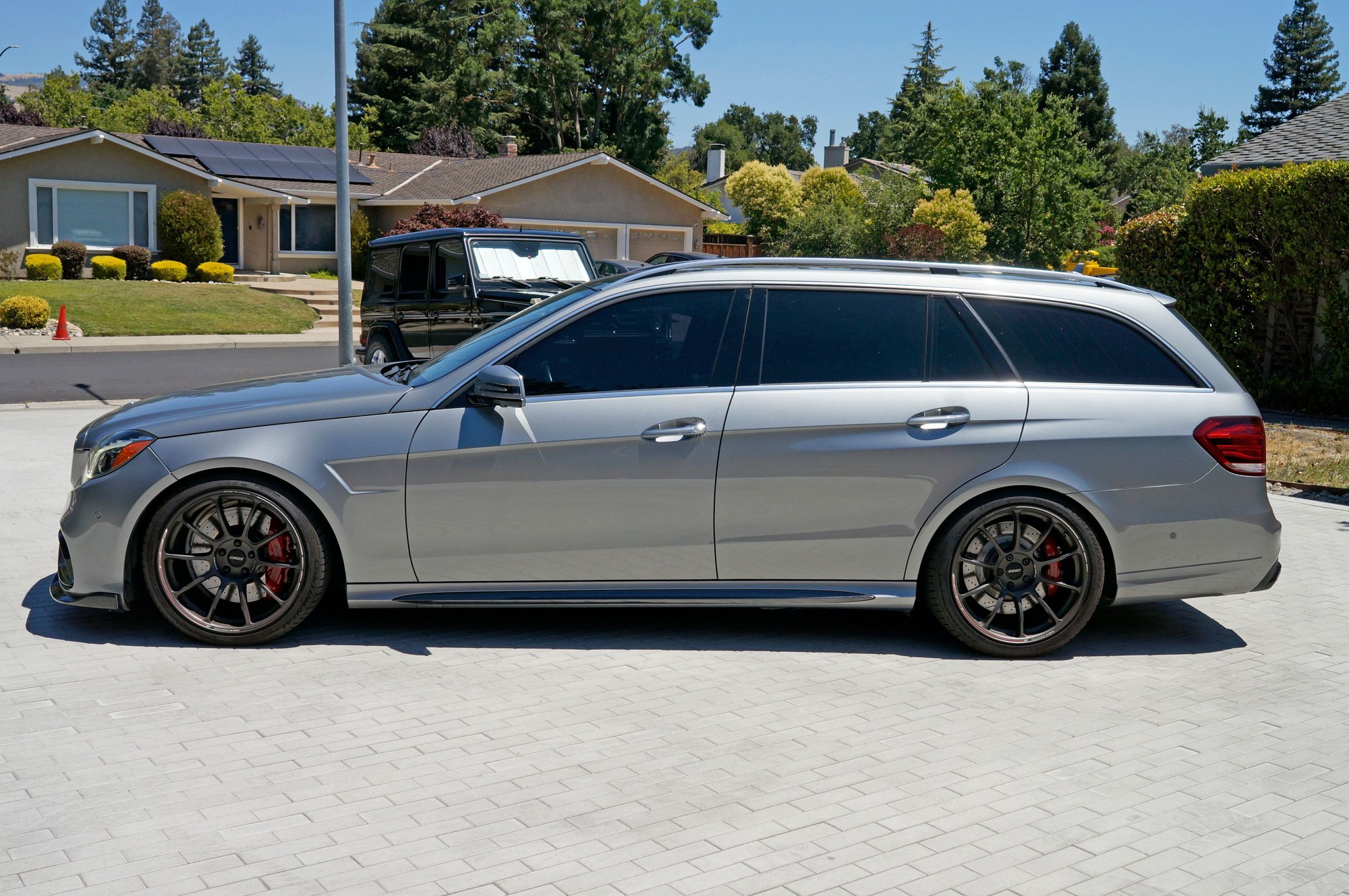

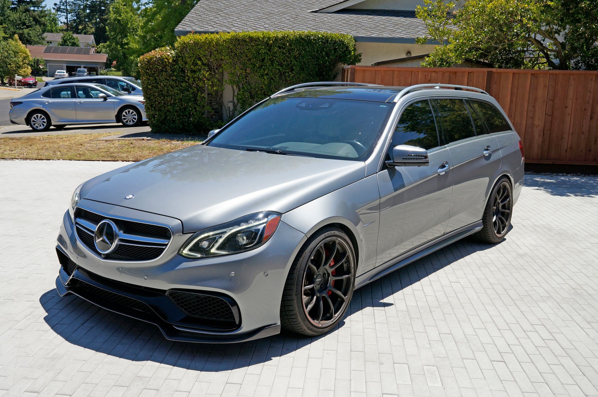

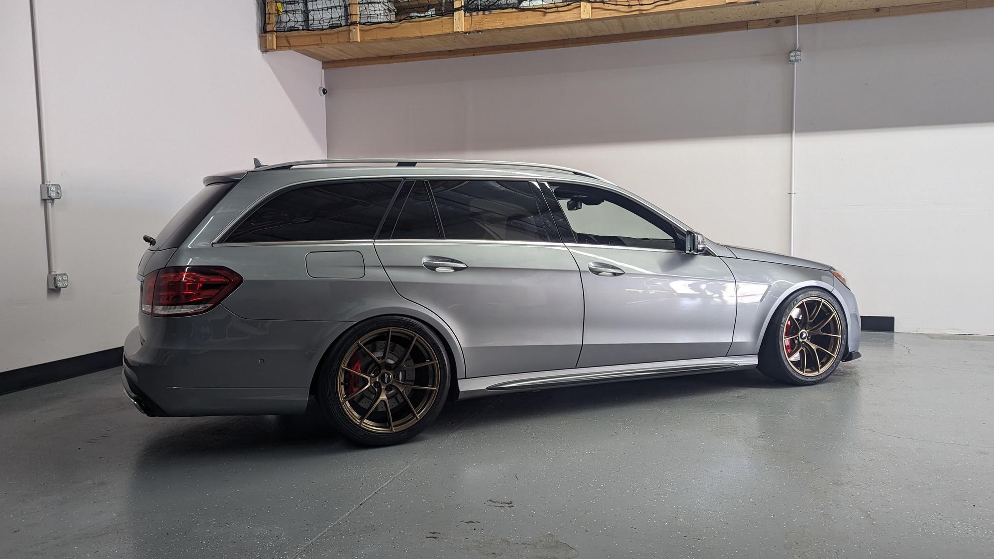

I remember these from a few years ago... Hope this info helps:
F & R : 19x9.5" ET35 with 265/35R19. Camber plates up front "that make this rub free"
20x10 et 35 all around. Tires are contisport 275/30/20

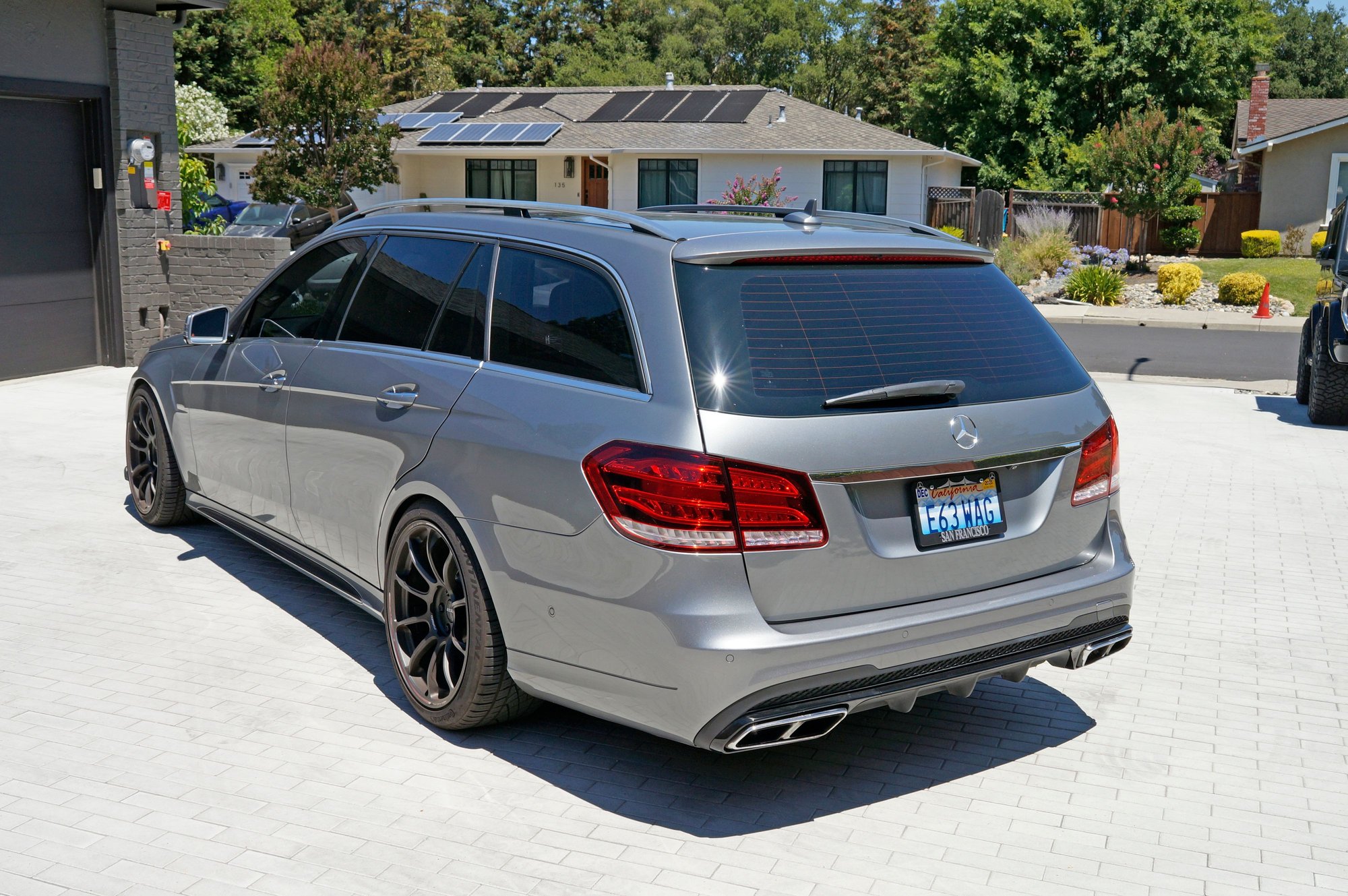

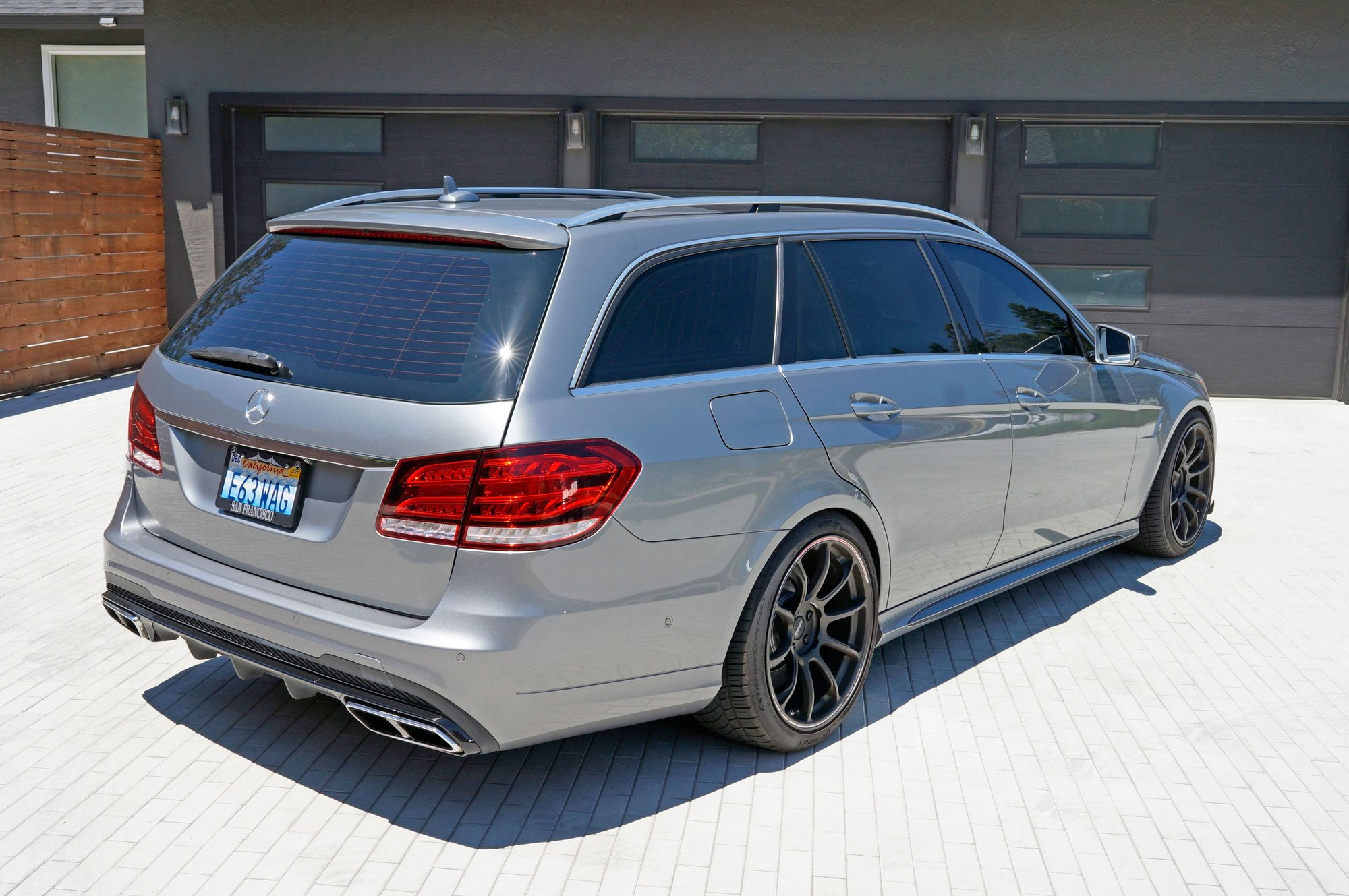

19x10+33 squared with 5mm spacer up front
What wheels are those?
Found it in one of your previous posts. Those look sharp.

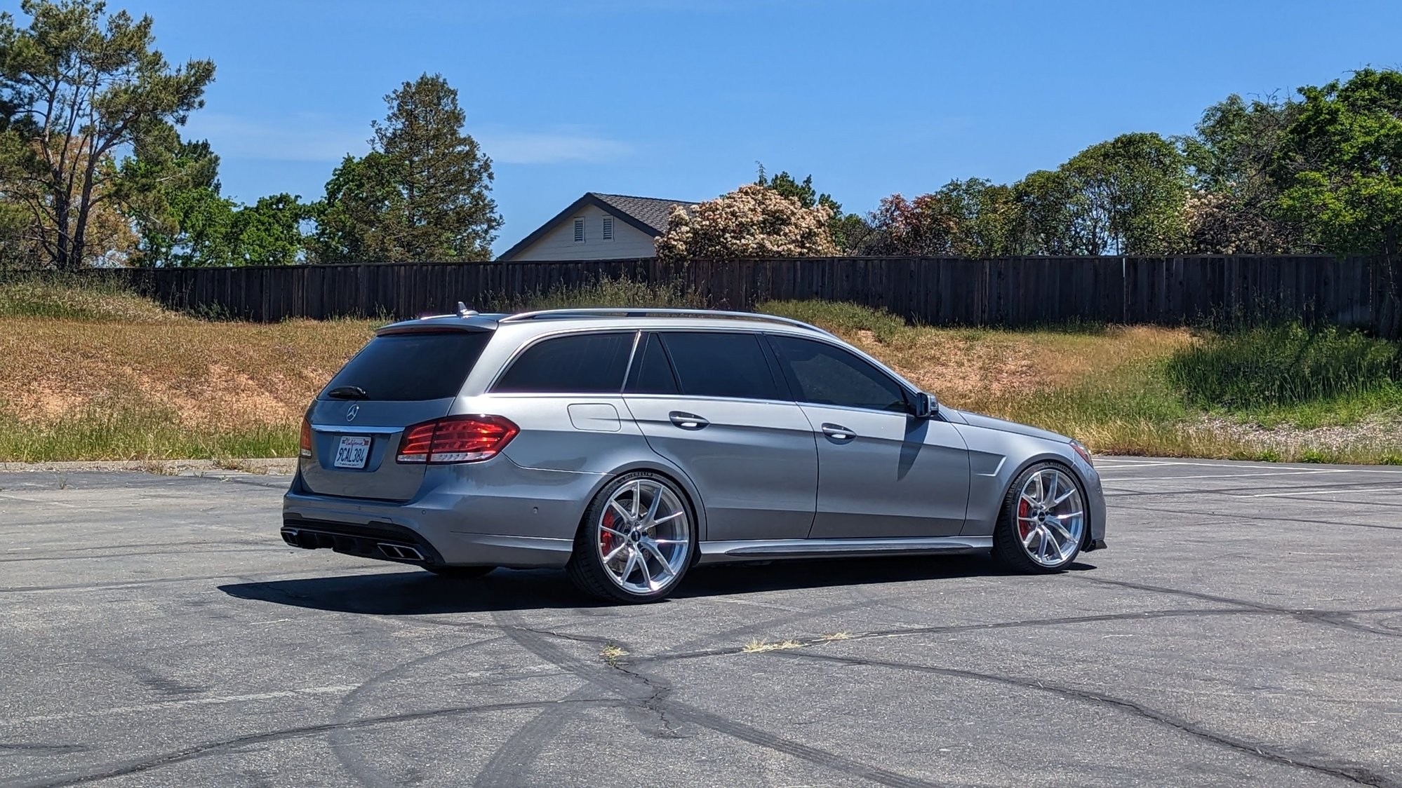

19x9.5+25 squared Apex VS5-RS. Front has 5mm spacer up front making it a +20 in order to run center caps. 265's all around

and here's some in 20" fitment
Is that actually your car? I saw those pictures with the clear silvers on their website.
And no rub? Looks like rears are close.
Thank you
Thank you
yes, this was my car. I worked with Apex to get some fitment options for our platform.
There was zero rub in the rear, no fender modifications at all.
What tire profile? 265/30 or 265/35 on these? Looks sharp btw
Old Aug 17, 2025 | 12:22 AM
ThreeSix's Avatar
Joined: Jul 2022
Posts: 32
Likes: 20
From: Danville, CA
G550
the tires were 265/35R19 Falken RT660, which run a bit wider than your typical Michelin Pilot Sport 4S in the same size
