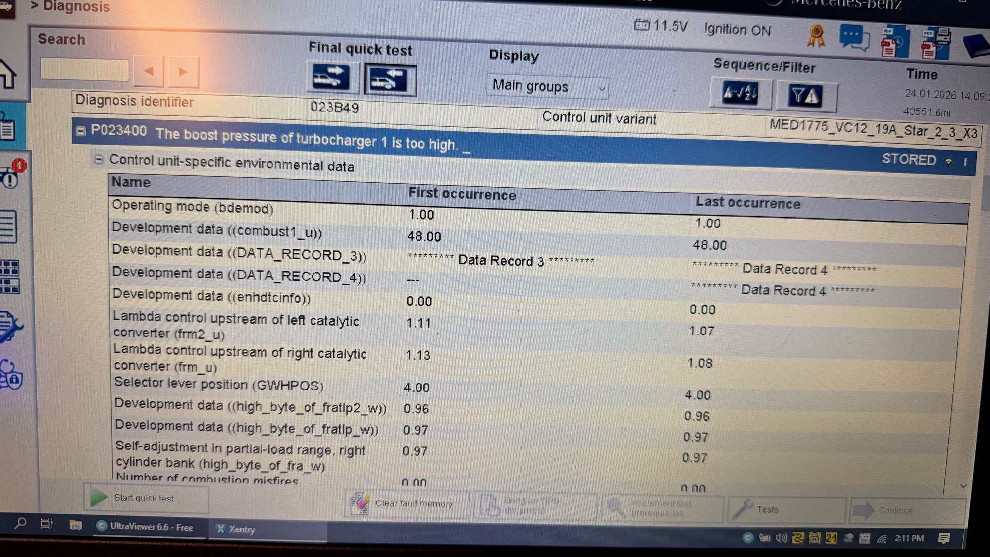

I know I’m spamming all these related threads - but question - can it be flaps if ALL boost is lost even below 4000 rpm? I have zero boost after freeway WOT until car off/on. Not just past 4000.
Old Jan 24, 2026 | 10:56 AM
  #97
MihneaMike's Avatar
Joined: Dec 2024
Yes that was for me the problem
yes that was the problem I had
Old Jan 24, 2026 | 10:57 AM
  #98
MihneaMike's Avatar
Joined: Dec 2024

The CEL just came on but I hope it’s unrelated as I got a 12V battery message at the same time. I’ll scan in a few and post it up. Battery is coming up on 3yrs old maybe I’ll just grab a new one before anything else.
Old Jan 24, 2026 | 08:38 PM
  #100
I.T. Guy's Avatar
Joined: Mar 2011
Posts: 2,503
Likes: 1,579
From: Canada
2023 E63S Wagon
Thank you @BenzNinja for your assistance today!
Quick scan shows P023400 The boost pressure of turbocharger 1 is too high.
Dealer appointment set for Tuesday morning!
