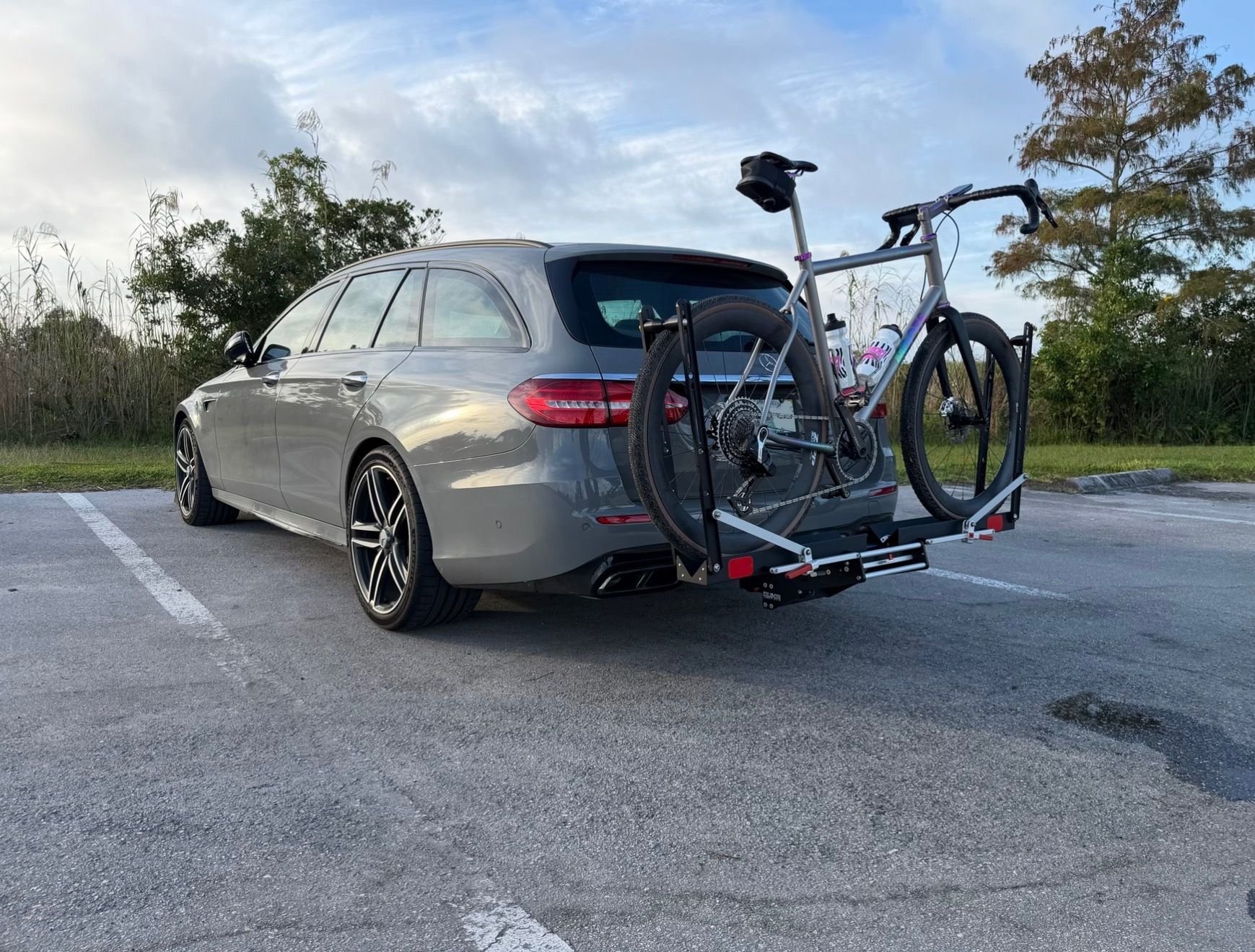

Old Nov 14, 2025 | 01:09 PM
  #55
b0rderman's Avatar
Joined: Feb 2019
Posts: 594
Likes: 308
From: South Florida
E63S Wagon
Added a stealth hitch...
