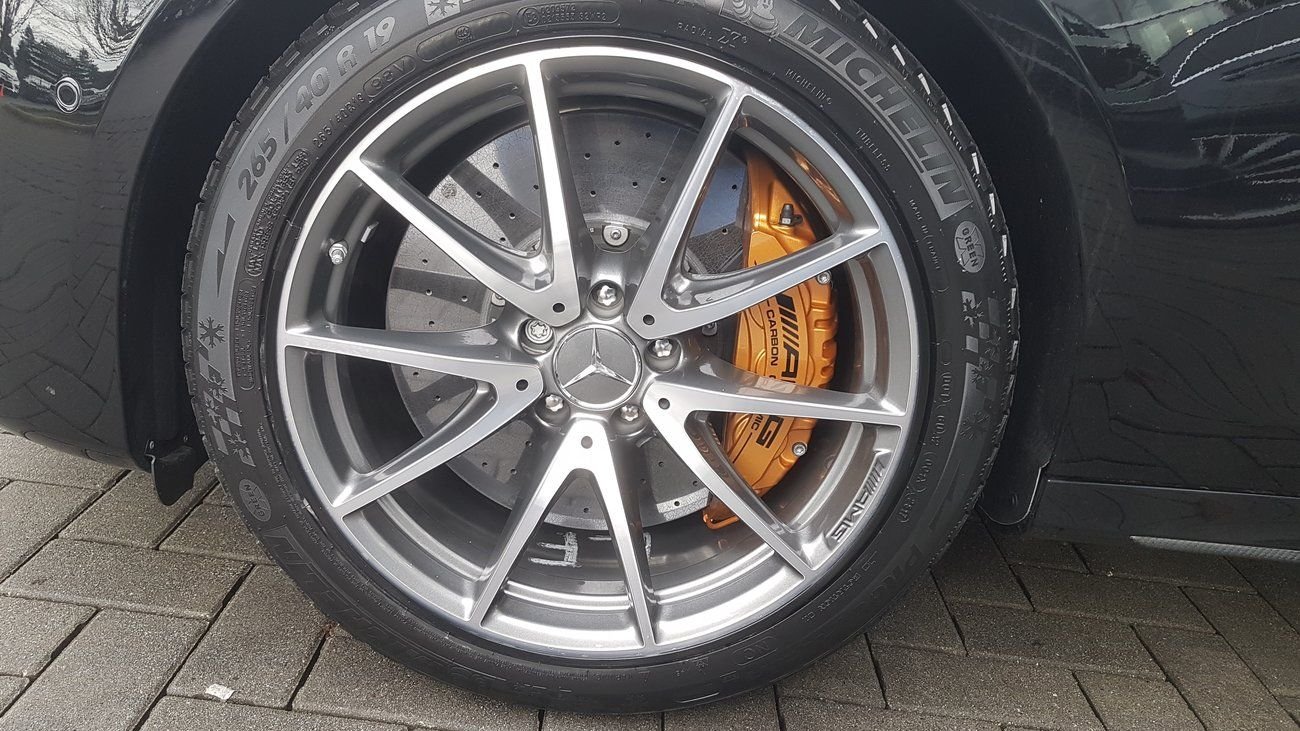

Likes: 35
AMG E63s
Originally Posted by Carac
The OEM winter tire 19s clear the CCBs.
@Carac Do you know for sure that 19 inch wheels can be used with CCBs and if so do you know the size of the OEM winter wheel package--any help would be appreciated. Also wondering how the E63s does in snow with proper snow tires.
Thanks
Thanks
Another user here posted pics of them clearing his CCBs a while back:
Old Oct 15, 2019 | 02:48 PM
amgliturbo's Avatar
Joined: Mar 2019
Posts: 90
Likes: 35
AMG E63s
Thanks Carac--this is helpful but the OEM wheels are pricey and I am not thrilled with the look of the OEM 19" wheels. I am wondering whether anyone has used any 19" non-OEM wheels with the CCBs for their snows. I wouldn't have thought that different 19" wheels had significantly different inner circumferences such that they would cause problems with the CCB discs/calipers but maybe I am wrong.

AMG E63s
Originally Posted by 24Hours
Unless you have the CCB... then only 20" will work
24Hours--I remember having read somewhere else on this forum that you need to use 20" wheels if you have CCBs, which I do, but Carac posted a pic of the OEM 19" wheel with CCBs--do you know whether the OEM wheel is different than most aftermarket wheels such that they will cause problems with the CCB disk or caliper?
Thanks
The front CCB's on the S/E/SL/GT models are all the same SL rotors and thus fit 19" wheels as shown on the pic from AMGliturbo. However, not every 19" wheel may fit based on inner barrel diameter/offsets. The E63s on dedicated snows drives like a tank. Here is our winter beater
