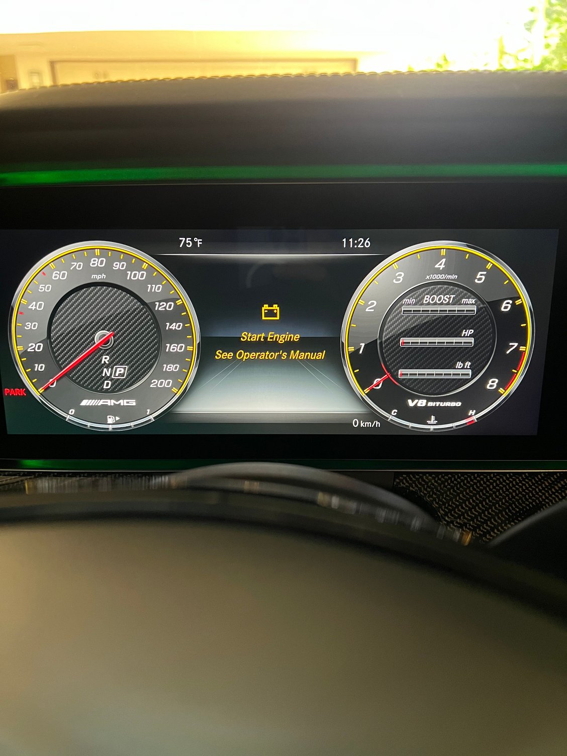

FWIW a weak/bad starter battery will cause the start/stop to not work.

FYI if youhave weak battery it will pop up on display
Not necessarily. The Start/Stop feature will stop working long before the "critical" battery notification comes up.
Yep what he said is exactly right! My Stop-start would not work the first 500-1000miles on the odometer because it sat for long periods of time. When I started driving it more, it started working again
