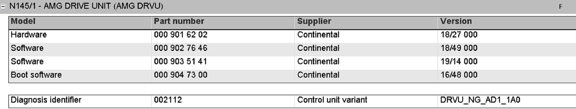

@Jphouston @adamp121 When you're next getting a service, can you request the Xentry Quick Test Log report? It'll list all the modules in your car, along with their hardware/software versions. It would really help in figuring out what specific changes have been applied to your car that help with the ride.
It'll contain a bunch of tables that look like this, containing module name, model, part number, supplier and version.
