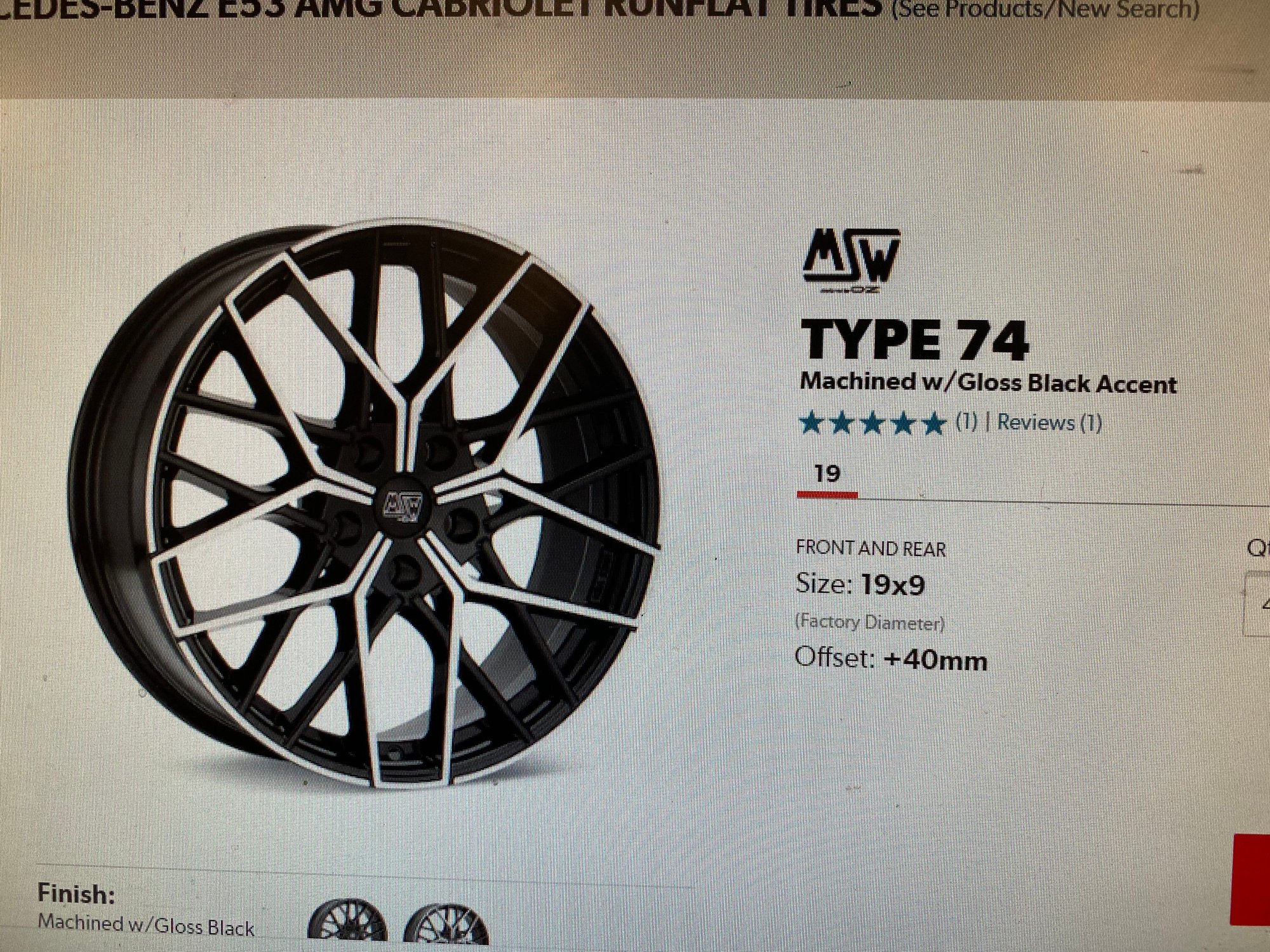

I've been looking at 19" rims with A/S tires to replace the 20" w/high performance summer tires. Can anyone tell me if ALUTEC or MSW produce good rims? Those are the two manufacturers that Tire Rack has whose rim designs I like and will fit on the car. I only see one review for MSW.
TIA

Msw wheels are related to OZ wheels of Italy. I would think they should have some good quality behind their wheels.
alutec wheels and Rial wheels merged in 1998 but they still made wheels under their respective brands today. Rial makes some quality oem wheels for Porsche (I believe, like 992 991)

I bought a set of MSW wheels for my 2015 650IX and put on dedicated snows. Ran that setup for 3 years, no problems.

I used MSW on my 2019 E53 last winter. Vredstein Wintrac Pro. These these were excellent. I also bought a set of MSW Type 74 ( a bit more complicated design then OEM, but they look deceptively similar.} with Michelin Pilot Sport AS$ for my car . Also 19 inch. Both I bought regular tires, not runflat. I just listed both sets on marketplace for sale. They fit perfect, but I used spacers because I wanted a bit more aggressive look. I live in NJ and it's a killer deal if you are close. Otherwise just look at the ad and the specs. I got all on Tirerack. One of the wheels is no longer available, but they have others. Watch the offset closely. I bought the spacers and lug nuts on line at 4wheelspacers.com. They sell just lug bolts as well. Front is an ET27 8x19. Rear is 9x19 ET40. Tires are 245/40/19 and 275/30/19. I did staggered as you can see as it was easiy wityh the offset of these staggered sizes and I did not care about rotating etc. These balanced very well and are fine quality. of course they are made in China like all but the high end wheels. I could not justify the cost ( for me) using real AMG wheels for winter.
