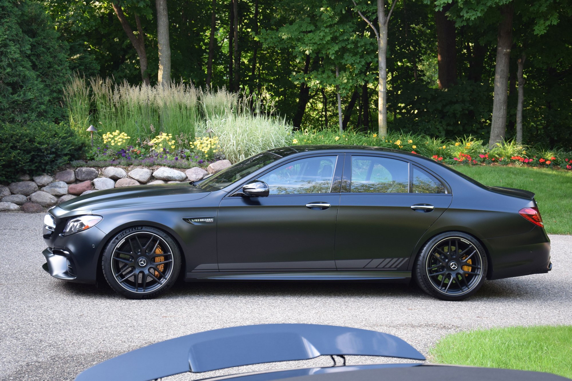

Our old Renntech ELM was raising to stock height at a speed one can set. Default was 35mph. Worked great no alignment was ever needed and virtually all tire wear occurs at speed (always used spacers). Great feature. But at the same time our E63s was great with a permanent drop and spacers as well. Even tire wear. Go figure...
Hi Wolfman, just picked up an ED1 myself last week and wanted to ask what lowering module and width of spacers did you go with? 15mm/12mm? My concern was tire wear myself, so if you had no issues with your setup, I’m all ears! Thank you in advance!
Definitely worked better than expected. Supreme Power spacers were the ones to get in 2018 (15mm fronts and 12mm rears), so I would check them out or H&R which we have used for everything else. We got one of the early OBD2 lowering modules that the guy in Belarus did (via Ebay). Did the job for $350 but am not crazy for the VIN locking.
It now collects dust in the garage

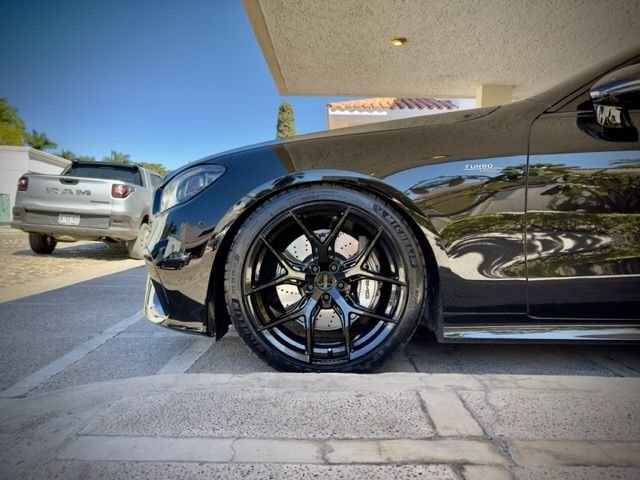

Originally Posted by IsmaGlez
I have an AMG E Class 2022 and I can say I’m 100% happy with the MWMODS 20-30mm dongle. Incredibly easy and fully reversible.
Is this pic in comfort or sport + ?
