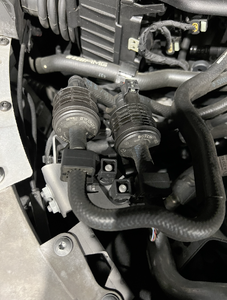

Thought I will share a quick fix for something pretty annoying; ticking noise (similar to a breaker clicking fast on and off), based on my research it exists in a lot of the M177 engines.
The noise comes from a failed Purge Valve, sits in the driver side of the engine bay right behind the headlight (see picture), the valves can fail but not enough to through a code. What you will hear is a fast ticking noise typically in idle, very annoying for sitting at a light, or talking with some friends outside the car and having it constantly tick. Also, notices the auto start stop function started working again once I replaced the part, not that anyone cares about gas mileage with those cars haha
Part Number: 213-470-69-01-64 (link: https://mbparts.mbusa.com/oem-parts/...e-213470690164) Might be different for other 63 vehicles.

this ticking question gets posted all the time, and everyone says its normal... so is it not normal?
Old Mar 19, 2024 | 12:38 PM
mack1ro's Avatar
Joined: Feb 2010
Posts: 117
Likes: 32
From: USA
W213s
It is normal.

Is this excessive or normal? I never noticed it this loud before. Even my family asked what’s up.
Old Jun 29, 2025 | 07:27 PM
bobblehead's Avatar
Joined: Jul 2013
Posts: 2,591
Likes: 809
From: Toronto, Ont, Canda
go fast grocery getter wagon
Too loud

did you do a DIY on this? If so can you offer more details please?
They hit this topic in 2019, it's in the sticky as well, just to add to the discussion here:
https://mbworld.org/forums/w213-amg/...ing-noise.html
the noise will come back, many dealers will just say "normal" and move along
post #9:
https://mbworld.org/forums/w213-amg/...ml#post8999472

Same as what I experienced, I ordered the part and had my independent shop replace it. I cannot recall how much it was but couple hundred $, noise has not come back yet but people say it will so I guess couple hundred bucks every few years haha.

Agree with others, that is on the loud side, unless you have a great mic on the recording device

Fixed under warranty today
"Although no faults present, deemed purge valves faluty due to excessive noise. Removed and repalced purge valves. Noise reduced"
QTY 2
004-997-20-90 Hose Clamp
QTY 1
213-470-69-01-64 Purge Valve
Also see Purge valve loud ticking noise - MBWorld.org Forums

I always wondered what caused this sound (I had it in my W212 E550 since I can remember), and I just replaced my purge valve and noticed it's gone. It also elimated a rough idle I've had for ages that I could never track down the source of. It just recently caused a check engine light (it was stuck open). I picked up the part for under $15 on Aliexpres shipped (for the W212 E550) and had it installed in under 10 minutes.
