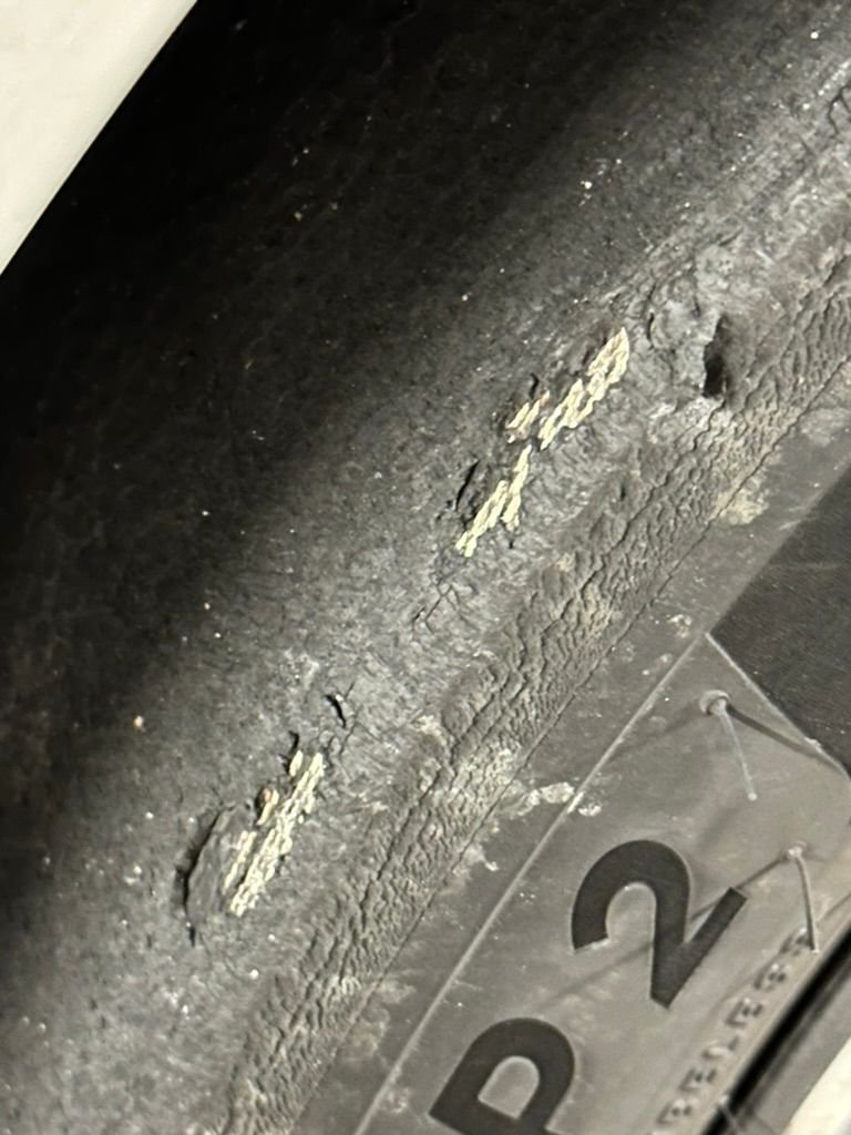

I have stock camber (~2deg) on front and can eat through the outer side of Michelin CUP2R in under an hour, apparently regardless of the pressure (attached pic after an hour of pushing it somewhat hard, cold pressure ~2.5bar, hot ~3.2). Even the stock P Zeros lasted significantly longer (~2.8 cold pressure ate through the center while keeping the sides relatively pristine). Next spring I'm thinking I'd give a chance to PS4S/5S.

@vydra In my track experience many years ago, street tire shoulders die in just a few hours of full-on track use, even on lighter cars. Your picture looks quite familiar. I remember little ***** of rubber piled up across the tire. If PR lap times are what matters, tires die in just a few laps. It's an expensive hobby.

Absolutely, it's just that CUP2 Rs seem to die really fast, compared to PS4S (on a friend's E63S with the same pressures) or P Zero, so I'm wondering if the compound is that soft or if I'm doing something wrong (toe, pressure, idk).
Especially since there is usually still loads of tread remaining in the center and on the inside edge with CUP2 R. I even tried taking the right-hand turns a bit more slowly to preserve the left-front tire, + even driving in drift mode to put a little less pressure on the front overall and I can still make that picture happen in under an hour lol. Destroyed CUP2 Rs are starting to pile up in my garage 😅

Wouldn't adding more negative camber extend the life of the tires?
I assume so, but I’d need to get aftermarket arms as the stock ones are not adjustable (idk if I trust camber plates/bolts lol). I might do that eventually too, but want to keep the car mostly stock.

YES HARD TO BELIEVE EVEN A PRESTIGE AMG “PERFORMANCE” MODEL - THERE'S NO CAMBER (OR CASTER) ADJUSTMENT OEM !
BACKGROUND:
IT IS ALL TO DO WITH COST CUTTING AND EVER INCREASING SPEED OF NEW CAR ASSEMBLY LINES. Camber is now “preset to suit only showroom height conditions”. Stopping to adjust / set Camber on the production line IS NO LONGER AN OPTION.
THE OFTEN QUOTED / REASSURING “Full ‘4’ Wheel Alignment” is now only basic TOE “DIRECTIONAL” ADJUSTMENT ! New car industry’s best kept secret.
PUTTING ONUS “BACK ON OWNERS” - TO FUND COSTLY, PREMATURE TIRE REPLACEMENT.
EITHER THROUGH TRACK DAYS - Not being able to “DIAL IN EXTRA NEG. CAMBER” - to significantly REDUCE UNDERSTEER !
…..IN THE ENDEAVOUR TO HIT THOSE CORNER APEXES EVERY TIME AND GO “DEEPER INTO THE CORNERS” - WITH INCREASED TRACTION AND BRAKING RESPONSE.
OR JUST HAVING “ONGOING ADJUSTMENT CAPABILITY” - TO CATER FOR DAY TO DAY COMMUTING encountering high cambered roads with excess passengers side edge wear, or having excess edge wear on both sides through altered height / excess passenger loads or lowering. Plus adjustment to cater for curb knock damage (excess edge load can also lead to ruptured side walls and rim damage).
