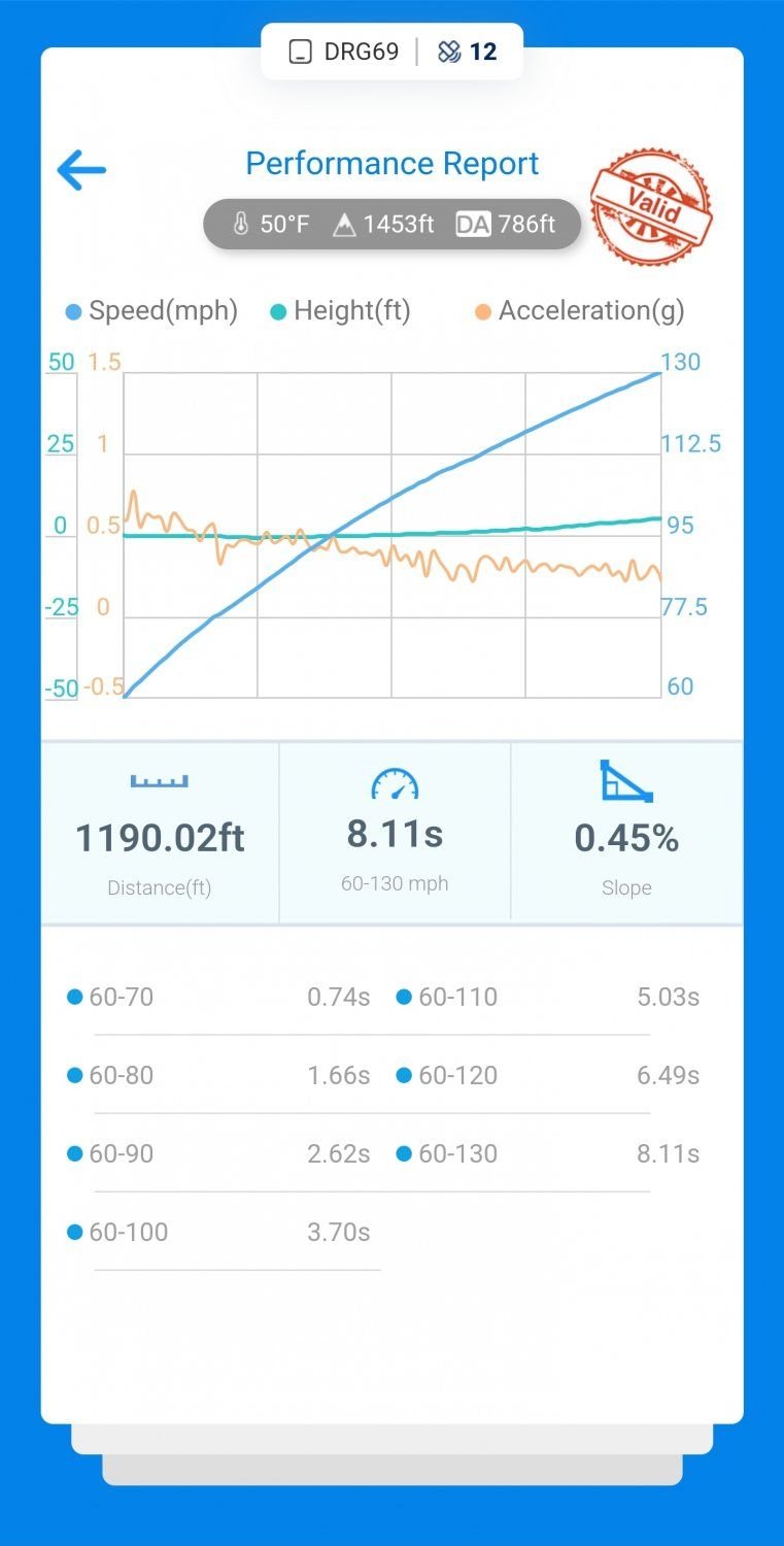

So went back out tonight. It is coldish here in Phoenix, but the DA was the best I have seen yet. I set my tires to Mercedes recommended psi. 41 psi front and 33 psi rear while they were cold.
I roughly had 4 gallons of 91 octane in the tank. I added two gallons of Sunoco 100 octane. Octane calculator calls it 94 octane.
I went on a 10 mile drive like I do every time to get the trans and oil temps up. Went to my normal spot.
It spun about 100 feet out. The 4Matic + gathered it up quickly but almost 2 tenths slower 0 to 60.
60 foot was 1 tenth slower, 1/8 mile was .15 slower but best mph, and the elapsed time was slower by one tenth. PR for mph. If it went what it does normally, that
pass is a low 10.80 pass.
I believe it would have been a low 10.80 pass because it picked up .36 tenths 60 to 130. I almost made it back up on the big end. It just goes to show how important short times are in regard to Elapsed Time.
Couple of other observations. Usually when I run my passes it has been in the low 60's for temp and my tire temps are in the low 100's. Tonight it was 50 degrees and my tires temps were in the low 80's. Most of my passes have been with roughly a 1/2 tank of fuel. Tonight it was roughly a 1/4 tank of fuel.
My thoughts. I have good inclinations that it is making more power. Better fuel, colder temps, and good DA. Usually it spins 200 feet out. I think it spun 100 feet out tonight. To pick up .36 tenths from the 60 to 130 is a big deal. The tuner said it would run harder with 93/94 octane...boy was he right. I also think having less fuel in the car hurt the short time as well.

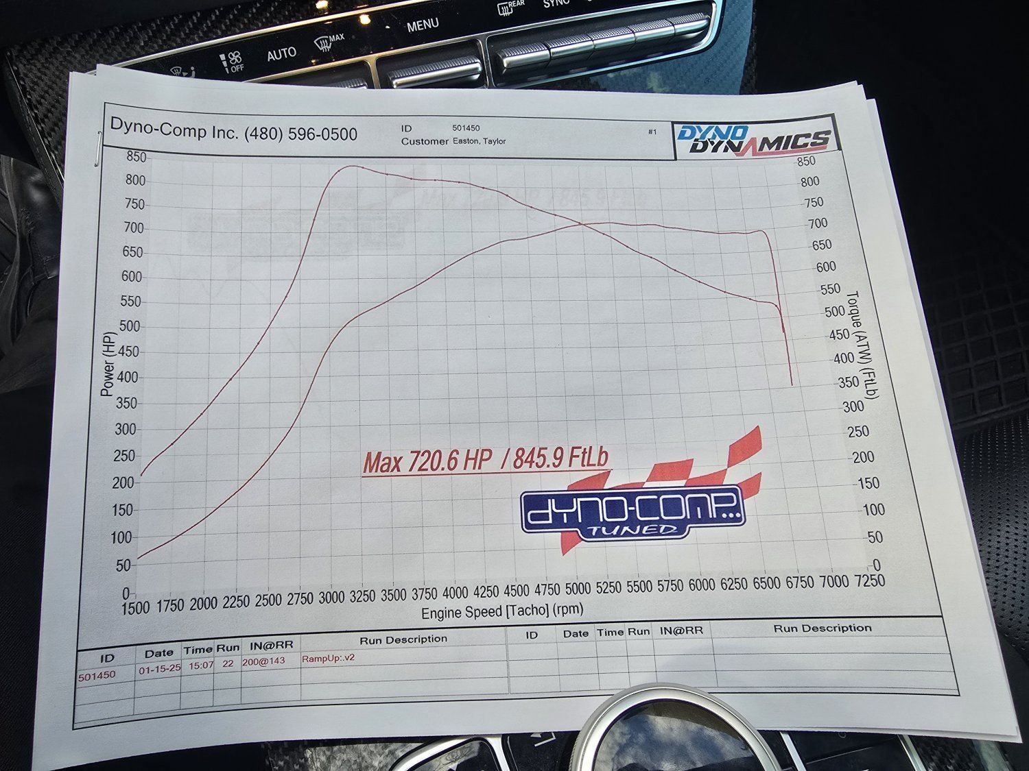

Spool Performance Pumps in and the car is retuned.
Numbers for now. Remember, I am in Arizona and we only have 91 octane here.
Probably early next week, I will go and take her out for some new dragy numbers. I am out of town this weekend.

Thank you for the follow up. So many great threads like this go dead before the money shot.
This is awesome data.

Any best estimate on what you’ll run down the 1320? That’s too bad on what octane you guys have out there.
Good Numbers

Yeah over 700 on 91 is pretty stout

The pumps should make a difference, splash in like 3 gallons of E85 with your 91 whenever you fill up to help.
those 60-130 times for ecu/tcu/cpc are a bit slow IMO. When i was only stage 2 (catless dps, intake. Stock pumps and stock turbos) on ecu/tcu/cpc my car was doing 7.2 60-130 on 93 octane.
The pumps did help. I only drove the car a couple of hours, before I took it back to Dyno Comp for a tune revision. However, the mid range really woke up. 845 ft lbs will do that. This is Dyno Comps first time tuning the Spool Pumps. They were only a PTG dealer, and they were willing to work with me. So I knew tune revisions would be on the docket because of a new product. The throttle tip in was pretty sensitive, and the car was long cranking. I guess some Spool pumps have a problem with pressure bleed off. Dyno Comp is it contact with Spool to figure out a solution.
The 8.11 sec 60 to 130 was ecu, cpc, and tcu only. I never got a chance to run the car with the catless downpipe revision. I would hope that it would gone a 7.75 ish. However, we will never know. I actually have a uncracked 55 gallon drum of Torco T-85 sitting in my garage just for what you said. 91 is a real power killer, and I want the E for knock control when it gets 115+ degrees here in Phoenix for the summer.
