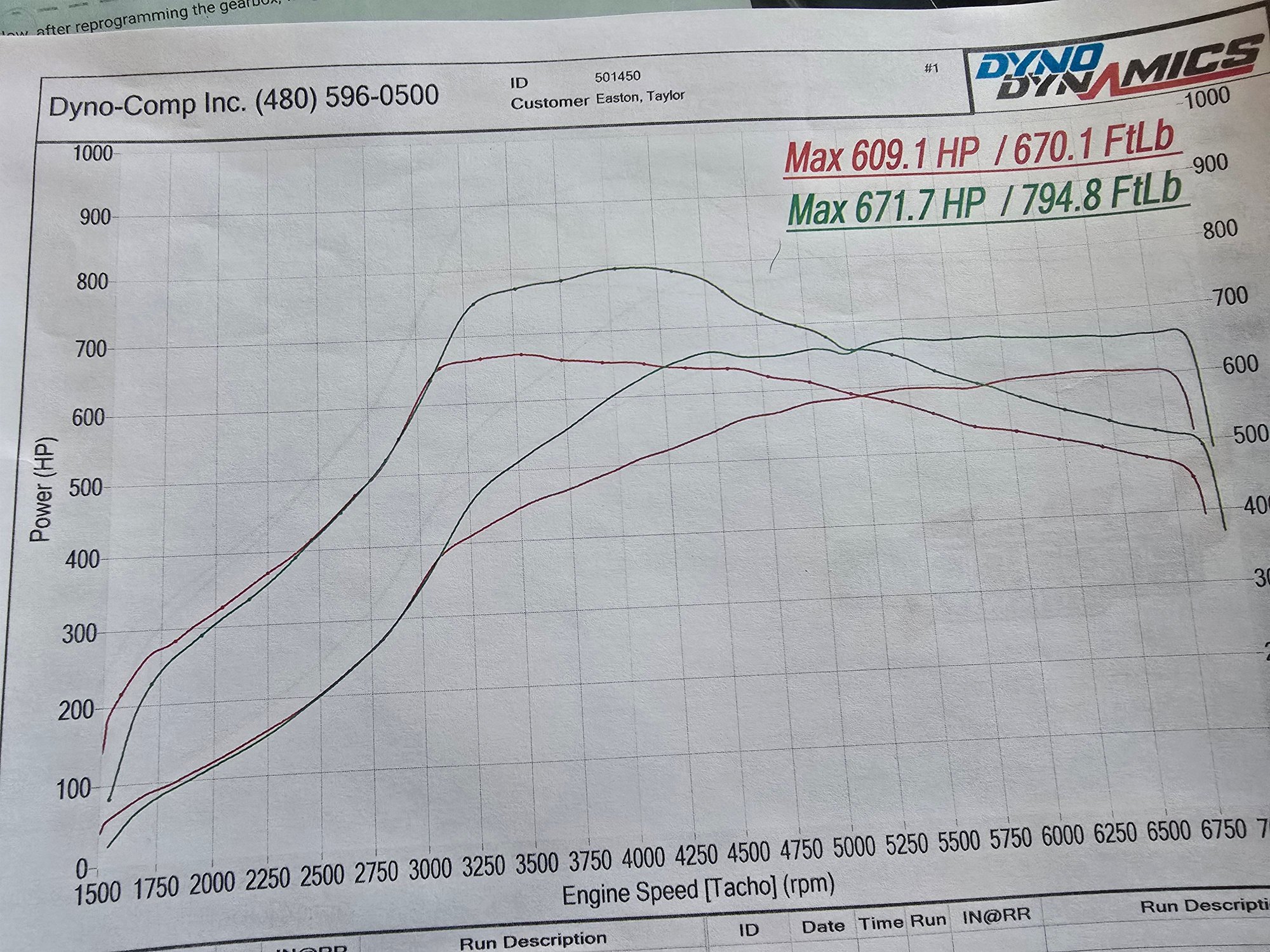

Here is the Dyno sheet with the Dyno Comp ECU and TCU tune before and after. 91 Octane and BMC drop in filters. I guess you can really see where the CPC put the limits to power production on the dyno chart. HP pick up was nice, but the TQ is the really noticeable esp down low and mid range.

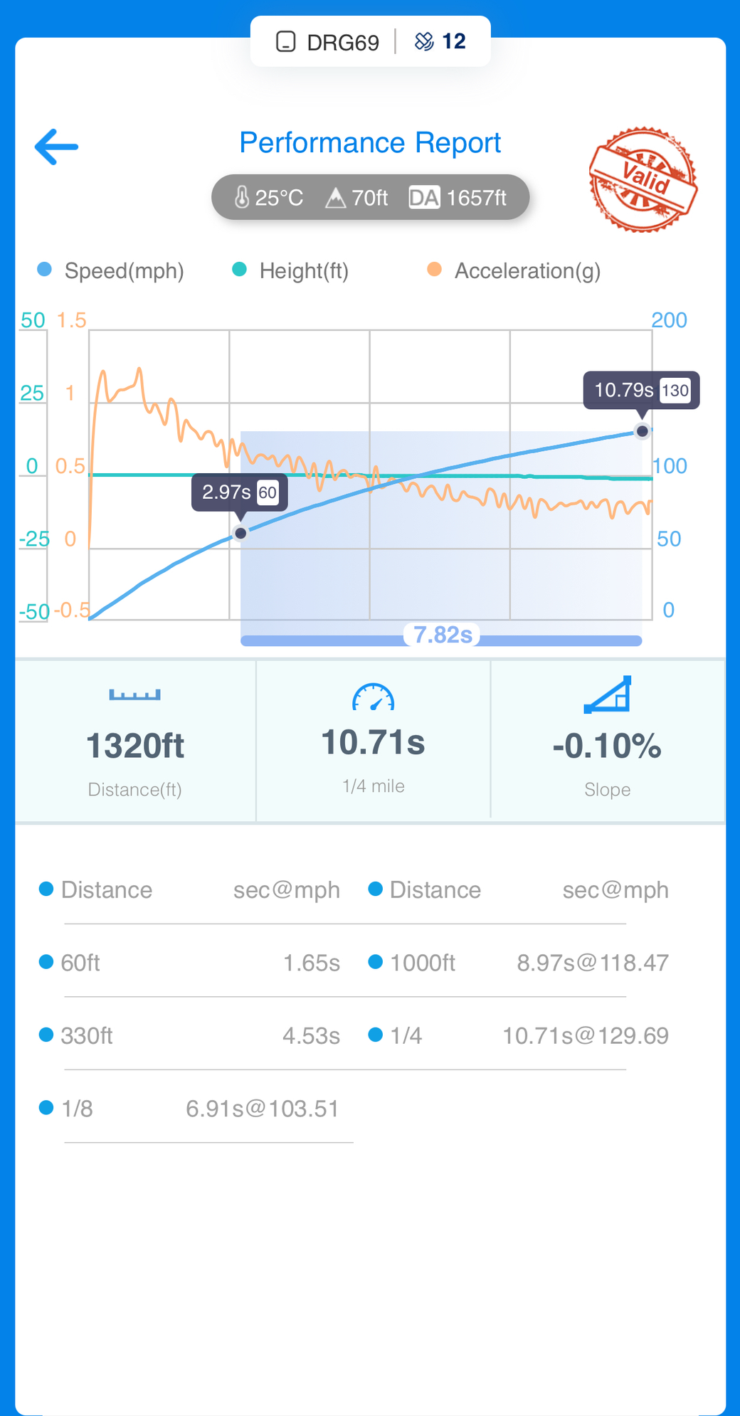

I'm stage 2 full FBO, 93 fuel and on Michelin AS4 all seasons, i'm hitting 2.9s 0-60 and 10.72 1/4, 129 trap . AMR Tuned w/ cpc and tcu.

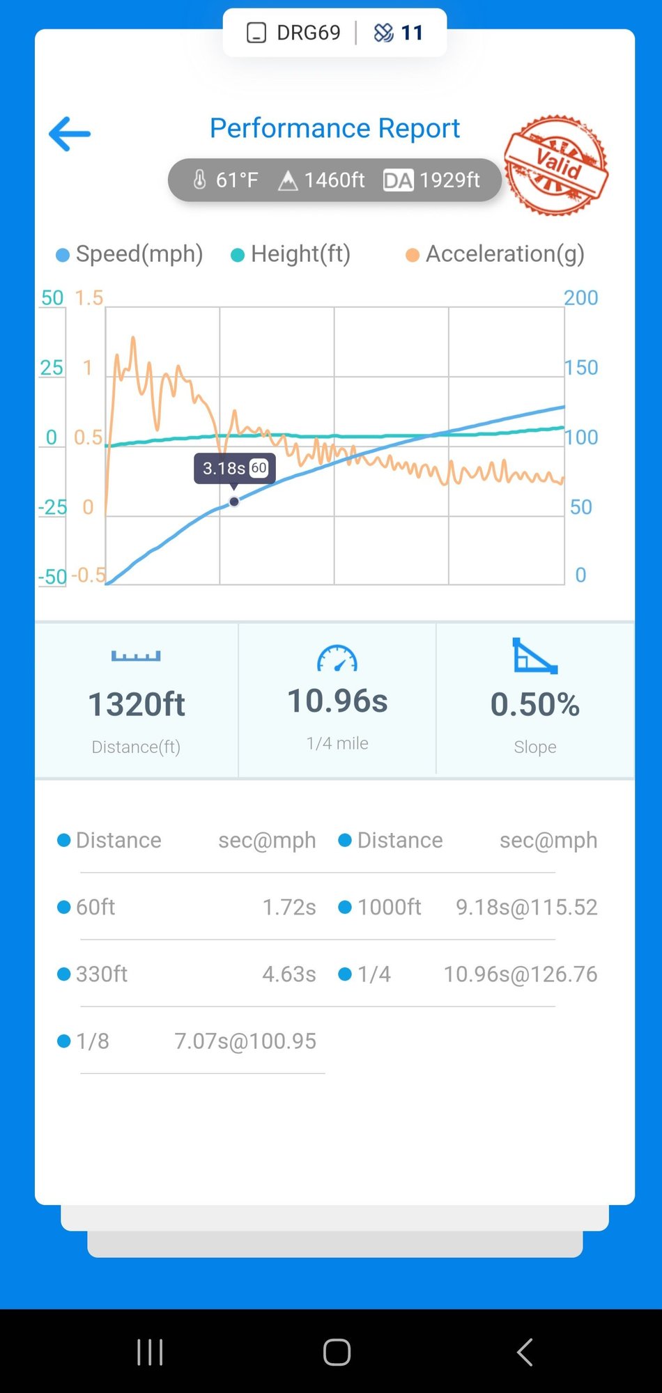

New numbers. Car went a 10.96 on the same crappy street with 36 psi in the tires squared. This was roughly 50 miles after the tuned CPC was installed. The car launches great, but about 200 feet out...it spins pretty violent before the 4matic + gathers it back up. Not a complaint, just an observation. However, the CPC did knock another 2 tenths off the 0 to 60, 2 tenths off the 1/4 mile, and 2 tenths off the 60 to 130. I am pretty happy to say the least.

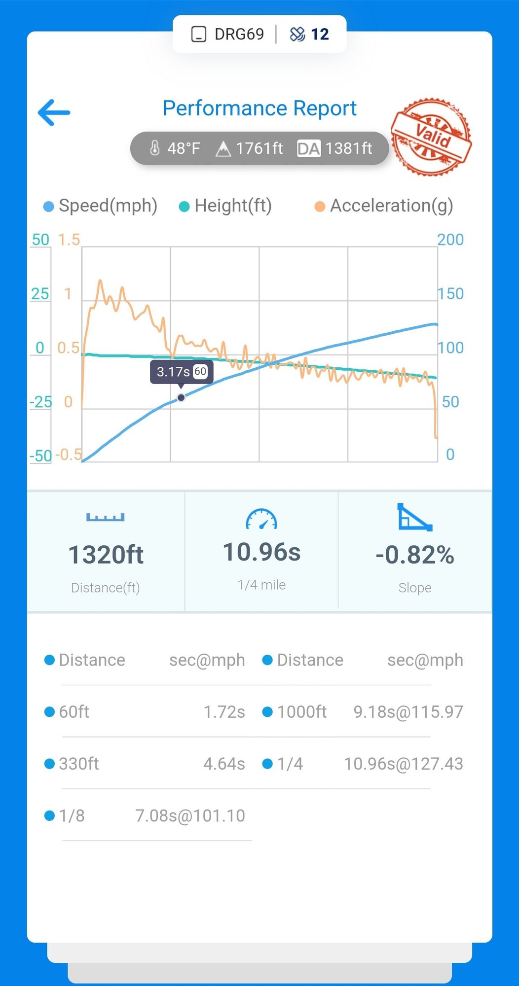

Over the next couple of days I put another 60 miles on the car. Before these runs I put the tires at Mercedes recommended psi. 41 psi in the front, and 33 psi in the rear. I then went to another street and the car backed up the quarter mile time. Damn thing could be a bracket car. Usually on the 60 to 130 I run the car out to 135+, but on this road I wasn't comfortable doing that, hence no 60 to 130 pull.

By no means am I disappointed or upset about these numbers. However, there is always a way to optimize what I have.
My future immediate plans are to add some Sunoco unleaded 100 to the craptastic 91 octane here in Az. Tuner said that getting the octane to the 93/94 octane level will allow the car to pick up even more. So back to the crappy road soon with the 93/94 octane mix to see if the big end picks up.
The Pilot 4s on my car are fairly new. However, even with a 1.72 sixty foot, it feels like it spins pretty hard around the 200 foot mark on the crappy road and the good road. A 3.16 is the best I have ever had 0 to 60. Yet I see people post 2.90 and 3.00's regularly on the same tire. What are you guys running for air pressure? I am not opposed to putting a drag radial on the car.
I know my DA isn't the greatest, the 1381 is the best I have seen so far. So I will just have to deal with that.

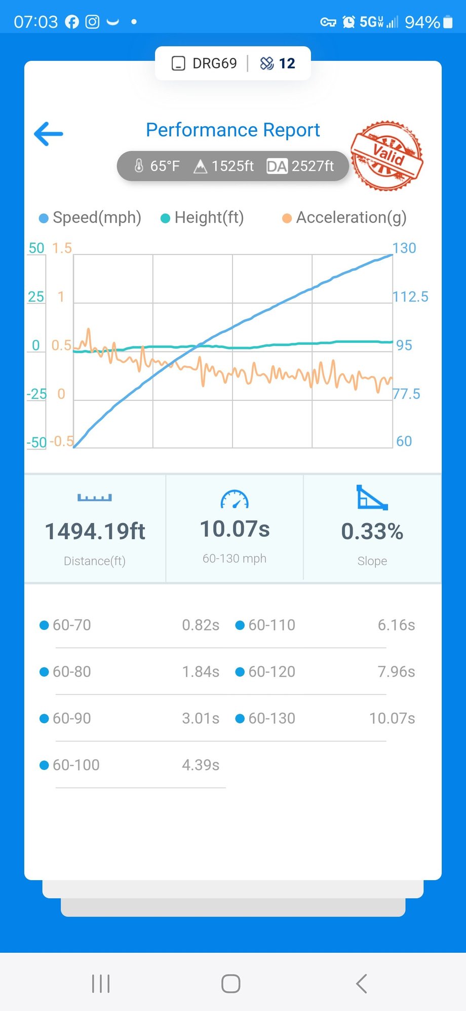

I could not agree more, empirical data is what counts. As a data point for you, here are the numbers I obtained after my AMR ECU/TCU/CPC Stage 1 tune. I was running 93 Octane and on PS4s. My DA was a little worse than yours and your run had slightly more favourable gradient.
