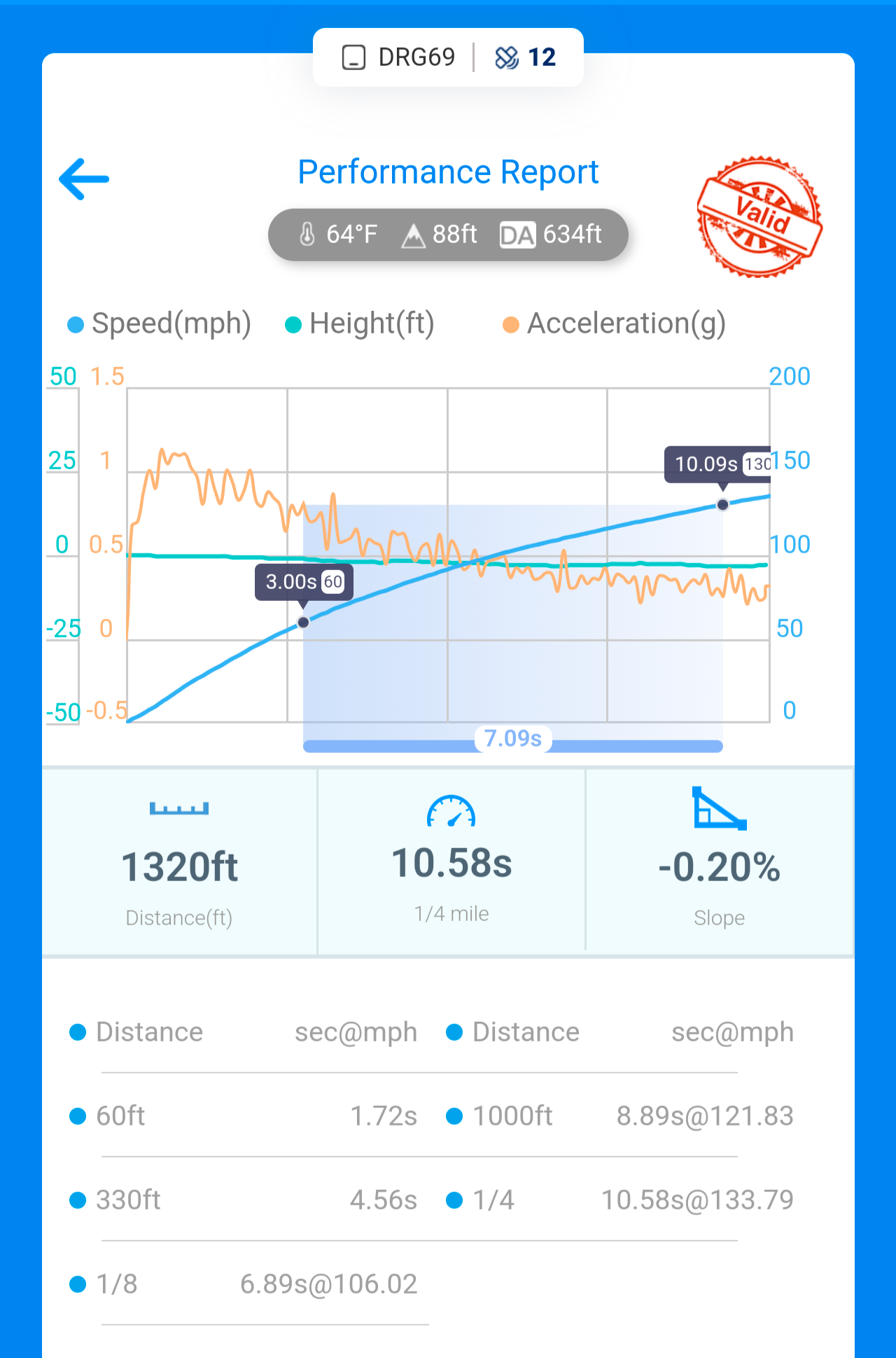

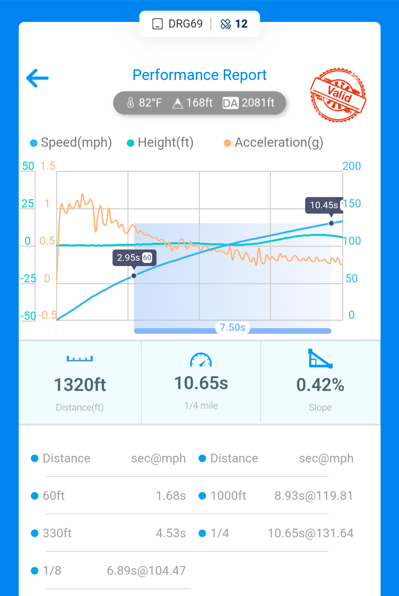

That torque is insane! I bet there a lot of torque management and traction control management happening even with your TCU tune.
This reminds me of my W212 tunes that didn't really go much faster than stock (felt waay faster though). For my W213 tune, I asked my tuner to reduce the torque to as low as I could get while not compromising HP.
I think it worked:
higher DA
higher DA
The DA was insanely good though lol
Pretty average
Pretty average
These were all on different days and sometimes months apart. But the mods were about the same (except TCU tune, switched from ECC to Edok)

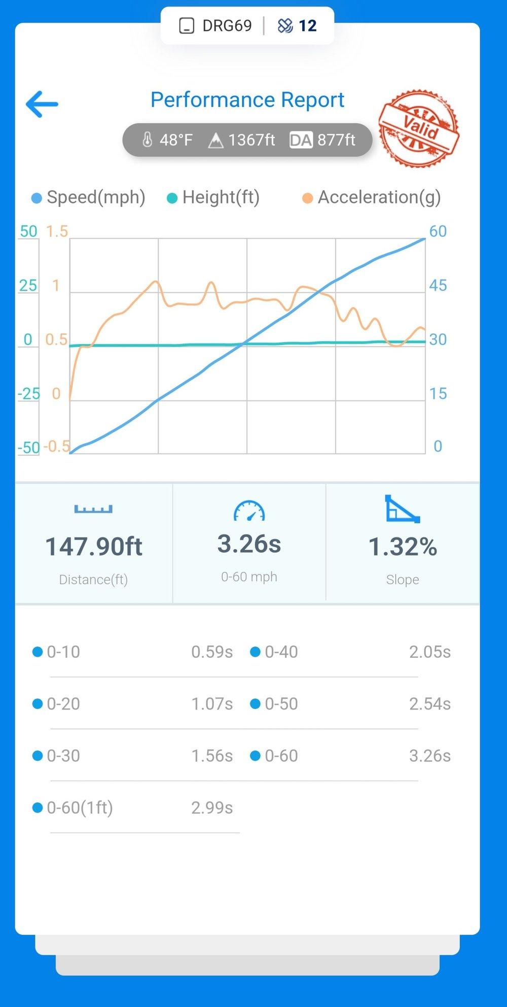

Here are a couple more dragy pulls as the car sits currently.
Still struggling with the 0 to 60 times. The best I have gotten was 3.17. This one at 3.26 was in race mode, full stiff suspension, traction off, PS4's at recommended MB tire pressures. I did what @kponti said " I would activate racestart and launch the moment racestart flashes on the screen. Do not allow the car to build boost at all!!!" With almost 850 tq and 48 degree pavement this was the best I could get. I am sure that with more seat time, I will get this number down.

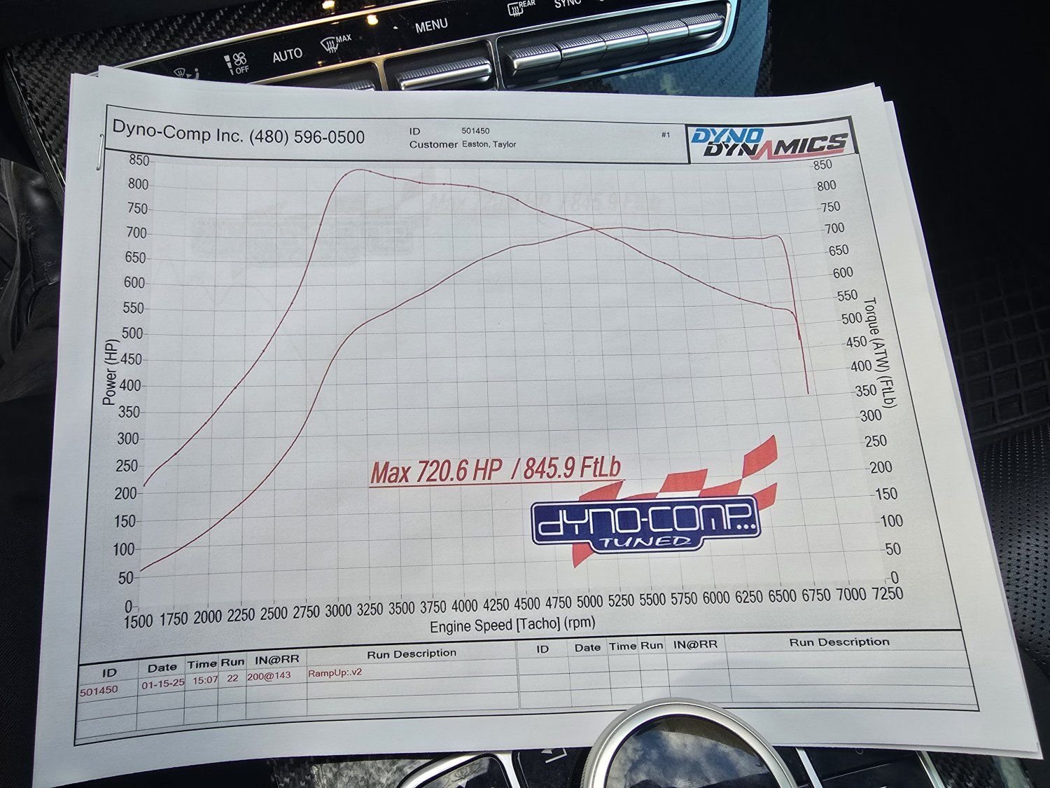

Let me clarify my 50 to 70 foot out comment. I will use the dyno sheets to explain what I am feeling now.
At this power level (this was before downpipes and HPFPs) the tq ramps up hard around 3000 rpm and peak tq is around 4100 rpm . I would hold the race start, build boost, and the car went a 1.72 sixty foot to a 3.17s 0 to 60 pull as pictured below.
The motor is producing TQ further out in the RPM. That little delay helps apply power smoother which nets the quicker time. It also allow the car to get up to speed faster through the 1/8 mile, just like your e63s. The difference is you have the HP to carry the big end.
After I installed the catless DP's I took it back to Dyno Comp for a re tune. This was dyno graph. Remember all that was changed was the downpipes.
On the pull the tuner noticed it went lean and got out of it early. However look what happened to the TQ before he aborted the dyno run. It ramped up fast (like diesel fast) and moved peak TQ 1000 rpm earlier. They turned the car down to the be safe, and that day I ordered fuel pumps. I never went out and ran the combo at the 671/752 power level. That was a week before Christmas, and in hind sight I wish I had.
Now with all of the mods in my sig it did this.
TQ ramps hard and peak tq is at 3150 rpm.
Before I did your launch, I did a regular boosted launch and it immediately and violently knocked the tires off and went zero to 60 in like 3.9 seconds.
Using your advice launching and not building boost the car is very manageable. It launches great and tame but most importantly it gives the tire just that little more time 50 ish feet or so before it is subjected to 850 ft lbs and begging for dear life.
I think on the PS4, If I launch like you told me, but back out of the throttle just a tad around the 60 foot mark to calm things and quickly get back it in it.....it should go faster. I just need to be a better driver honestly.
Or if I struggle enough....just add octane and make it up on the big end. lol
