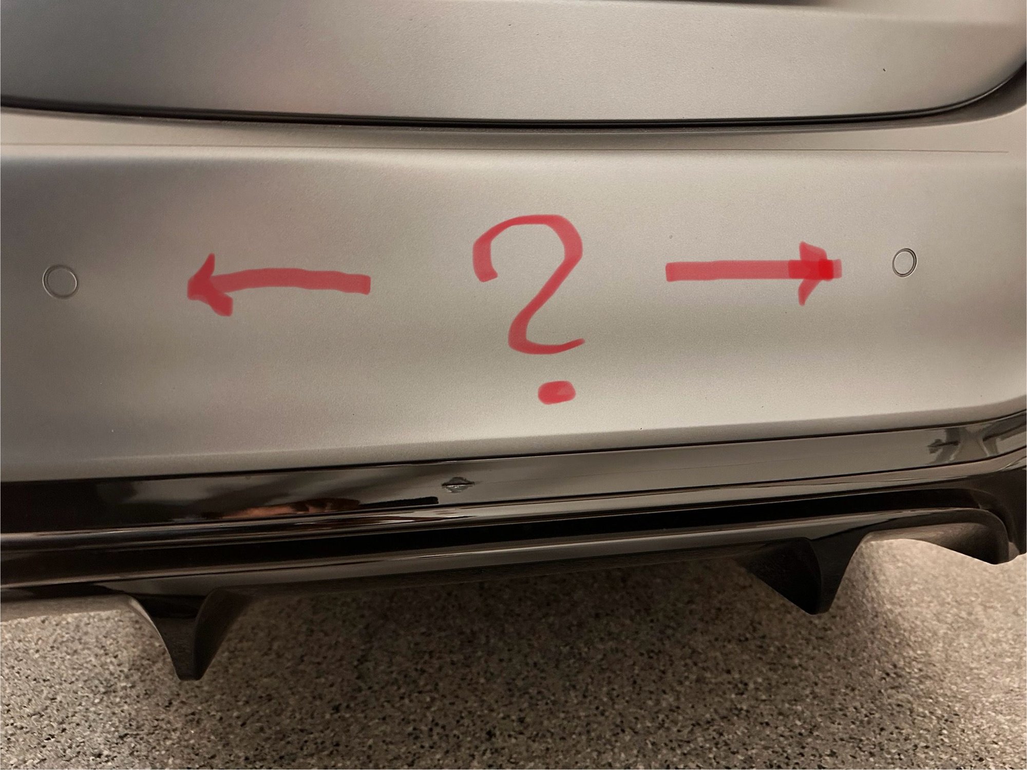

Two rear facing cameras in the bumper? What are those?
Old Dec 23, 2024 | 09:26 PM
  #31
6G Schnell's Avatar
Joined: Feb 2010
Posts: 1,197
Likes: 268
From: North CA
2021 E63S and 2025 GT63
W213 rear bumper
Old Dec 23, 2024 | 10:05 PM
  #32
wildta's Avatar
Joined: Jan 2023
Posts: 3,087
Likes: 1,186
GLE 580
Originally Posted by 6G Schnell
W213 rear bumper
Those are distance sensors.
Old Dec 24, 2024 | 12:56 AM
  #33
6G Schnell's Avatar
Joined: Feb 2010
Posts: 1,197
Likes: 268
From: North CA
Yes, there are no cameras in the rear bumper!
My mistake, I see now . You were posting in response to the other person to show them. I thought you were questioning what they were because of the question mark in your picture.

So how does the kicking motion actually work? I mistakenly used the word "camera" when I meant the little round sensors that @6G Schnell posted. (camera is the device that is hiding above the license plate). But I'm still unclear what devices sense the kicking motion. Also not clear what the 871 SENSORS FOR TRUNK LID OPENING/CLOSING actually is. Additional hardware? Software/configuration only?

So how does the kicking motion actually work? I mistakenly used the word "camera" when I meant the little round sensors that @6G Schnell posted. (camera is the device that is hiding above the license plate). But I'm still unclear what devices senses the kicking motion. Also not clear what the 871 SENSORS FOR TRUNK LID OPENING/CLOSING actually is. Additional hardware? Software/configuration only?
Oh you meant the sensors, I see, that makes sense. As for how it works it senses an obstacle (in this case, your foot) as part 1 and when you remove it then it activates the tailgate as part 2.
