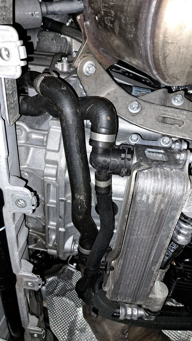

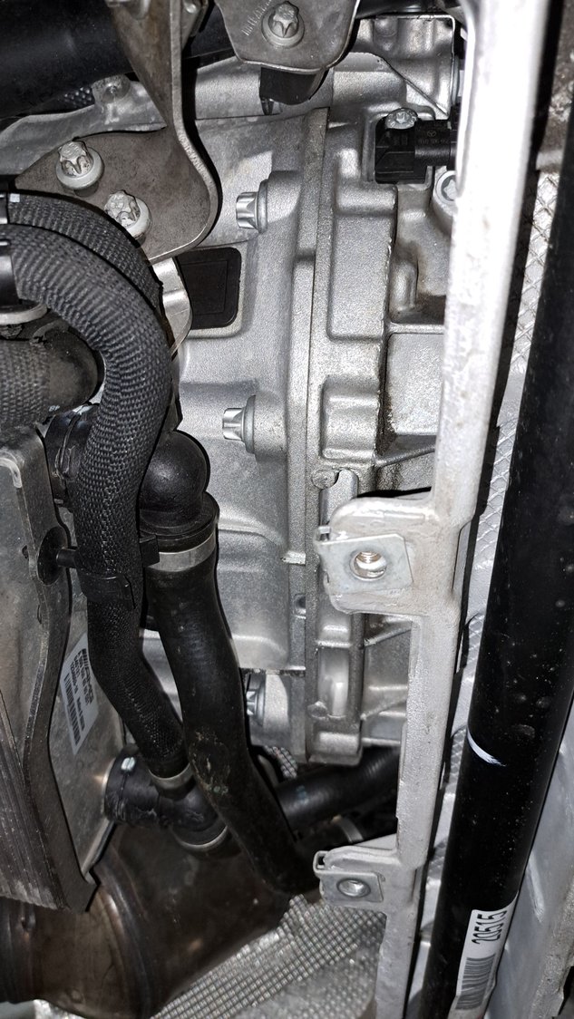

Update 8k miles and 4.5 months post-OVS-replacement: wagon was in the shop (GMP Performance South Atlanta, same shop that did my OVS work) for a coolant leak and I had them inspect the area around the RMS to check for an signs of an active oil leak - area was dry, no oil present.

RMS inspection during oil change. Still looks dry. 2021 E63S, 36k miles
