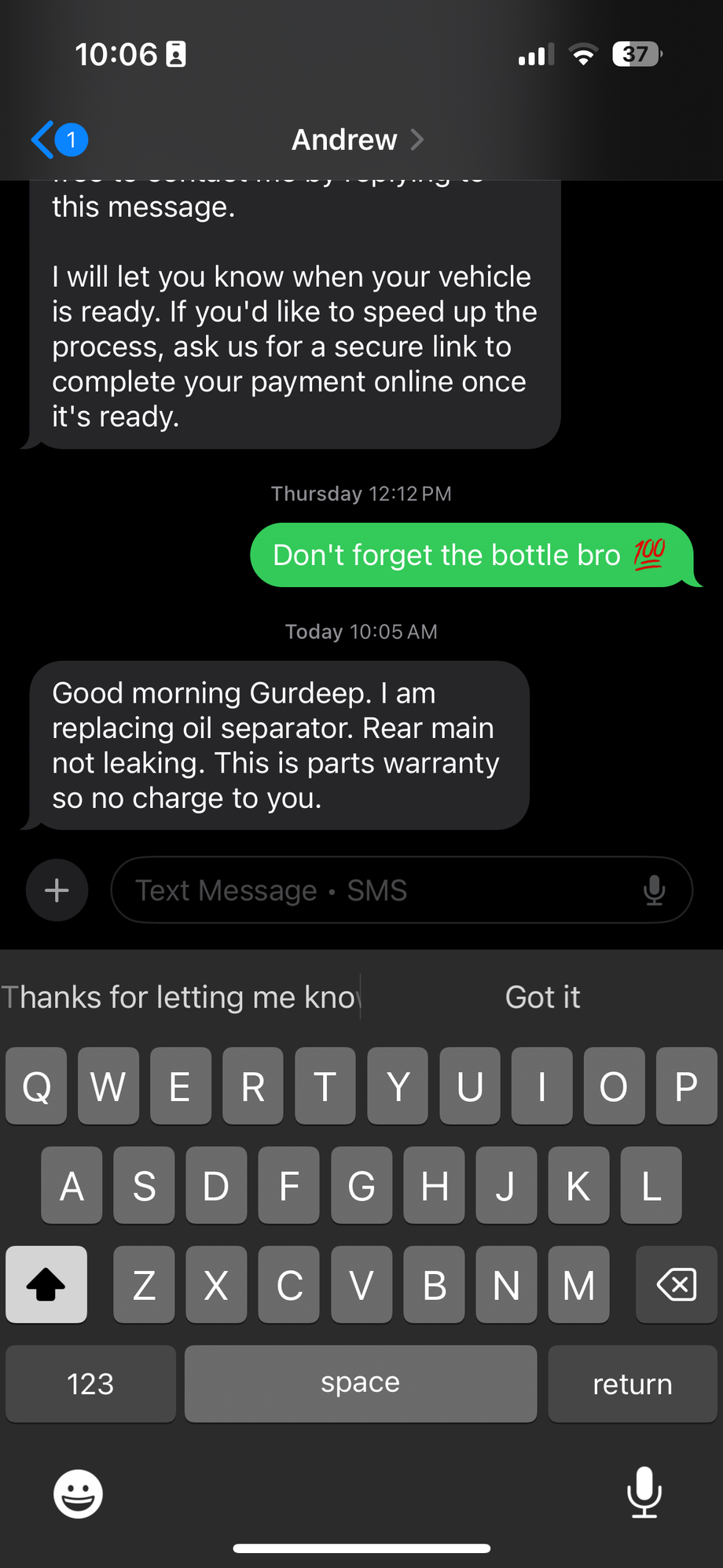

My 2018 went in for a RMS + oil separators at the dealer. It started leaking again after approx 2K miles. Dealer fixed it no questions asked. Take it back to the dealer. Pretty much anywhere will give a 30-90 day guarantee on repairs.
mine is going back tmrw morning, if initial repairs are done @ Benz then your parts should have 3 year parts warranty. I’m not worried I’m more annoyed, just want my car to stay in my possession so I can enjoy it when the weathers good
leaking so much ? You have a photo

Sorry, no photo. Maybe 10X what GeeSingh posted.
Got a message back from dealership, it apparently isn’t the rear main seal causing the leak but the oil separators…
