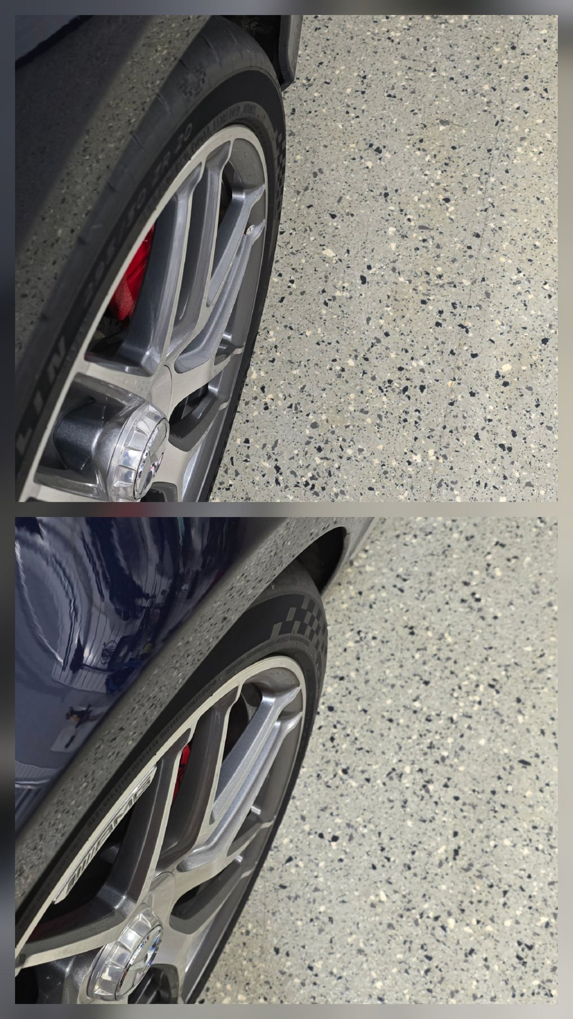

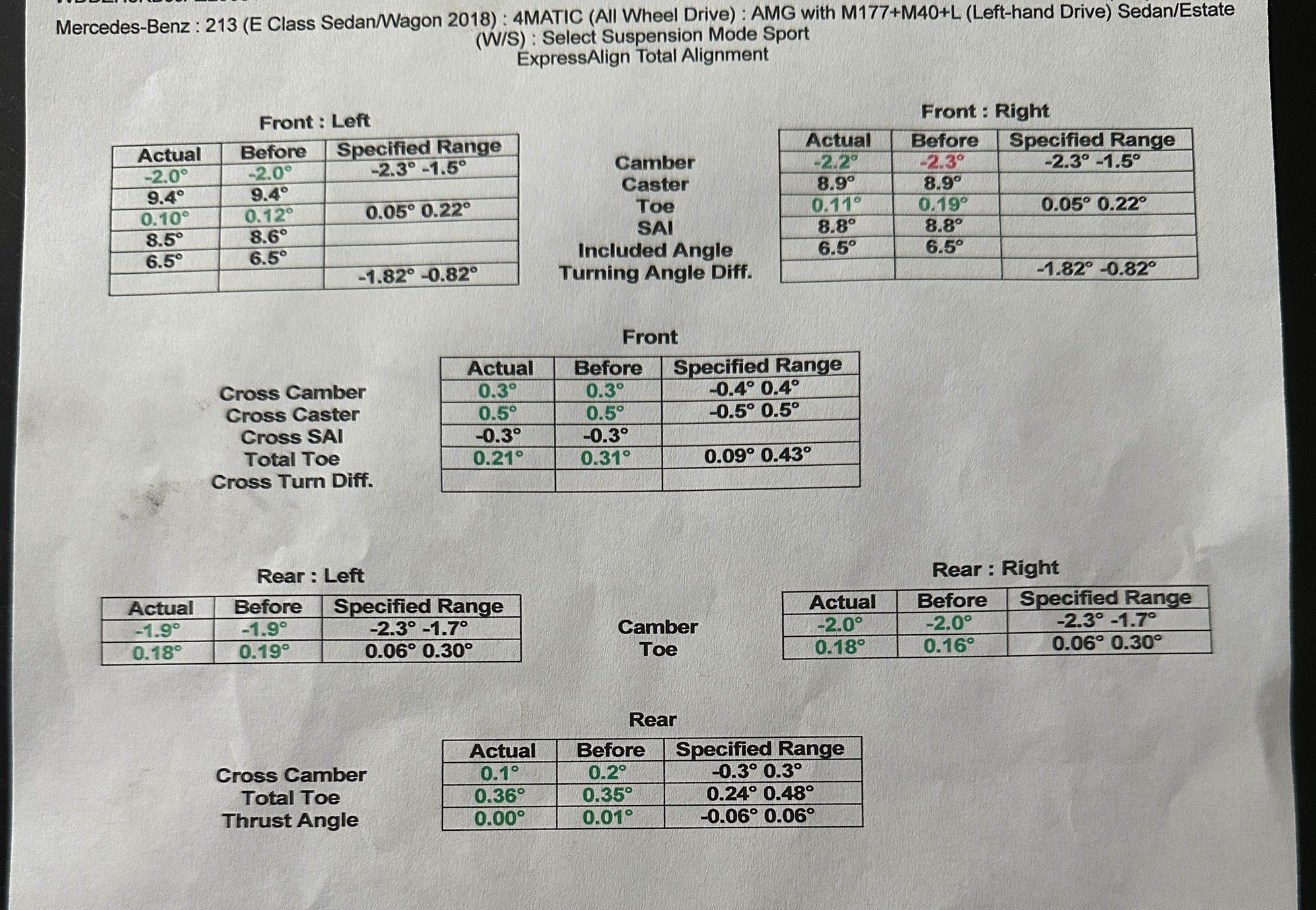

Old May 24, 2025 | 01:15 AM
  #41
superlative's Avatar
Joined: Mar 2025
Posts: 54
Likes: 21
Originally Posted by amg guy
I told my SA to put on a set of PS5's if he can get them and do an alignment. My biggest beef with my PS4's is the noise. Please report back to us.
Thanks
I drove prob 60 or so miles today on them.
Def quieter.
Windows down+up no music, less audible hum.
Had PS4S before.
Noise really wasn't too big issue for me but its a nice plus to these.
My weirdest discovery is the car will TPMS error when we tried to do 36PSI on the rear..
Gas cap sticker says 36 is ok and wanted to try that but the error stayed on the dash until we filled to 42
Im running 47 cold up front and around 42 rear.
It took them a bit to get the rears on the wheel since its a pretty wide tire
Sidewall is nice and tall.
Videos of velvet sidewall are color graded and unfortunately nicer than reality. Its there... but I was expecting that nice cup2 very black sidewall effect.
I also got aligned and will post specs
