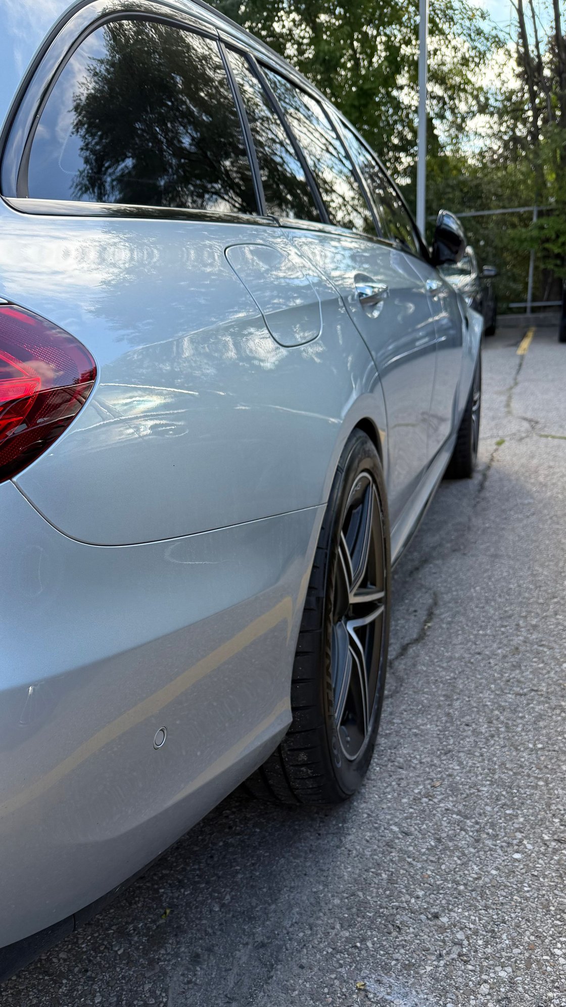

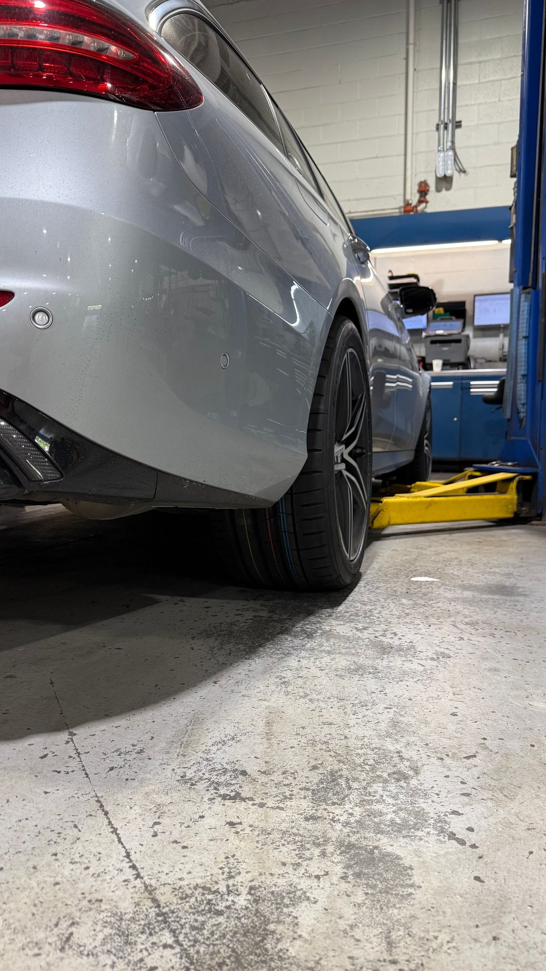

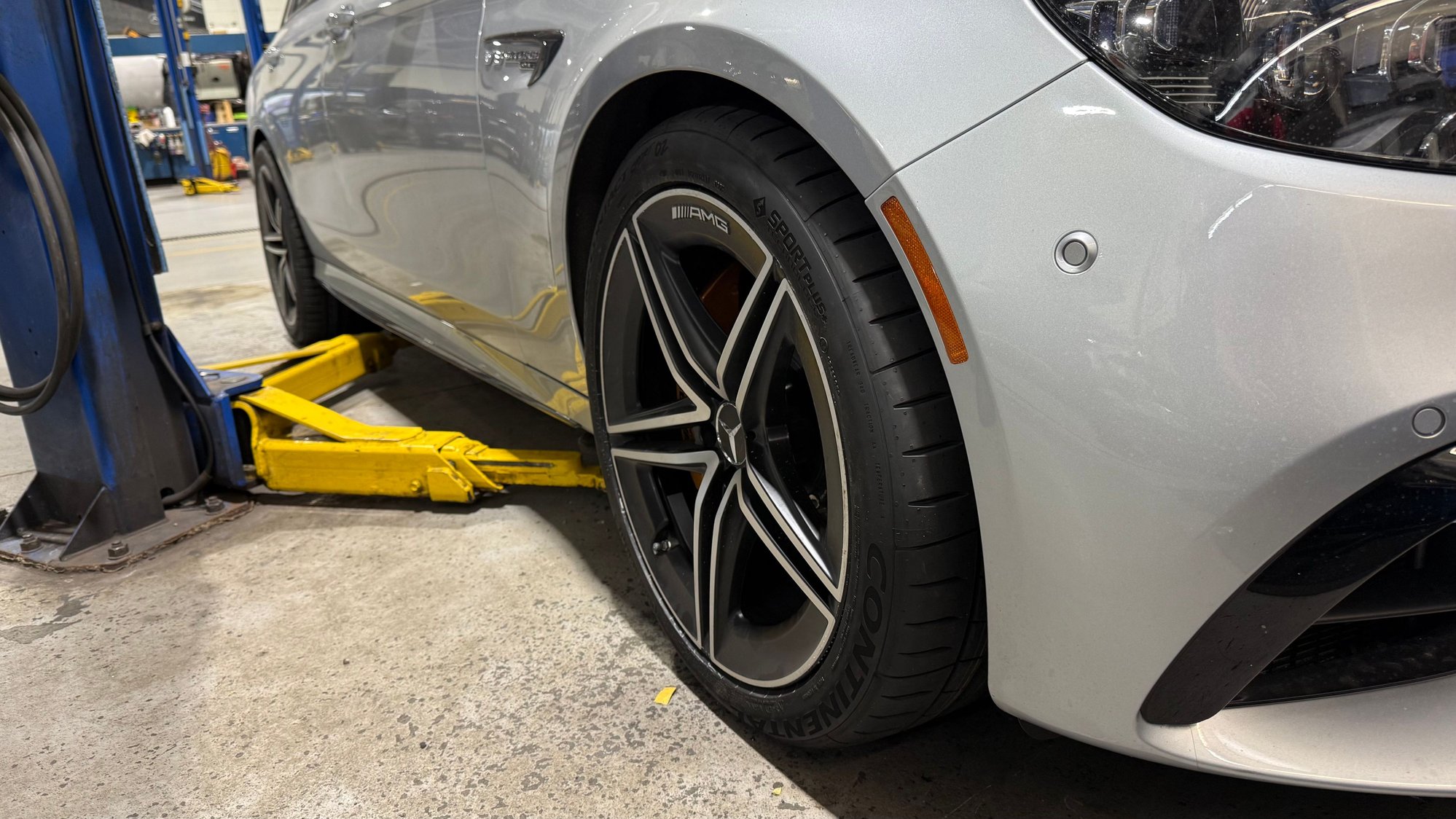

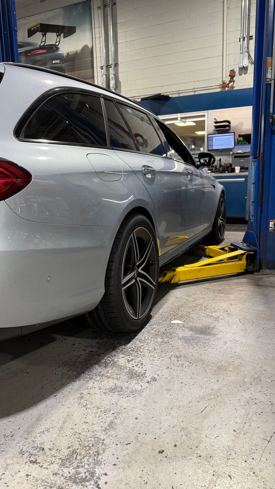

Swung by the dealer. They had to put the 12mm spacers on for the wheel/rim to even go on! With the 305/35's it just mashes against the inner wheel well without the 12mm. They laughed when I said I orderd 3mm spacers. These Continentalls are fatty-fat-fat! Holy moly.
So I left and they are going to put the other side on and tell me what the rubbing situation is after they drive it. I may need to go down to a 295/35 in the rear.

Note: suspension is high due to the dance cars do after being jacked. Still needs to settle when driven.
305/35 R20 on stock 10” rims with 12mm spacer
285/35 R20 on stock rims no space
285/35 R20 on stock rims no spacer

Rear looks out of place to me.

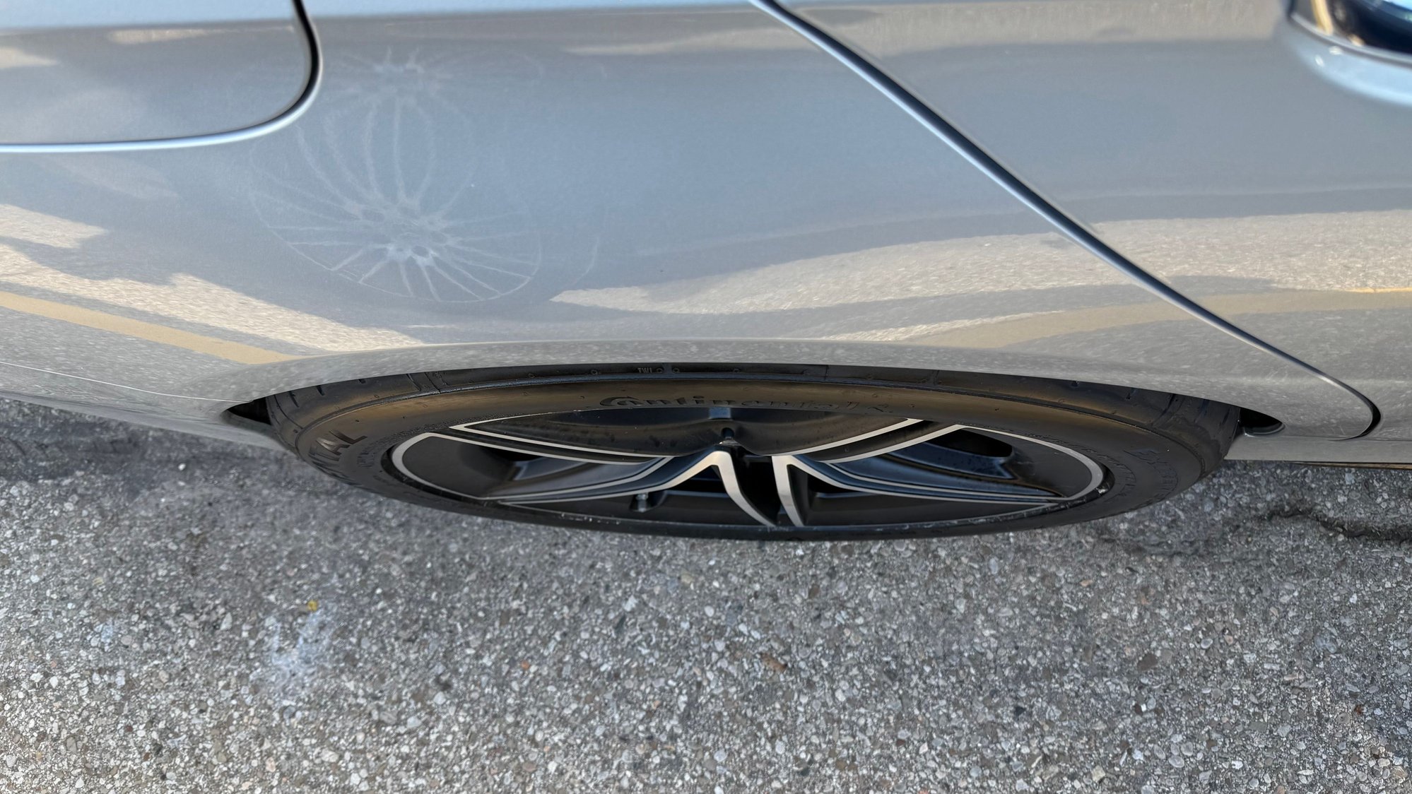

Stock rims stock height, 12.5mm Supreme Power Spacers.
Zero rubbing - after a few days I will start lowering a bit at a time and see how it goes.
I love the overall look however I’m not a fan of the bulge on the rim. So I’m either going to go to a 295/35 tire which has about 1/2” less section width or widen the rims to 11” over winter.
I’m loving the meaty 28” diameter! The 305/35 is 1” taller then 295/305/30. It really fills out the wheelwell properly IMHO and will only need 10mm lowering to achieve the same look as 295/305/30 and 25-30mm lowering.

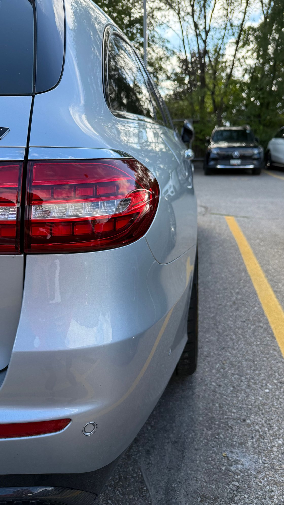

Update: some light rubbing on heavy dips. Outside tire.
So tonight I was going to remove the 12mm rear spacers to try the 3mm then 5mm spacers and found out….
No spacers required! Dealer was wrong!!!
305/35 rear tire on stock rim fits with no spacers.
It barely touches the inner felt cloth at the 3 o’clock position when the wheel is hanging. Let the car down it clears by a good 3/8”.
I’ll take some more pics after I drive around a bit.
Stoked as the rear looked kinda dumb with the spacers on. Too much poke.
So happy to be spacer free!!!!!! Got an alignment and it’s on rails.

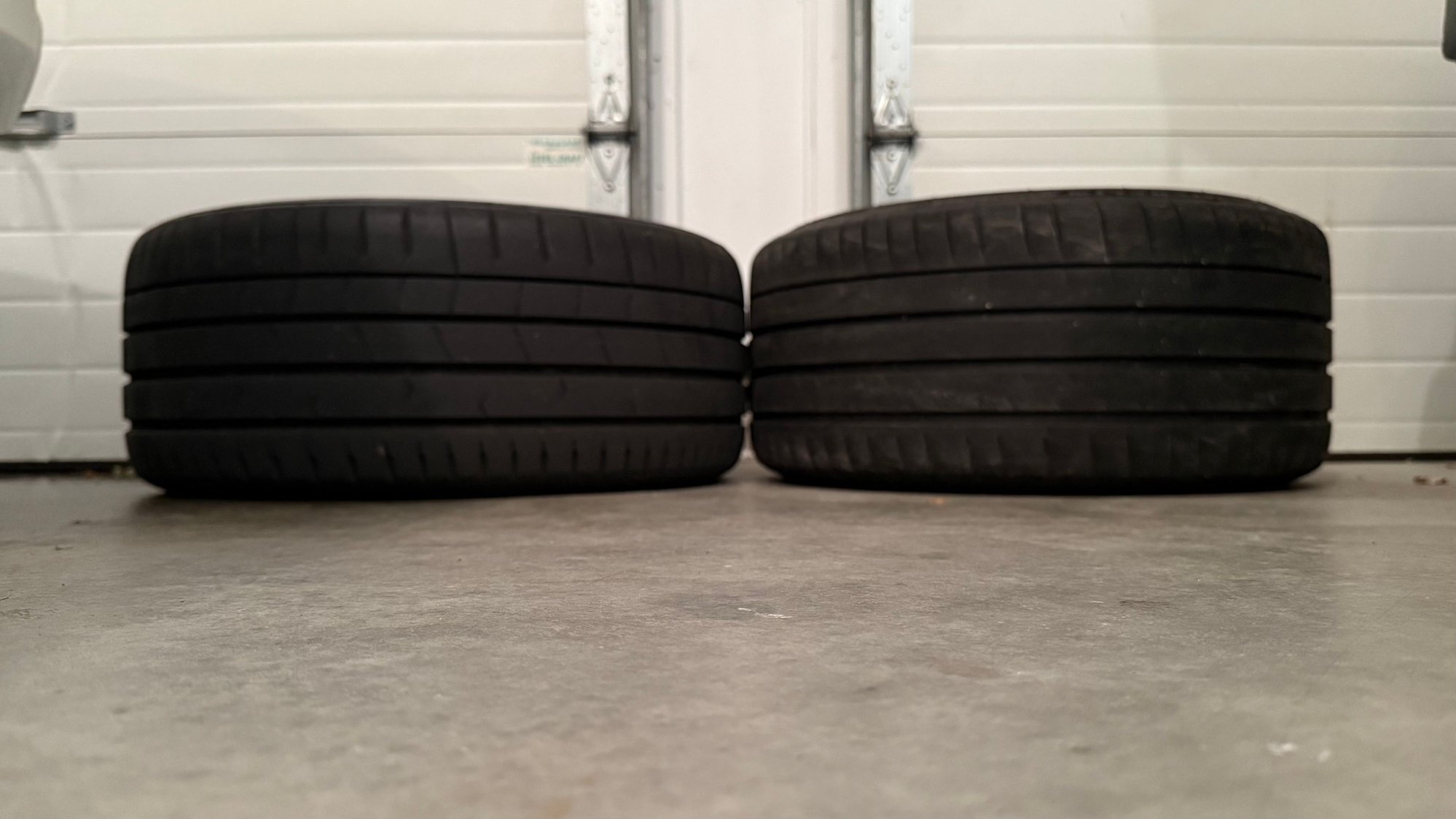

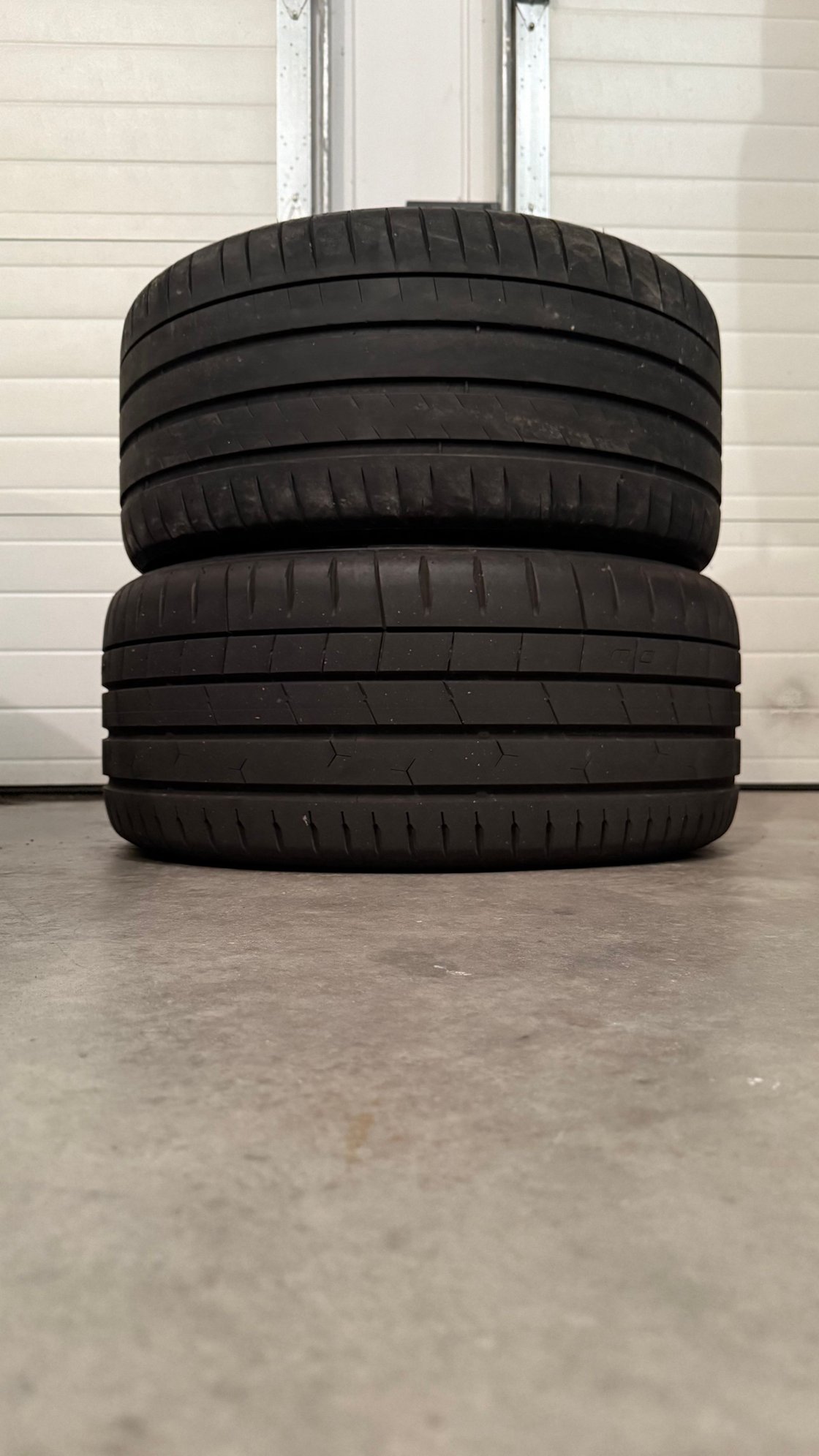

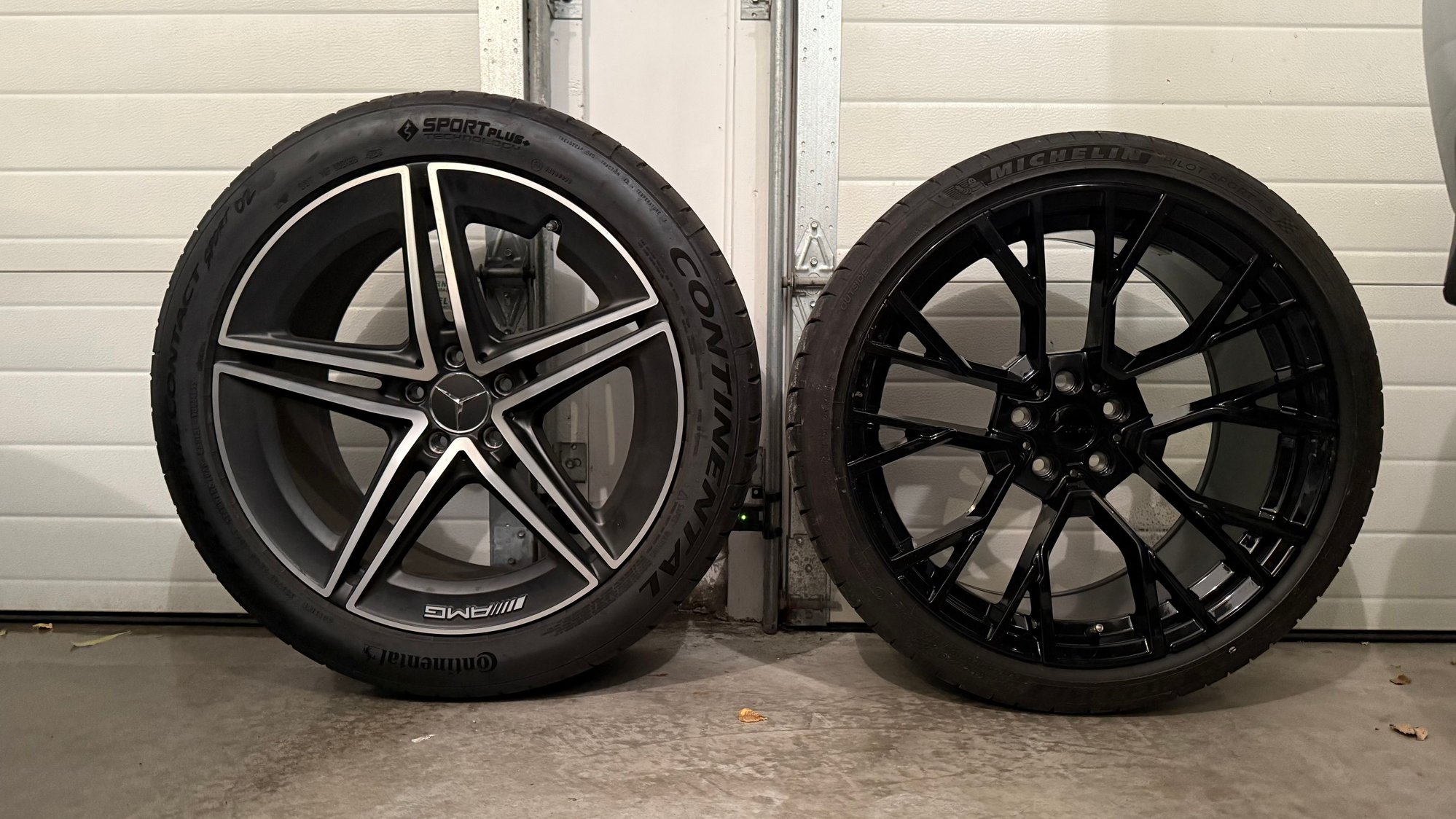

The Importance of Wheel Width
295 on a 10.5” wheel is wider then 305 on a 10” wheel:
305/35 R29 left 295/30 R20 right
305/35 R20 left 295/30 R20 right
295 top 305 bottom
295 top 305 bottom
305 left 295 right
305 left 295 right
