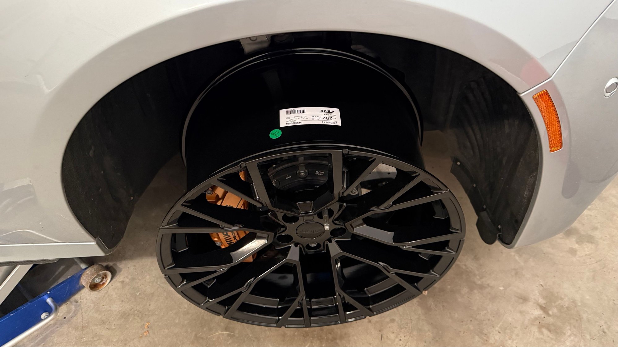

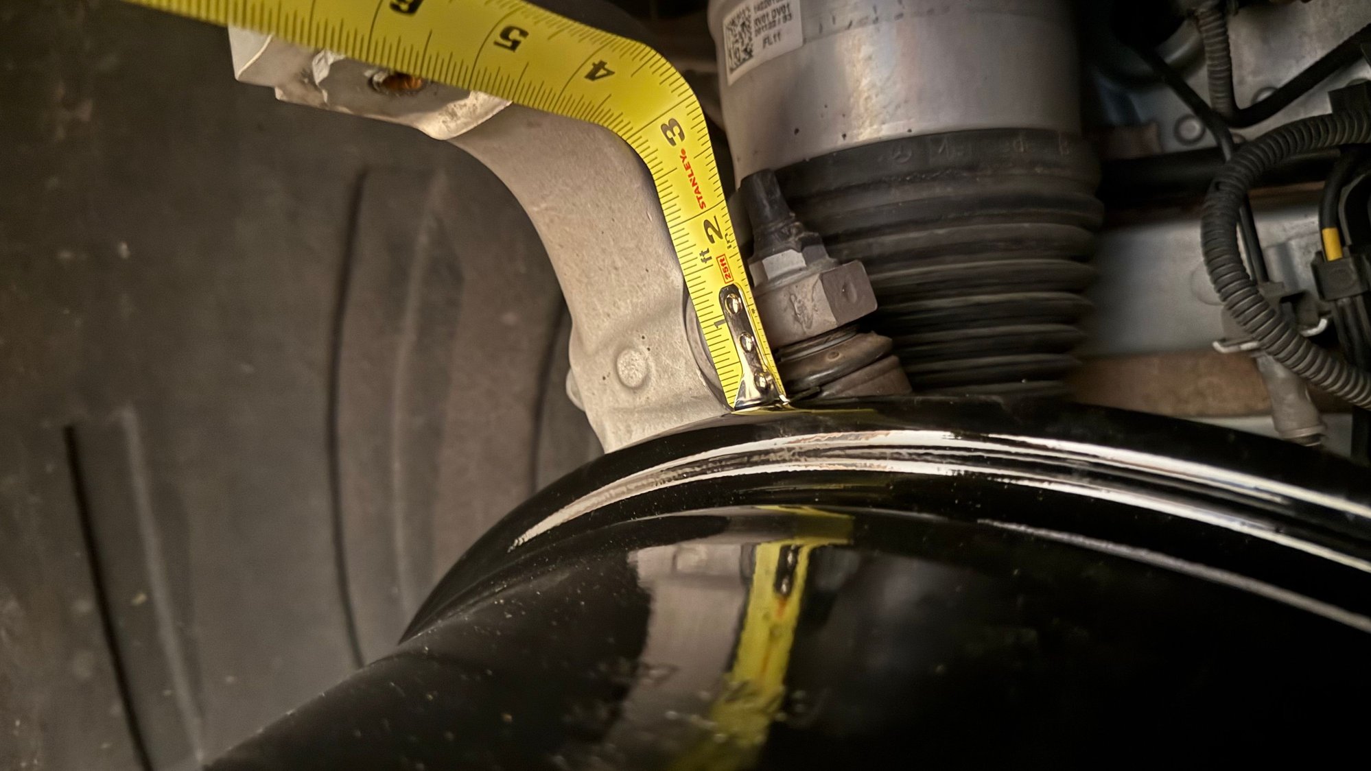

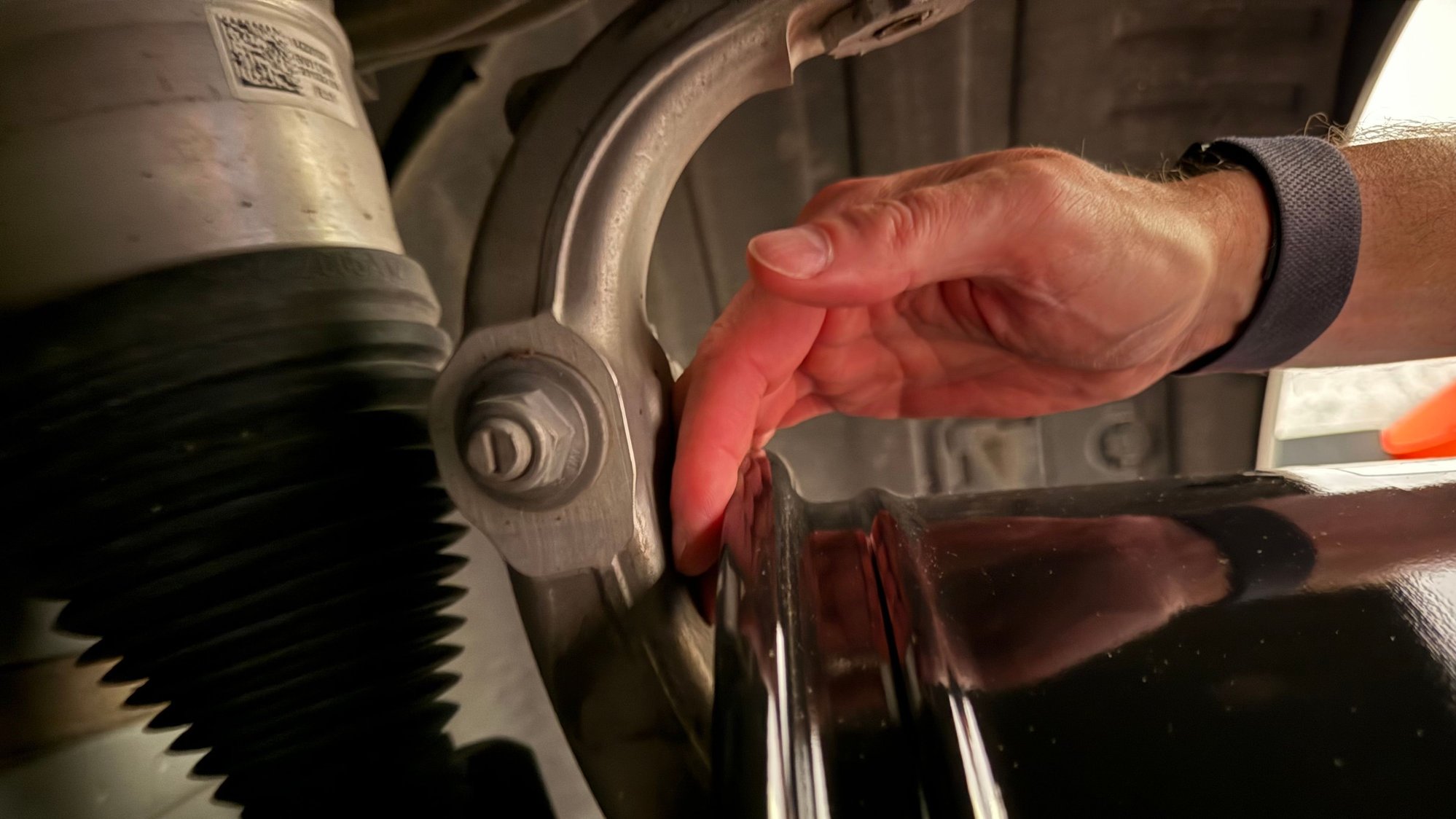

Wheel mock up
(Cheapie for measuring with different spacers)
I think this is enough space… suppose it’s time to try a couple tires sizes on and drive around!
20x10.5 ET25 (15mm spacer on ET40 Wherl)
20x10.5 ET25 (15mm spacer on ET40 Wheel)
1mm or 1m, clear is clear, right?
Can always use a larger spacer to give 1-2-3 more mm if needed
Can always use a larger spacer to give 1-2-3 more mm if needed.
Lots of height for rubber
Fender poke looks same as current stock wheel setup below
20x9.5 ET 10 (stock ET 25 with 15mm spacer)
Current 20x9.5 ET10 (stock ET25 with 15mm spacer)

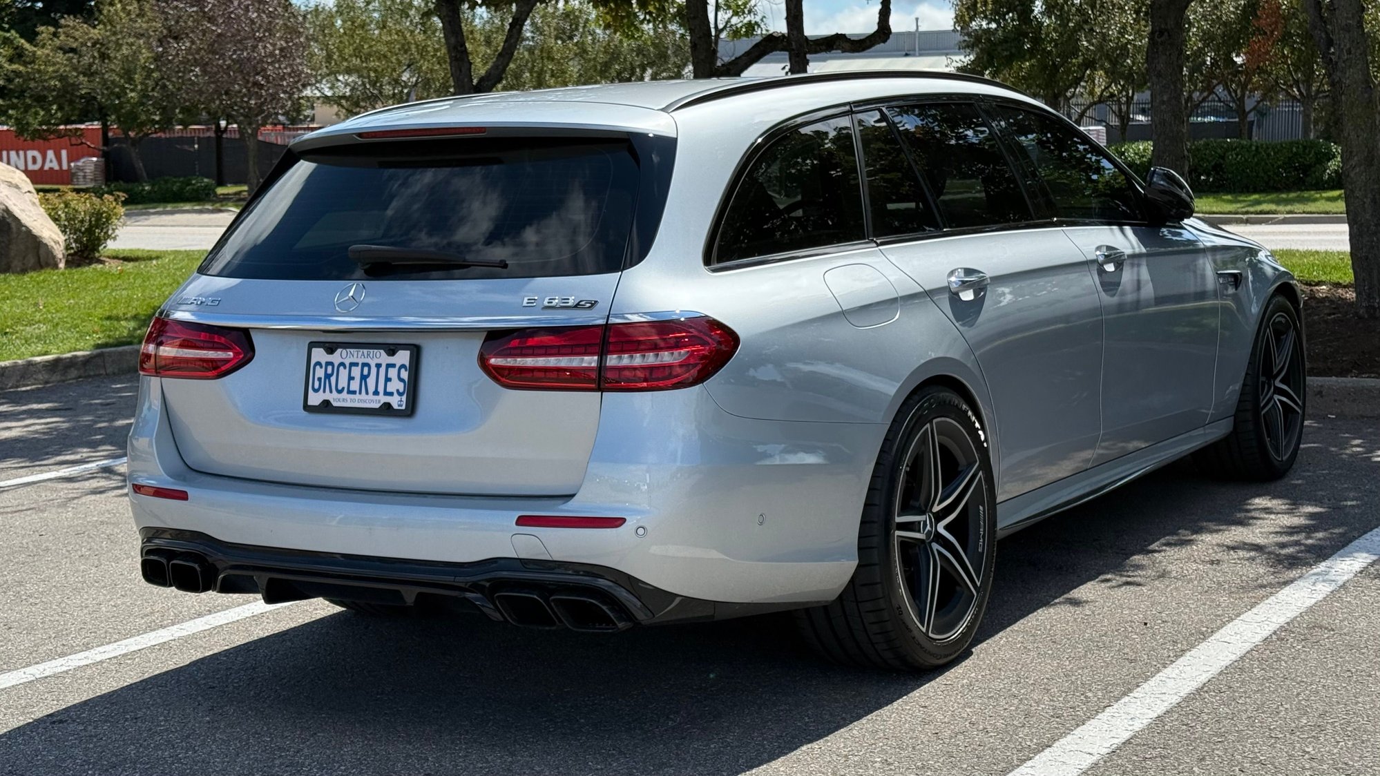

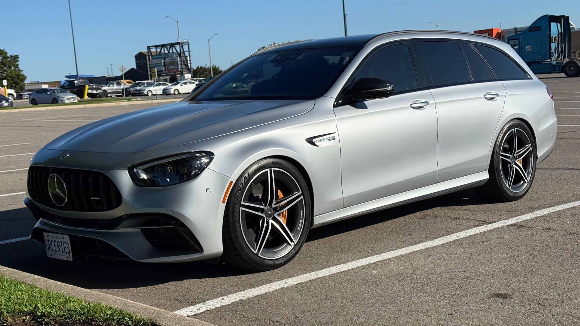

305 / 285 tires update
Originally the dealer said they could not fit the rear tires without using the 12.5mm spacers.
I did not like the look and also experienced some rubbing on the outside of the tires on suspension compression during large dips.
I was able to remove the rear spacers and the tires fit fine.
The original plan was to widen the wheels over winter 11” rear and 10.25” front but that would necessitate running 15mm spacers front and rear. I’m kind of liking the no-spacer life and think I can see past the poor non-flush fitment with some lowering.
So far it’s lowered to -25mm front and -15mm rear and zero rubbing. I will play with the heights to nail the look.
Here are some pics with rear spacers at stock height:
12mm spacer stock height

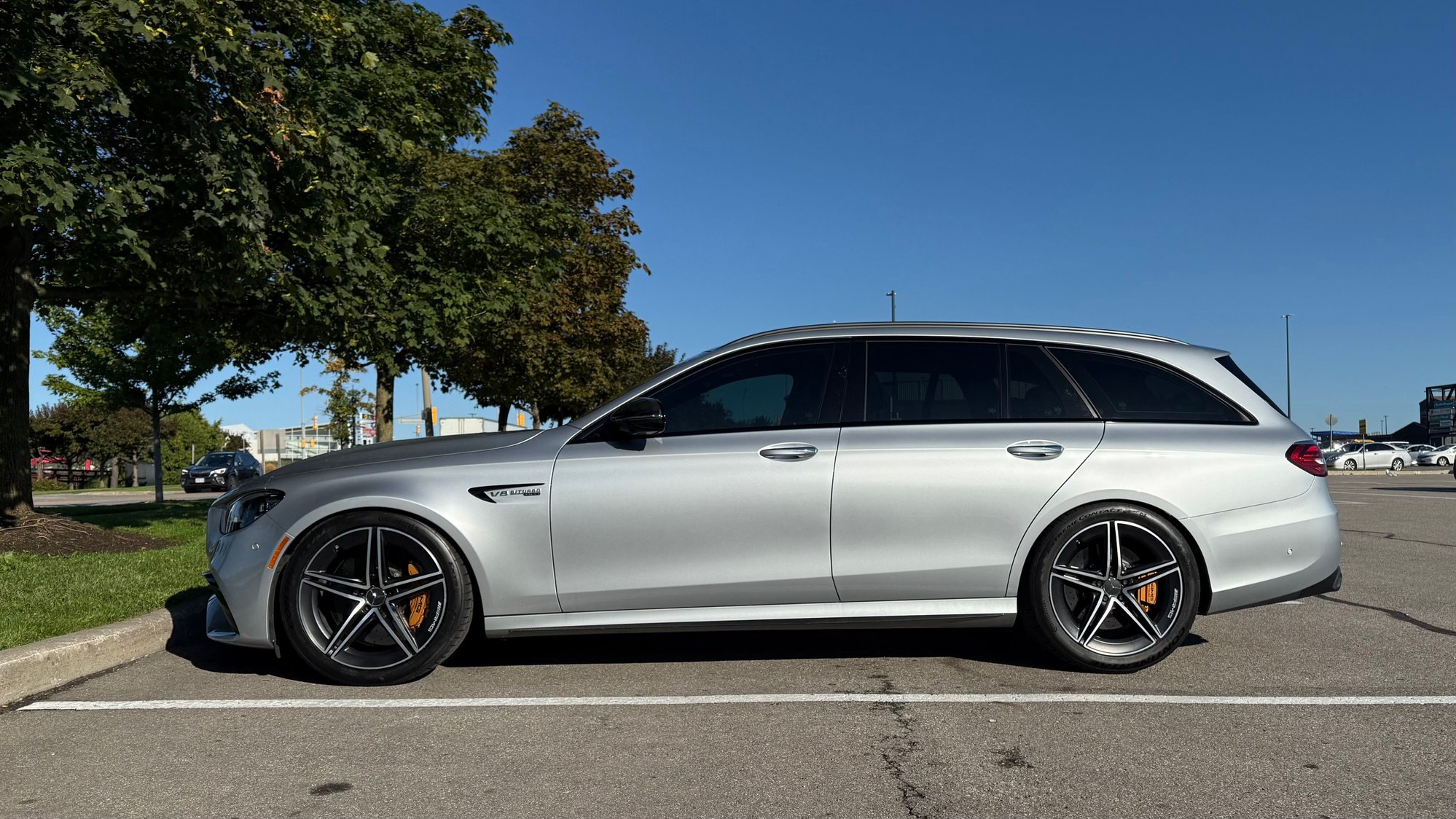

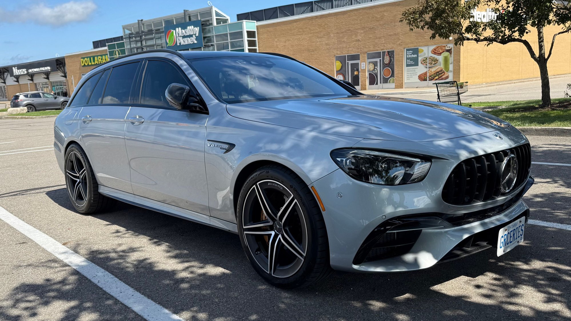

And here are some pics no spacers and lowered:
Front -25mm Rear -15mm no spacers
Rear maybe needs more lowering

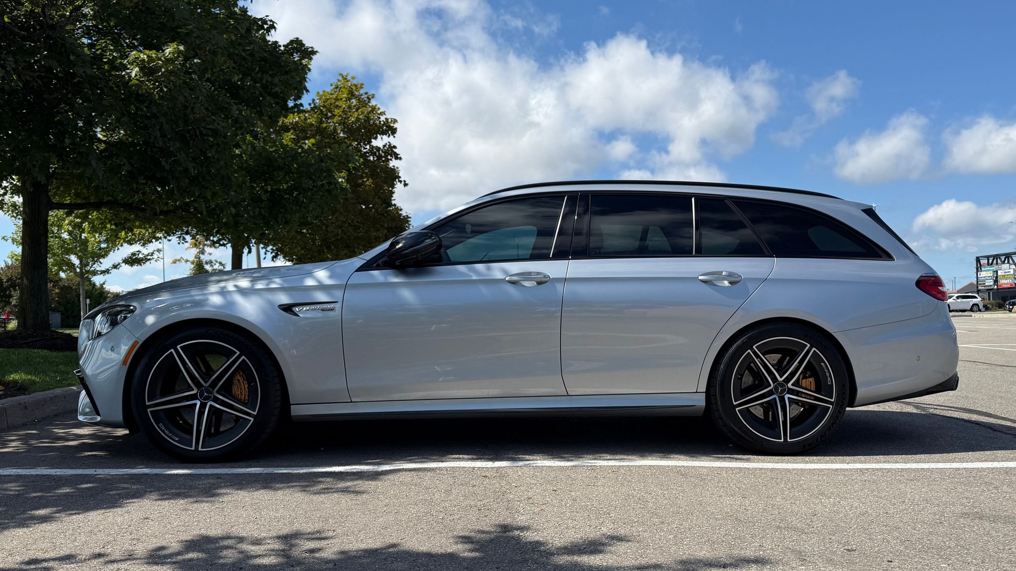

I think I’ve settled on
-30mm / -25mm F/R
IMHO these cars look so much better with 28” diameter vs 26” roller skates.
