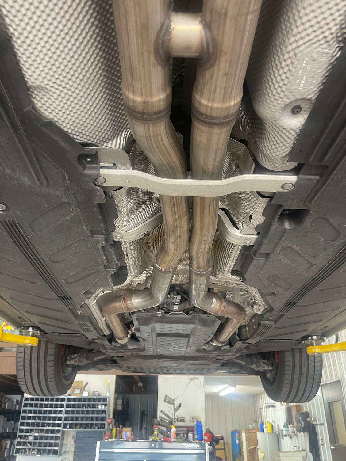

I found more threads related to PE vs non and learned that E63s have the same mufflers, the only difference being the valved H pipe the PE has which is just a non valved H on non-PE. I had the H replaced with straights and the tone changed quite a bit as well as some volume. While in the same pit, I learned about the valve simulators for the muffler valves, but those don’t seem to work as I got a cel and limp mode. Ultimately I was able to figure out how to disable the valves fully with DTS Monaco and now I’m running 100% open mufflers too.

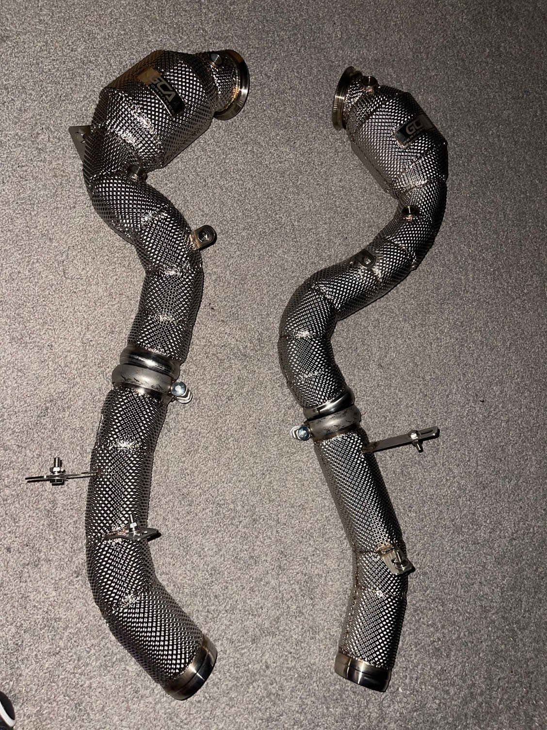

Now my exhaust consist of a 200cell sport cat downpipe with straight mid and mostly a muffler bypass, it is proper loud now.

Sounds good as long as there is no drone on the highway

Very minimal/none on highway. At idle it is about a low and at cold start a medium. Also has more drone on comfort than race mode due to the lower RPM.

Sounds strong. Did you install the DP yourself or get a shop to do it? If you went with a shop, mind if I ask which one? I’m out in Boston and the shops here are quoting me nearly 20 hours to install this thing. I’m being told they need to drop the transmission to put one in.

Since I’m not going back to stock, I got the DPs cut. A competent shop should be able to do that in sub 3 hours by cutting between the primary and secondary cat. One piece comes out the top and another out the bottom. Rest is just unbolting exhaust and removing turbo shield.
