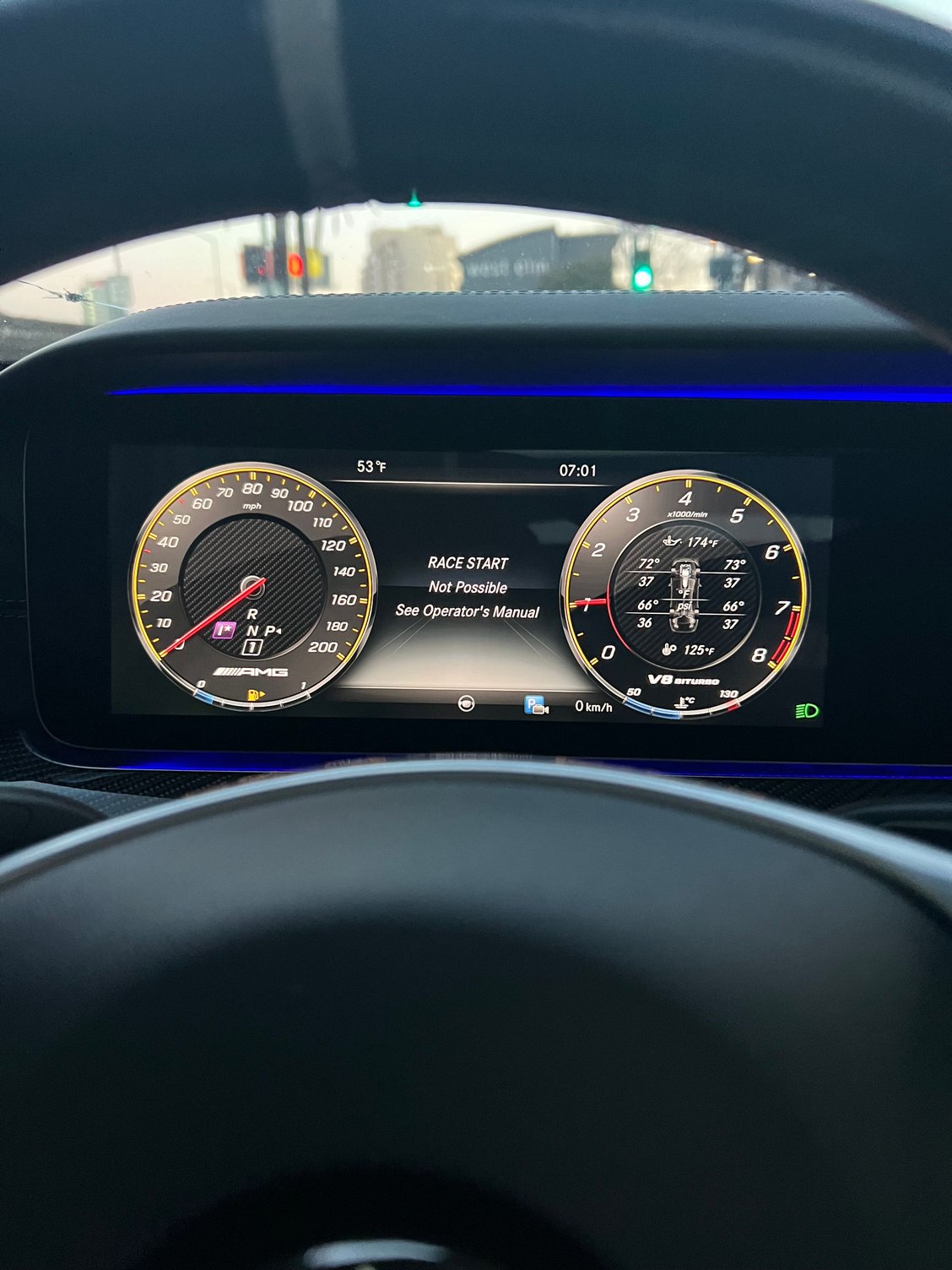

Race Start Issue with w213 2018 E63s AMG – Anyone Experienced This?
Hey MBWorld community,
I’ve been having an issue with the Race Start function on my E63s AMG and wanted to see if anyone else has run into the same problem.
Everything used to work fine, but lately, when I try to activate Race Start, it either doesn’t engage at all or gives me a message saying it’s not available. I’ve checked the basic requirements (car in Sport+ or Race mode, seatbelt on, steering straight, brake and gas applied correctly, etc.), but still no luck.
Has anyone else experienced this or figured out a fix? Could it be software-related, tire wear, or maybe something else? I’d appreciate any insight or advice from fellow owners who’ve dealt with this before.
Thanks in advance!

In that picture, your transmission temp is just barely above 120F. 120F is when it goes from blue to white, but not sure if that's already warm enough for Race Start to be available. Your engine is also not fully warmed up at 174F.

There's no limit on the number of Race Starts in AMGs to the best of my knowledge. It's been brought up in the past, because some competitors have limits on how many times you can launch. Some people have had issues with not pressing the brake pedal hard enough. You do have to press down quite hard on the brake pedal.

Time for a scan to see if it logs anything. Sounds like there's a condition that's not met for whatever reason.
