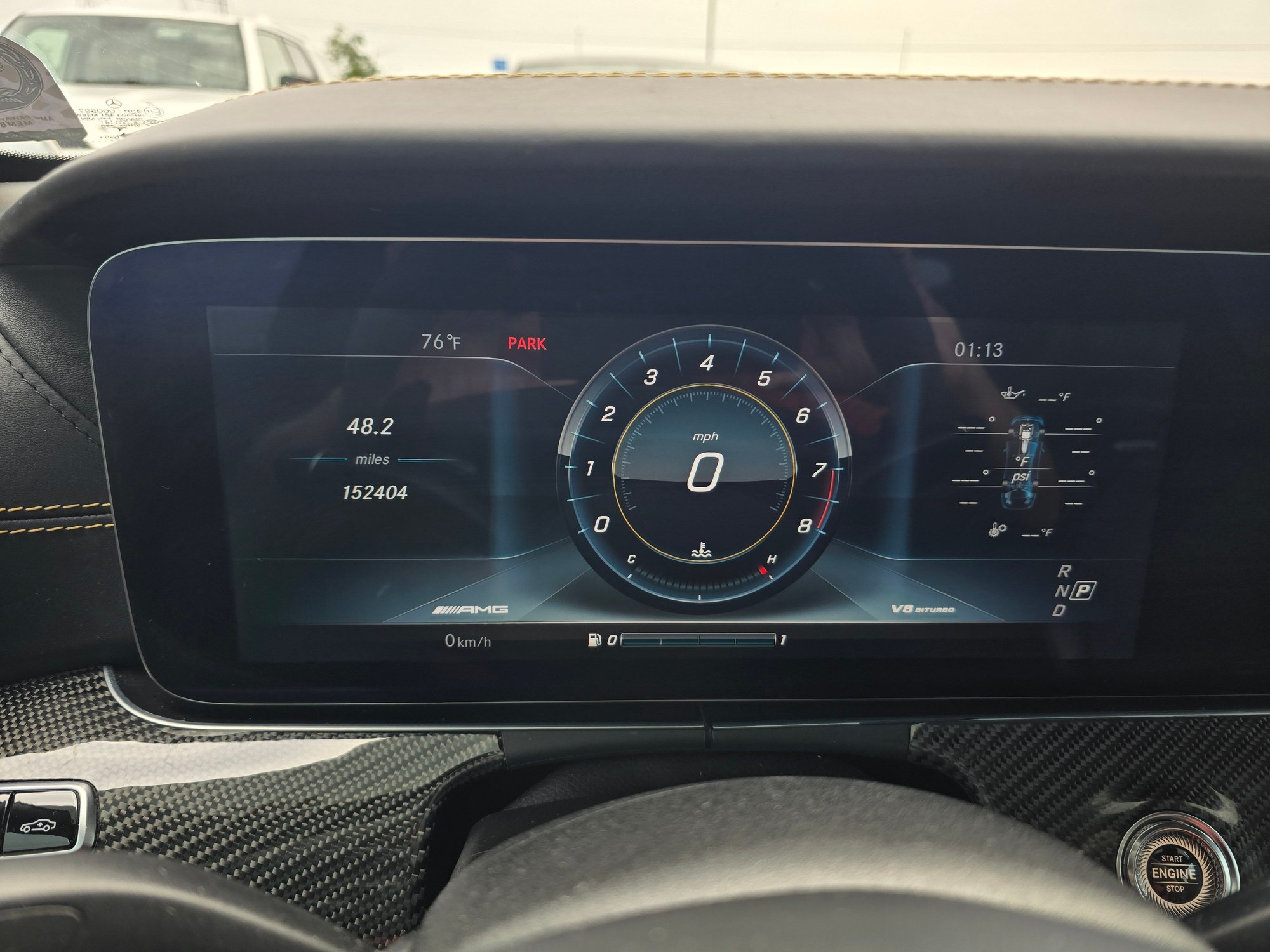

Originally Posted by chassis
Sorry to hear.
MB V8s are grenades in the first degree. Strong avoid.
Geez... someone forgot to pull the pin in my grenade???
Just incase, that is 152,000+ MILES.
He posts the same line whenever anybody has an issue with their car. If it's not the V8, then it's the quality of the cars in general. I've finally added him to my ignore list last night. It's just a bunch of useless noise at this point.
