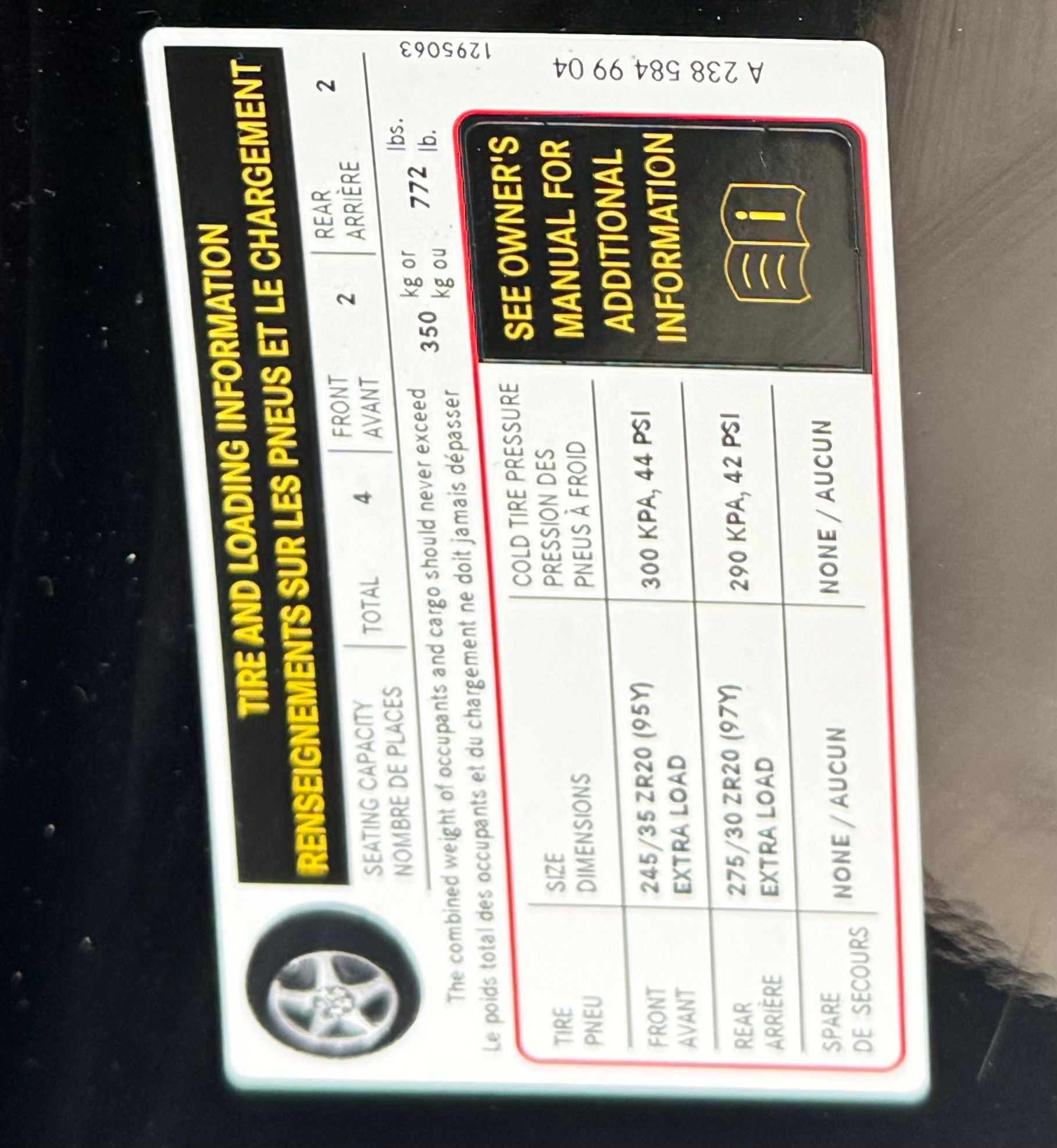

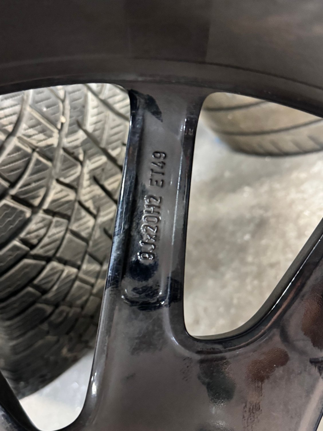

I know this topic has been discussed before, but I’m currently looking to get a set of winter tires and rims. I’m considering downsizing from 20” to 19” and was wondering if anyone here has done something similar.
If you have, I’d really appreciate any tips or things I should watch out for.
I’m hoping to find a used set of AMG rims, but I’m also open to aftermarket options.
Any insights or recommendations would be greatly appreciated!
Current Tire Setup
Current Tire Setup (Pirelli P ZERO RF)
Rims
Rims

I get that you want to start a new thread; there is one on the front page has lots of "tips" including several that have 19" setups. Tires, width, psi recommendations as well:
https://mbworld.org/forums/w213-amg/...e-setup-4.html
Are you asking a new question? Like what brand rims to buy? Or something else not covered in links below - that can help people help you to know.
What model car do you have? (Update your profile)
also - more links from the sticky Sticky that includes more discussions, tips, and pics of peoples setups; also links to all season tires:
https://mbworld.org/forums/w213-amg/...ml#post9005634
https://mbworld.org/forums/w213-amg/...-rim-size.html
on downsizing to 19" rims, also in the sticky, beware clearance of your front caliper when choosing a rim, do you have CCB?
https://mbworld.org/forums/w213-amg/...-oem-rims.html
https://mbworld.org/forums/w213-amg/...mg-wheels.html
https://mbworld.org/forums/w213-amg/...ss-solved.html
also a tip for you - when posting pics, take a second to rotate them for everyone to more easily read. Good luck!

Before u buy anything, especially aftermarket ones, do make sure the offsets and widths are close to the factory specs; otherwise, you could have a potential fitment problem.

Thank you very much for sharing all the Tips and tricks still a newbie here learning my way. Great info for the rims and tires as you listed. I have also found a very good website tiresize.com which allows you to compare your existing setup with the new setup along with some cool graphics. I actually found a set of 19 AMG 5 spokes from a CLS 53 that I am probably going to use.

Thank you very much for your response absolutely correct I noted this and will be very careful
