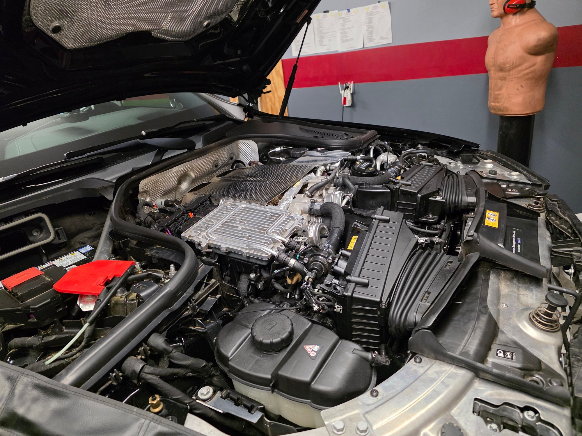

Hello to all my fellow mechanics who do their own maintenance,
I just tackled my oil separators along with a few other preventive maintenance items. Honestly, it wasn’t as bad as I expected—especially since I wasn’t rushed and could take my time.
If I could do one thing differently, it would be to order all the parts before starting. Waiting one to two weeks for parts really slowed everything down.
I originally tried to order the Wagner Tuning upgraded coolers, but they were out of stock at the time. I ended up going with the CSF option instead. From what I’ve seen, the Wagner units might be back in stock now, but overall I’m still satisfied with the setup.
The car has been back together for about two weeks, but I’m still waiting on a couple of small things. The plastic bumper cover brackets snapped during the process, so I’ve got replacements arriving Monday.
Overall, definitely a worthwhile job—and not nearly as intimidating as it seems.
I took a few pics along the way—I'll post them below.

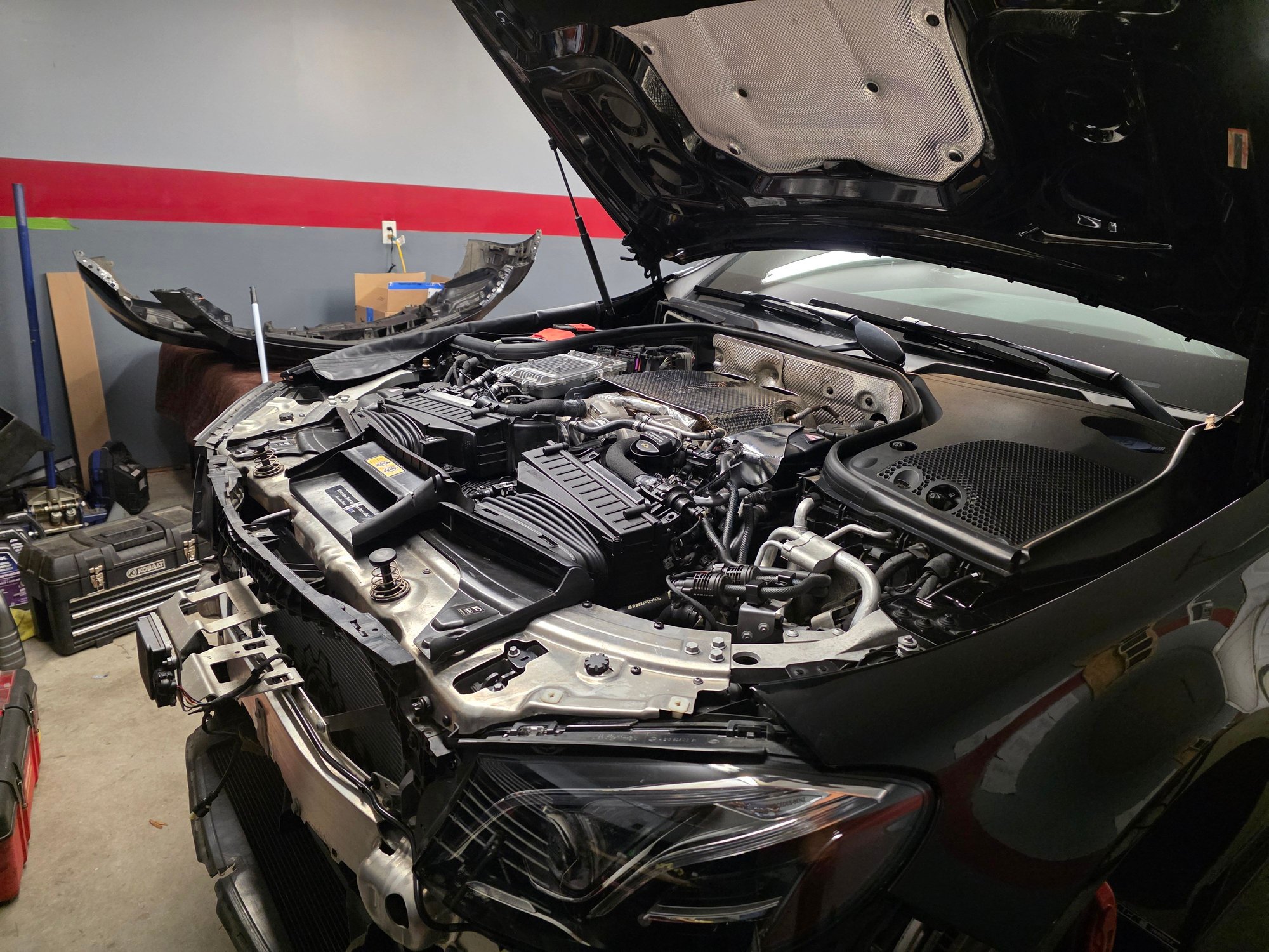

I originally pulled the bumper to install a low-temp radiator, but like most projects… it turned into something bigger.
I hadn’t planned to do the oil separators yet, but one day I tried removing the oil cap with the engine running and couldn’t. That led me down the rabbit hole. I tried to order oil catch cans but never got a response from the company. After talking with a few performance shops, they still recommended adding catch cans later to prevent this issue—but since my RMS wasn’t leaking, I decided to go ahead and handle the oil separators now.
At 56k miles, it made sense to knock out a bunch of preventive maintenance while I was in there.

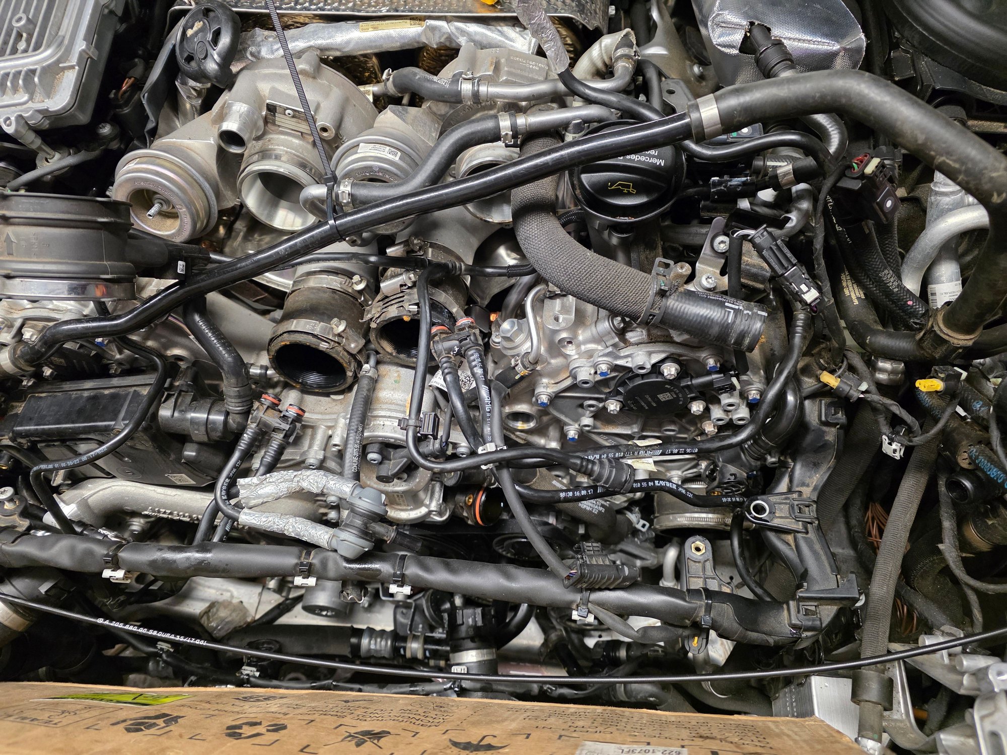

🔍 What’s Involved (Quick Overview)
This is not a small job. You’ll be working through the entire front end to gain access.
To reach the oil separators:
  • The cooling fan must be removed
  • The intercooler needs to be slid back
  • The top metal support plate (bumper mount) has to come off
⚠️ Important Things I Learned
Cooling Fan Removal is Mandatory
There’s no way around it—you need the space to move the intercooler back.
Intercooler Access
You don’t necessarily have to fully remove it, but it must slide back enough to access the oil separators.
👉 Pro Tip:
If you’re not removing the intercooler completely, place a piece of cardboard (or similar protection) in front of the main radiator. This will help prevent accidental damage to the radiator fins while moving the intercooler around.
Bumper Brackets WILL Break
The plastic bumper mounting brackets were extremely brittle and broke easily.
👉 I recommend:
  • Removing the bumper completely
  • Replacing the brackets proactively
Bracket Install Tip
They’re held on with double-sided tape.
  • Clean ALL old adhesive off
  • Do proper prep
  • Install them off the car
Trying to do this while installed would be a nightmare.
📸 Biggest Advice
Take more pictures than you think you need.
I took some—but not nearly enough.
If you end up waiting weeks for parts, you’ll forget where things go.
🧩 Parts Tip
Order EVERYTHING ahead of time.
I had delays waiting on parts, and it slowed the whole job down. If I did it again, I’d make sure every single part was on hand before starting.

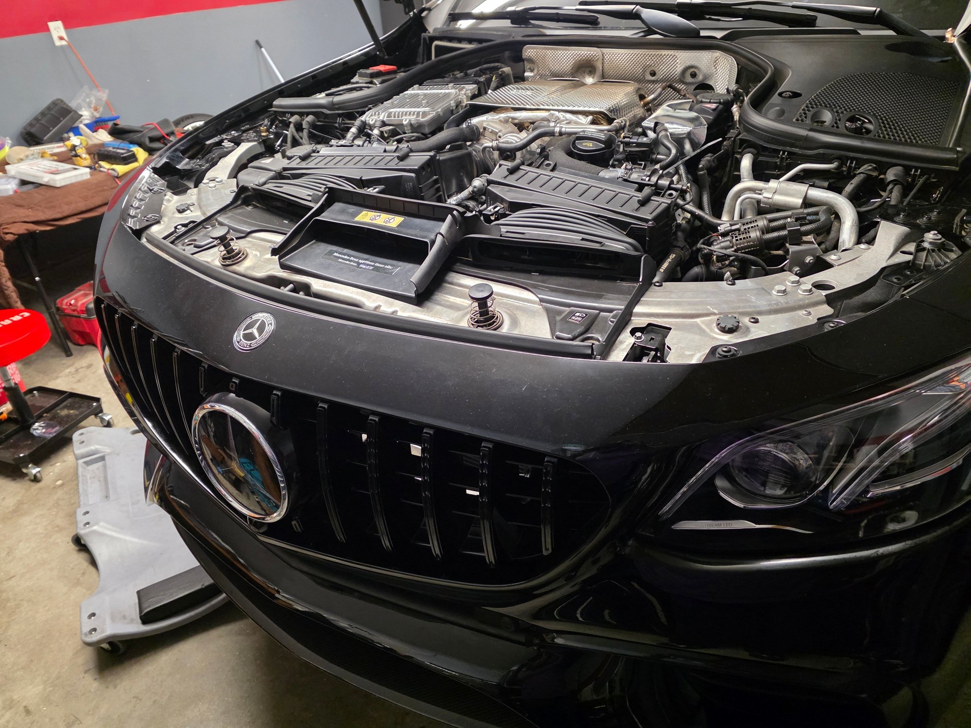

🔄 Reassembly & Final Status
Got everything back together:
  • Coolant system filled and bled
  • Car is running smooth
  • No leaks so far
I still have a few small items left to install, but everything looks good.
🚗 Next Step
Once I finish the last few pieces, I’ll take it out for a solid test drive and report back.
