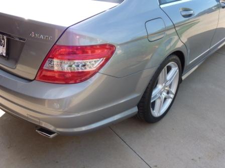

Old Jun 14, 2009 | 07:51 AM
paladiumonblack's Avatar
Joined: Jan 2009
Posts: 104
From: Tallmadge
C300 4Matic with 18in AMG's
Originally Posted by paladiumonblack
Anyone know for for sure if the 18in AMG's will work on a c300 4-Matic? Does anybody have them on a 4-Matic?
I now have the 18in AMG's on my 4-Matic with no apparent issues. Rolling diameter of front and rear is nearly identicle - actually closer that the stagger on the 17's that come on it. I think the only reason you can't order (my guess) is that the summer tires that come on the AMG's don't make sense on for a 4-Matic vs the all seasons that come on the 17's. Anyway, I love the look!
Attached Thumbnails Why can't you get AMG 18in on 4-Matic C300?-p1010943a.jpg
