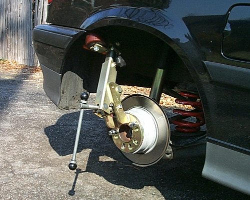

Are you referring to "Fender Rolling"? This is not expesive:

CRUCIAL - MAKE SURE THE TECH/SHOP KNOWS THAT THE PAINT MUST BE HEATED TO PREVENT THE PAINT FROM CRACKING. GOOD LUCK!
TireRack also loans out that Haweka Fender Rolling tool for 'free' with a huge deposit with video instructions and a heat gun. The list is usually long.
