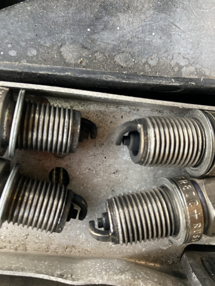

  #144
rufrob's Avatar
Joined: Feb 2013
Posts: 202
Likes: 13
From: Tokyo
W210 E55T
Checked it again today.
Terminal x
3-2=3.64
6-2=12.10
TPS
Closed throttle 1-2 short, 1-3 open 2-3 open
Open throttle 1-2 open 1-3 open 2-3 open
WOT 1-2 open, 1-3 open 2-3 short
So it seems ok.
It flooded again and again.
I cranked it with the plugs removed and a nice even spray came out of each hole.
WOT is needed to start.
Now, No cold high idle. It's like the IACV stopped working and the cold start injector is stuck open.
I set the FD to just a trick when the FP is jumped right? This is what the plugs looked like.
I found a few vacuum connectors to be loose or split so I'll get a new piece of hose.
Old Apr 2, 2022 | 03:09 PM
  #145
dolucasi's Avatar
Joined: Mar 2016
Posts: 1,369
Likes: 195
From: SF Bay Area, CA
190E 2.6L 1989, 190E 2.6L 1988, BMW 535dXdrive 2014, BMW 428i 2015
Terminal x
3-2=3.64
6-2=12.10
TPS
So it seems ok.
Dolucasi>> Glad you took the measurements again otherwise we would be going down a rabbit hole. Not sure what happened the first time as your measurements were completely wrong and almost impossible.
Dolucasi>> This is telling us that your ignition is most likely fine but you are getting way too much fuel to flood it. Hard to do with a CSV.
Dolucasi>> Most likely when you adjusted the mixture you turned it way too much to enrich the fuel. So how much did you turn that screw?
Dolucasi>> More likely that the jossling of connectors etc. fixed something temporarily. What is the cold idle rpm's right after it starts. If IACV was not working you would get about 1200-1500 rpm after you start.
Dolucasi>> Not sure what the questions is here but NO, if you have a running car you do not mess with the adjustment screw, you start measuring your fuel pressures and duty cycle at operating temp. to decide what to do next.
Dolucasi>> This of course needs to be sorted out before anything else but I though you did all this already. Go over each vacuum line once again.
Just a final reminder only change one thing before you report again.
Terminal x
3-2=3.64
6-2=12.10
TPS
So it seems ok.
I would like to see how the car starts with the EHA valve unplugged, that takes away the fuel enrichment and makes it similar to a WOT situation.
