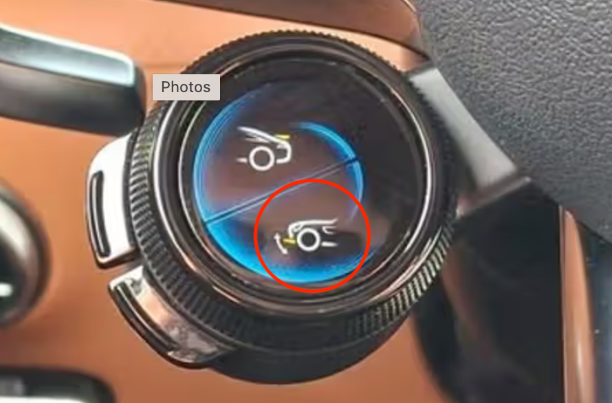

Does the symbol circled in red in the attached photo indicate that the GT55 includes the Front Axle Lift option? If not, which icon is used for the FAL option?
Is this the Front Axle Lift feature?

No, this is the front aero under the front bumper. Front axle lift icon will show an entire little car on the button, with an arrow pointing UP only.

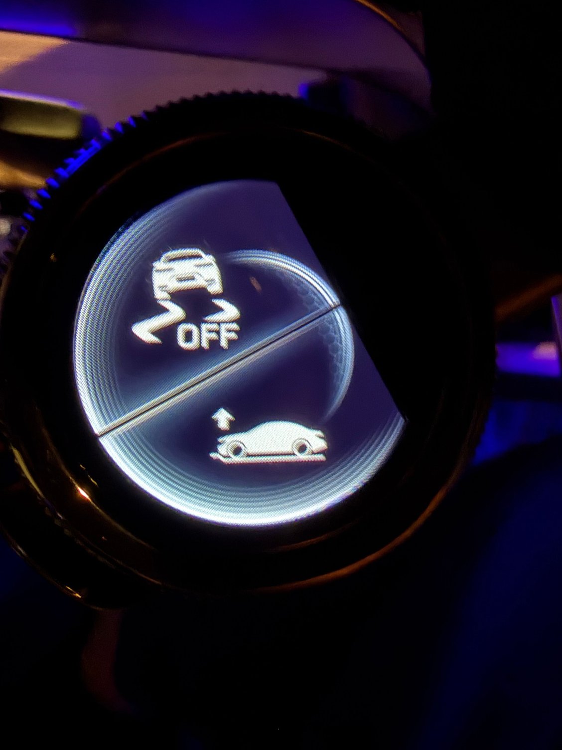

This is what the front axle lift icon looks like:
