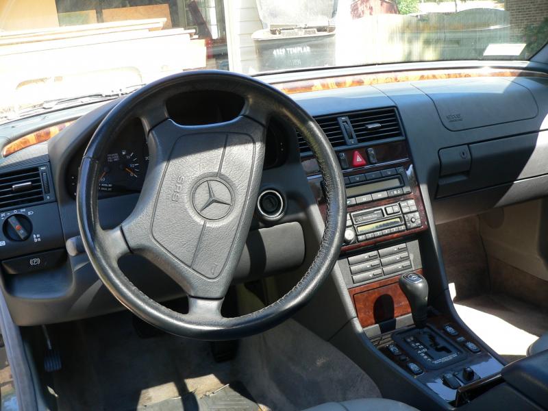

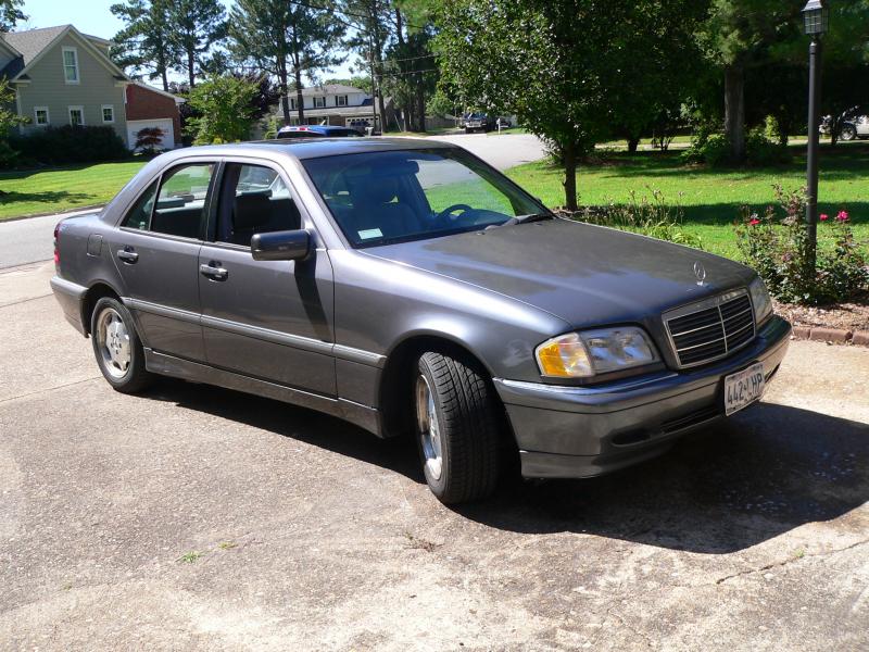

Finally found a Benz that needed some love. Its a '98 C230 and it was owned by an older lady who never drove it for the last 8 years so it only has 68K on the clock. She passed recently and her sons sold off the car as part of the estate. Mechanically the car is fairly solid. Engine runs fine, transmission shifts well and is smooth. Front end is tight and the car tracks straight on the highway and does not wander. Had it up to 85 on the ride home and it seemed to like it. The car had 4 new Yokohama tires and a new battery so that is all good. Now for the bad.
The car was very dirty on the inside and has several spots where the vinyl on the doors was nicked or cut. Probably not much I can do about that. Looked like there was a coke spilled and never cleaned up and there were tons of petrified french fries
under the seats along with several dollars worth of coinage and old pens and kids toys. I've made some headway on cleaning the carpets and have gotten most of the soda stain up. Probably going to have to remove the front seats so that is my first question, how do they come out? It has one power seat and one non-power.
Along with the trashed carpet, the headliner is destroyed. To add insult to injury, they tried to hold it up by stapling it in the middle and used duct tape by the back window. So I am in the process of trying to remove the residue from the tape without damaging the heating wires in the glass. Slow going there. But this all leads me to my second question, and that is how do I get the headliner board out so I can scrape off what is left and recover it? It looks like I have to remove all the trim around the edges as well as the light fixtures. Has anybody done this before and documented it? I've found lots of info on laying down the new fabric, but nothing about how the trim on the edges comes out.
Of course the car had a few other issues. The front seat belt buckle didn't work, it had some "paper" in it. Turns out it was a plastic part that was out of place. I managed to open it up, but the thing is beyond help. Ended up ordering a replacement from the local dealer, 130 bucks. Found it online, but with shipping it would be around 118 or so and who knows how long it will take to get here. The tail lights were not working either, so I start to get into them and pulled the assembly that holds all the sockets and noticed that some of the sockets were falling apart. On the outside of the lights, there was a dimple of sorts on both sides that I gather happened from overheating of the plastic with too large a bulb. Ended up ordering some replacement tail lights off an ebay vendor for 68 bucks shipped. Hopefully they will be decent or at least serviceable. And the radio was kerput. Not loosing sleep there, it was only a cassette job so I've ordered an Alpine cdt133bt that has Bluetooth installed. Got to have that for sure.
So what did this diamond in the rough cost? An even 4 grand. Not the best price but certainly not the worst. Going to be my daily driver once I get through all the little problems. Appreciate any advice, especially on taking out the headliner and removing the front seats. Here are a few pix of the new ride:
