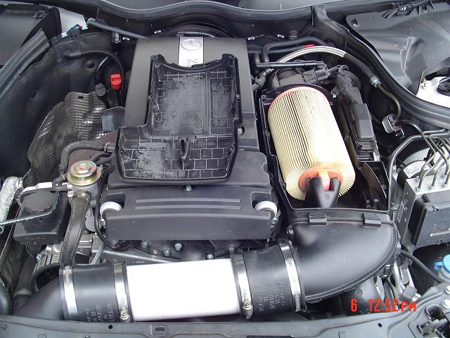

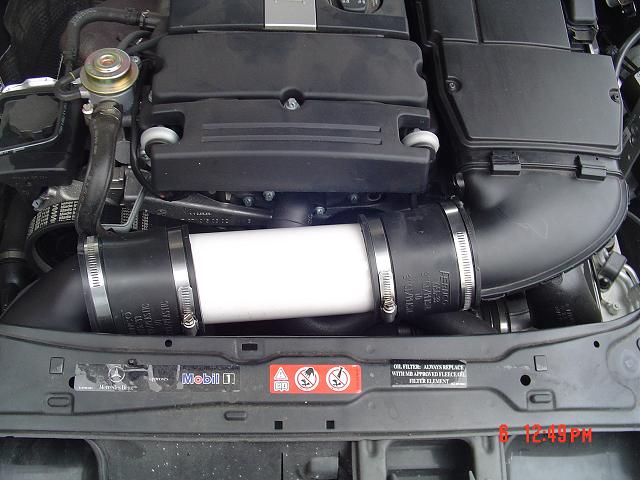

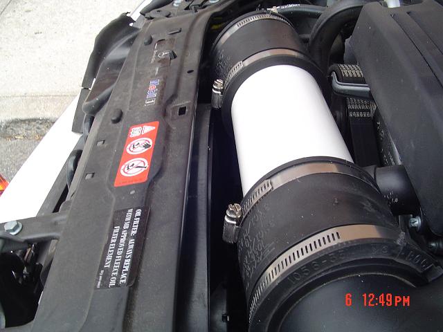

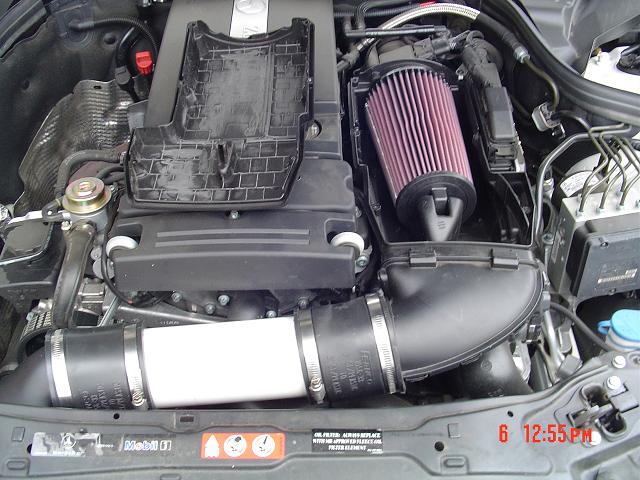

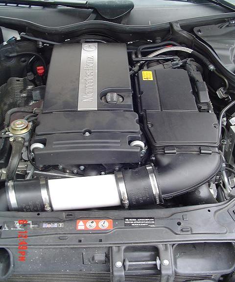

So after the huge Intake thread and many debates I finally replaced the stock cloth hose with a PVC pipe, took out the baffles in the airbox and put in the K&N Filter. The Results? Minimal, which was sort of expected. There is a sound difference a sort of whoosh and more noticable SC whine, the engine sounds a little raspier. The difference is more noticable past 40 MPH and best at about 60, my guess is proving that the PVC pipe has a sort of short ram effect. Im still brainstorming on how to efficiently connect that second intake scoop, or just rob that big *** scoop from my friends Subaru STI, that would be cool too, I was thinking maybe connecting the box directly to the scoop thats closer but that would take a little more cutting. The project was very simple and didnt take too long. I have ALOT of left over PVC pipe if anybody in the NYC area wants, Home Depot made me buy the whole damn 10 foot pipe just to get a small piece. So far Ive put about 35 miles on the car with this new set up. I really dont know how much of the changes are just in my head, but it seems like a harmless thing, and it doesnt look AS ghetto as I thought. Im going to get some real nice looking clamps made for those ricers soon as i man up to spend 50 bucks on just those, and any idea where i can get couplers made for a car and not drainage?

What was the total on those parts? And exactly which parts? (just throw up a picture of the receipt). Really doesn't look bad at all, congratulations. On our next dyno session we might as well try it and give you guys real numbers :\ - yes, we'll even try w/ and without the K&N probably.

2-3" to 3" couplers and a 3" PVC Pipe, all in the plumbing section, total came to 26 dollars and change, the 3" couplers needed a few slices in the sides because they just barely dont fit around the plastic parts of the air hose. The cloth hose I simply cut off with a serated knife.
I will answer any questions I can so ask away.

PVC can melt and actually burn at relatively low temperatures. Not sure it's something I'd want next to my hot engine. PET would be better, but I still don't think I would do that.
I drove it hard last nite redlining and to 60, and then at 65-70 for 22 miles back from my friends house. So far so good, Ive been checkin up on it everytime I stop. I was thinking of heatwrapping it, maybe thatll help prevent those unwanted effects.
Heatwrapping would help.
After doing some searches, I have found that others have succeeded using PVC as you have without issue, so maybe I'm being a little too cautious. :p

maybe this has been covered before but i have an M111, why didnt you take out the whole box where the K&N is now and make a longer wider custom pipe with a K&N on the end? I'm going to be making my own custom intake too so I'm trying to make it most efficient by utilizing stock air inlet etc. I removed my air box and put a filter there in its place without a tube and I noticed a difference from just that in sound and response, my hood wouldnt close all the way so I need the piping

Just a tip if anyone else decides to do this. Go to a marine supply store and by 3" diameter silicon exhuast pipe. It will accomplish the same thing at a slightly raised price, but will only require 2 hose clamps and the hose comes in black, red, or blue and abviously handles heat well, as well as being a decent insulator.
And also if you can, boil a pot of water and stick the ends of the hose in there to soften it up and to expand it a little, it should go on easier.

Because you would be turning a well tuned COLD air intake into a HOT air intake. The stock M271 setup is really good - these are just minor improvements on an already good design.
Note: if your Home Depot sells "ABS" sewer pipe that would be optimal. Its the same dimentions as the PVC but insulates a lot better. It is what most of the plastic under your hood is made of - so its definately safe. Bonus - it comes black so you don't have to paint it.

Wait.... you guys don't have both intakes connected with hoses? I guess this is something new they did on the 06 engines....
