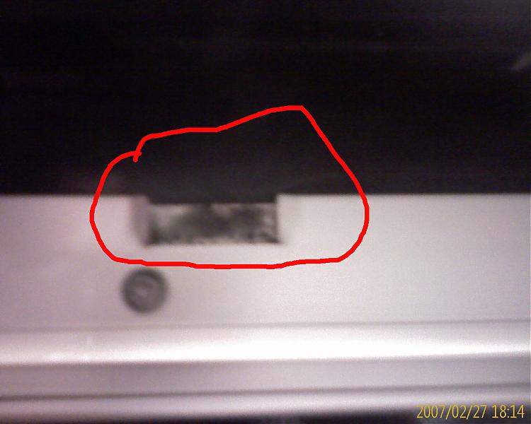

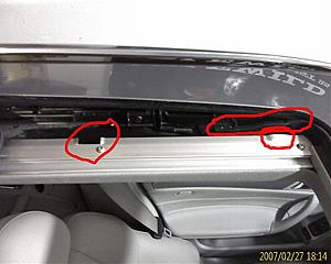

ok i figured out the exact spots to put the oil/lubricant. I did as Russel Stevens said and cleaned the rail and oiled it. but there are exact crucial spots. on the c230 06. when you are looking at the rail down. there is a rectangular notch where teh sunroof goes back. be sure to put lubricant inside the rectangle (both sides). Also, the sunroof was kicking back near the front where it closes. on both sides there is a contact that pushes down the wind deflector thing near the front. make sure to put lubricant here as well and life will be good. i may take a picture and do some diagramming if anyone needs it.

Old Mar 2, 2007 | 01:49 AM
Sanny's Avatar
Joined: Aug 2004
Posts: 178
From: Garden Grove, CA
06 Granite Grey c230
Originally Posted by flush
i'll ask - take pics!
im watching back to the future 2. 8 more years and our w203's will be flying! i guess it will be w207 by then.
i wish there was a way to turn down the sensitivity of the sensor that detects resistance because that is what causing us the problems with the sunroof.
Attached Thumbnails Sunroof maintenance-image_035.jpg   Sunroof maintenance-image_036.jpg   Sunroof maintenance-image_037.jpg   Sunroof maintenance-image_038.jpg   Sunroof maintenance-image_039.jpg
