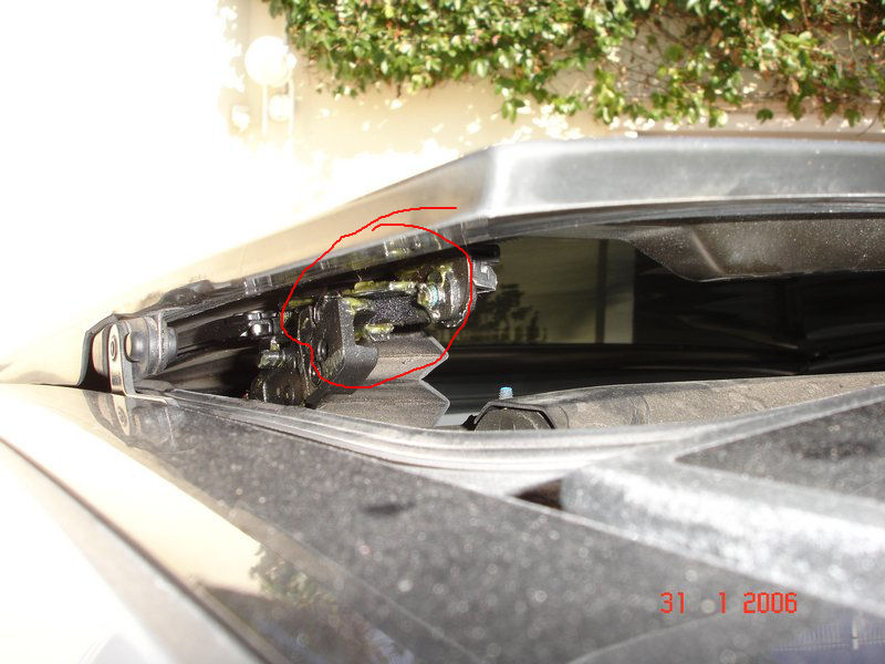

Pano-roof noises elimination
Today I went to my dealer to see if he could eliminate some noises in my pano-roof at the moment (I have the experience by other times that all the pano-roof is dismantled) because I had some anoing noises sounding like some mouse :p all the time, even touching the roof glass it made that sound!!!
I was not expecting resolving the problem at that moment, but I went directly to the paint section and talked to the guy responsable of that section, luckely I knew him from other time I was there. He called some guy that brougth some lubrification spray from MB and he was spraying to some of the pano parts till he find the problematic point (pic 1 and 2) and he also told me that part in pic 3 some times also need some lubrification.
And finally some silicon lube on the sliding part of the deflector (pic 4)
Not all the noises where eliminated (when the chassis flex it could make some noises, but not the same, but to solve this only dismantling all the roof and lubrificating all the parts and mount with the correct torq numbers everything up again.
Hope this could help for some future questions
Attached Thumbnails CL203 Coupe Pano-roof Maintenance - MB lube Grease Part #s, gears, & fixes-dsc02848.jpg   CL203 Coupe Pano-roof Maintenance - MB lube Grease Part #s, gears, & fixes-dsc02845.jpg   CL203 Coupe Pano-roof Maintenance - MB lube Grease Part #s, gears, & fixes-dsc02843.jpg   CL203 Coupe Pano-roof Maintenance - MB lube Grease Part #s, gears, & fixes-dsc02849.jpg

The areas he lubed are all related to noises while the roof is transitioning from closed to open, or areas inbetween. The other noises that the roof is famous for, can't be lubed away.
If I get some noise when its closed, I usually just tap the button slightly, it relieves a little pressure on the roof(roof is still very much closed and air/water tight), and the noise goes away completely. The motor is probably pulling the glass in to tight, collapsing the seal gasket and creating a situation in which other components can vibrate against the roof panel.
