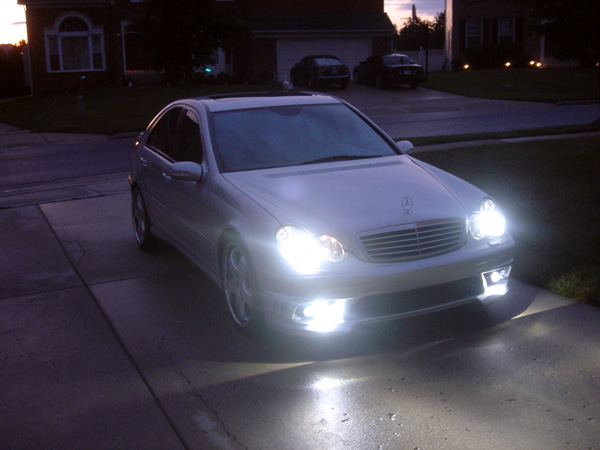

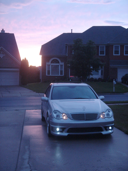

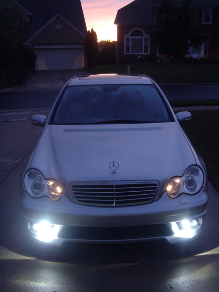

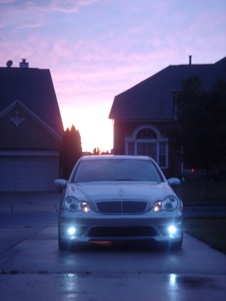

I finally got a chance to wire everything up. The HI LED fogs are not as bright as I thought they would be but they look good and match the xenons. The 6000k HIDs are super bright and a clean bluish white.
Just ordered my LED city lights... should have those in next week.
bi-xenon, 6000k xenon fogs & High Intensity LED fogs

looks nice...
is the resistor built-in?

It looks nice, but I would have wired the fogs the opposite way... with HID's on the outside and LED's on the inside so the intensity matches your bi-x. Also, it will look better if you put LED's in your city lights to match the color.

The High Intensity LEDs are from Hong Kong. Bought them on ebay (H3). Definitely just for looks. I use them as extra city lights. Here's the link to the guys ebay store: http://stores.ebay.com/warden-jp2002 (item was received in 7 days from HK)
Resistors not built-in, I left the original 194 wedge bulbs wired up. Tapped into the wiring and hooked them up. No computer errors.
I may swap the lighting to see how it looks with the 6000k on the outside, pretty easy to do.
bensitto, I pm'd you, but just saw this post now.
Let me see if I understand your wiring schematic correctly
- You left the 194 wedge bulbs in, covered them up with electrical tape (I'm assuming) and used those wires to power the outside fogs
- Inside fogs, you wired directly (or tapped in new connectors) from the OEM foglights.
Questions I have:
1) Do the outside fogs come on when you just have the parking lights on?
- In other words, are the outside fogs actually acting as your parking lights now.
2) (If the inside fogs are wired with the OEM foglight wires) When you have your lights set to auto and you're first exiting the car, do all 4 foglights stay on along with the parking lights? (i.e. convenience lighting)
I want to be ready for the pre-wire after everything has been completed, so I'm gathering up all possibilties. Thanks in advance for any input.
drex

Yes the fogs come on when it's dark and I unlock my car. (convenience lighting) Not when it's bright outside though...
And yes, the bumper lights wiring is going to the LED fogs so those come anytime any lighting is activated.
