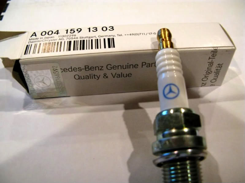

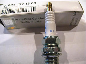

One would like to believe a competent MBUSA counterman could furnish the correct replacement parts.
Nevertheless, MB’s rebranded and repackaged plugs typically have the manufacturer’s PN embossed on their shell.
Post that information and I’ll verify you’ve received proper plugs.
The M112 calls for a 14mm thread, 19mm (3/4") reach, 5/8" hex, gasket seat resistor plug.
Heat range differs depending upon application (e.g., supercharged).
M113 Kompressor/M271 shown
On the plug itself in the white area it reads: KC10PYPB4
On the silver rim just above the threads: OF 073
The Box reads:
A 004 159 50 03 64
Maid in USA 15415227 14.09.10
Thanks for any help Splinter, it's much appreciated.
