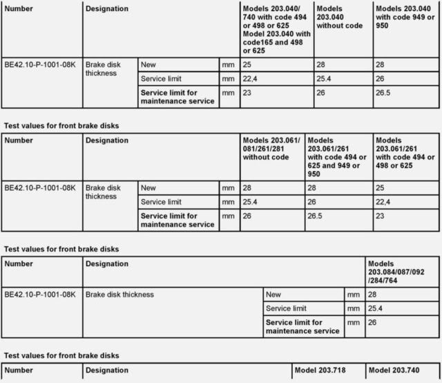

This change rotors with every pad set is an American thing. MBSA & Germany say change discs (rotors) when they have reached minimum specified thickness. I know people that are on their 4th set of OE pads on the same rotors on the W203.

i agree- i always mic them to see if they are within spec (this car as well as others i own and have worked on) and go from there. if there is no vibration in the pedal- i don't even have the rotors turned/cut. it's a waste of money and materials to replace rotors every time the pads need to be changed.
