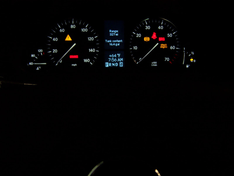

Mine has always shown distance till empty (Range). Sunil programmed "tank content" for me. See this pic: Top line was there from the factory bottom line added via STAR.
Wow thanks for the pic John.
Mine just says Distance. Do you recall how this was done?

Hell Ya....I did it!!!!!
Before:
Process: (notice those 2 "tankinfo" have to be activated" then you must go in actuations and "ECU Reset" all done in Developer Mode)
After:
Sorry for the crap quality cell phone pics
Summary:
ICM> Developer Mode> Variant Coding> Variant Coderung> Change to avtivate> Actuations> ECU Reset (always have to reset in developer mode while in regular reset is done automatically)

You can see before it said my miles left were 98. After it says my miles left are 169. I believe this is because it checks your actual miles per gallon. Since I did a reset it probably went back to normal instead of my heavy foot driving
